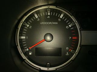

When car on P & N mode, step on the pedal and car engine cannot revo more than 3000RPM. [FLX]
Don't worry, is actually normal for Proton CVT, same goes to Preve and Exora Bold.

Engine Revolutions Per Minute (RPM) for Saga.
Saga FLX 1.3 CVT
2000RPM - 80 ~ 90 KMH
3000RPM - 120 ~130 KMH
4000RPM - 150 ~ 160 KMH

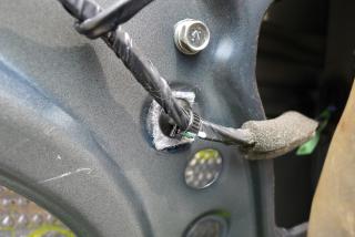

So, erictioh I have removed the VS and getting ready to send it back to you. Voltage from
to

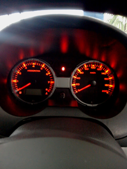

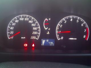

Wow! Nice! nod.gif how to do that ya? Haha..changing the small lcd?? hmm.gif
Great job!! Very Well done!!

1. Dismantle everything until u take out the LCD from the panel.
2. Peel off the original polarizing film from the LCD.
3. Clean the remained glue on the LCD.
4. Prepare a fresh polarizing film and put it reversely (until you see background become dark)
For 2 and 3, these are extremely dangerous and you have to brave anuf and experience to do that. Any wrong you will have to buy a whole new meter just because of the LCD.
For 4, mostly impossible you can find a fresh polarizing film, i took it from my spoil 10 years old digital diary and cut it to fit. Anyway, no need to glue the new film, just put underneath the LCD will do.

Hi Bro...
Warning!!
Pls do NOT attempt 2do the above...

Not really hard work for me, whole process use less than an hour, as i did couple of times for my digital watches last time tongue.gif Just that some LCD is fragile some LCD is tough, if LCD is fragile it will crack easily if applied force is uneven during film peel off. Luckily this gaga LCD is thick enuf, so i no need too worry for that.

QUOTE(coolkwc @ Sep 16 2013, 07:13 PM)
Wah... looks like Mybi rclxms.gif Resell value +500%
QUOTE(Mahihi @ Sep 16 2013, 09:34 PM)
Not exactly. It's more focus, but it doesn't lumi the rest of my headlamp casing unsure.gif

Technical Question:
Regarding CVT variants, usually ~2k rpm is normal driving. . no issue. .
>= 3k rpm, CVT comes alive, start to roar. .
~4k rpm, that is when bloody CVT starts screaming ?
upon 4k rpm, can see rpm suddenly shoot down to 5k rpm very fast. .
is it because of CamTakPro max. generated torque is @ 4k rpm ?
if yes, should answer why some complain when WOT CVT until 6k rpm like got 2 stage in between. .
1st stage is 1-3k rpm,
2nd stage is after 4k where the CVT starts scream and ur body starts to move back

According to mat79, before 1.6k RPM the CVT is in torque retention mode, as in it is limiting the torque to the wheels for low speed manuevers such as that in parking lot. Between 1.6k RPM and 2k RPM is some sort of "eco" mode. Beyond 2k RPM the CVT adopts an aggressive strategy and that is when you vroom vroom.
This is why if you wanna save fuel you should keep the RPM under 2k RPM.
Yes, max torque at 4k RPM.
at 4k-5k RPM, 2 things happen: a)your engine has reach max torque and b)the IAFM switches from the short runners to the long runners. when you reach 4K RPM you will feel a bit of kick and suddenly can quickly rev to 5k-6k RPM.
My observation is limited to the FLX SE with CVT.
mat79 correct me ayam wrong

explanation on situation is correct and accurate with my SE with CVT also. .
~4k, there is a small "momentum kick" that will push me backwards. .

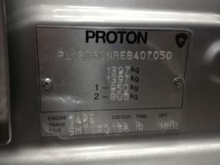

QUOTE(drfeelgood @ Sep 16 2013, 05:58 PM)
nice.  where is the restaurant?
various parts of Ipoh and Chemor
QUOTE(davidke20 @ Sep 16 2013, 06:00 PM)
by registration, then yes.
mine is fully assembled on 16th August 2011

yala. . see how the bloody rpm suddenly shoot down to 5k upon ~4k notworthy.gif

post Sep 17 2013, 03:26 AM
Joined: Dec 2012
QUOTE(coolkwc @ Sep 16 2013, 09:28 PM)
Nice work bro, i just change the colour of the LED only.... i want to do this, just the font got light, background are dark, but dunno how to do it, haha
So actually it just need to put the polarizing film reversely, you change the polarizing film because stock one got glue already?

Basically, Plotong's CVT uses the same function of having less engine speed to drive the car, hence revving speed between 2~3krpm are normal sprint. If you go WOT, the drive pulley will widen to allow more engine speed(more torque) to be channel out, hence you see 4krpm. Until reaches certain speed where the driven pulley(output) has been fully shrunk, then the drive pulley(receive power from engine) will start to shrink.
The shoot up from 5~6krpm is a bottleneck of CVT. There's no more step(variable) available for the driven pulley(output). Continue from the previous paragraph, the driven pulley already maxed out, there's no more room to go faster. Now the drive pulley will start to shrink. Hence from 5krpm onwards, EACH RPM increment will result in your optimal top speed. Meaning to say, when you're on 5krpm, it's equivalent to 6speed top gear when you're doing SAT mode.

QUOTE(haur516 @ Sep 17 2013, 03:26 AM)
Yes. Once you feel off, the polarizing film can't be reused anymore (like you peel off the tape), you have to get a fresh one.

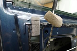

Curiously why ppl still buying MT since such low cost car also offering CVT...
Me as a MT BLM user always jealous FLX CVT, seriously...
Campro = noisy engine
MT = short ratio
MT + Campro = high rev + noisy engine drone doh.gif put a dozen of SP material just becos of this...

QUOTE(garybenjamin @ Sep 17 2013, 09:42 AM)
Sorry, today i confirmed 100 @ 3k rpm, 110 roughly 3.2k rpm 5th gear ....
i think this is the accurate one..mosty i drive trunk road maintain 90-110..highest rpm if cruising 110kmh is about 3.3k rpm...

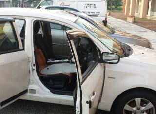

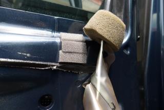

my diy last saturday
the rattling occurrence is less now, but it's still there
still don't know how to solve the aircond vent and dashboard rattling
This post has been edited by blau-saga: Sep 17 2013, 08:35 PM
Keep it going...
i heard someone here also open the door trim almost 40+ times
still cannot fully solve the rattling issues
i think it can still be improved

Yup, Bro...noises are kinda hard 2eliminate...
Me hv been lucky cos no probs except 4abit vibrating noise (rattling?) @driver's door.
Found caused by push-down knob lever rod...
Hv yu tried tightening all screws/bolts found on doors, as well as in & arnd the car?
Me did that after taking delivery of car...found a no. of loose ones.... rolleyes.gif
NB. Pls do NOT overtighten tho...
Best wishes & Good Hunting...

my problem mostly on passenger side front and rear, near the push knob
and rear sounds like nyet nyet when moving from stand still and especially when driving under hot sun
i suspect the rubber not tight enough, but not sure which area to treat

3,735 posts
Joined: Nov 2012
QUOTE(Physxzc @ Sep 16 2013, 11:09 PM)
My SV at 3.2krpm...abit loud and high rev ...110 @ 3.6K
oops my bad.
2750 rpm is around 90 km/h
3000 rpm is around 100 km/h
4000 rpm is around 133 km/h.

QUOTE(dares @ Sep 17 2013, 01:04 AM)
drfeelgood dapat 2.7k RPM
gaybenjamin dapat 3k RPM
Physxzc dapat 3.2k RPM
mcm beli toto
sorry edited.
I think the s v needs higher rpm due to size of tires. 13 inches vs 14 inches on the FLX.

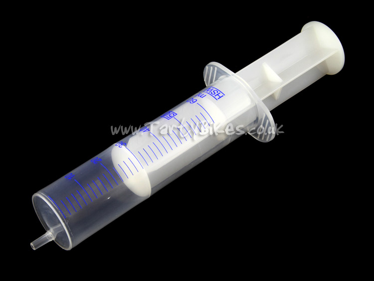

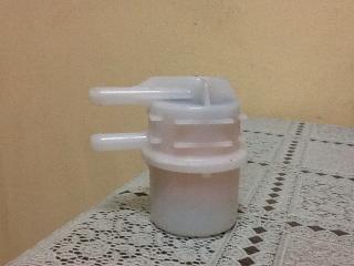

A scheduled DIY maintenance item...
This post has been edited by zeone: Sep 18 2013, 08:15 AM

QUOTE(drfeelgood @ Sep 17 2013, 11:45 PM)
sorry edited.
Not valid, as the meter shown is exactly same no matter you use 13 inches or 20 inches, because the speed and RPM shown is counted based on engine rev and gear ratio. The real difference only reflected on real speed, but not meter reading. Furthermore circumference of 13 inches VS 14 inches rim is just 0.4% different.
So the only answer for this is SV might use old MT GB used in BLM/FL. Anyway, he can always check it out at the plate located bottom of the B pillar (driver side) which GB is used. Code name i forgot adi.

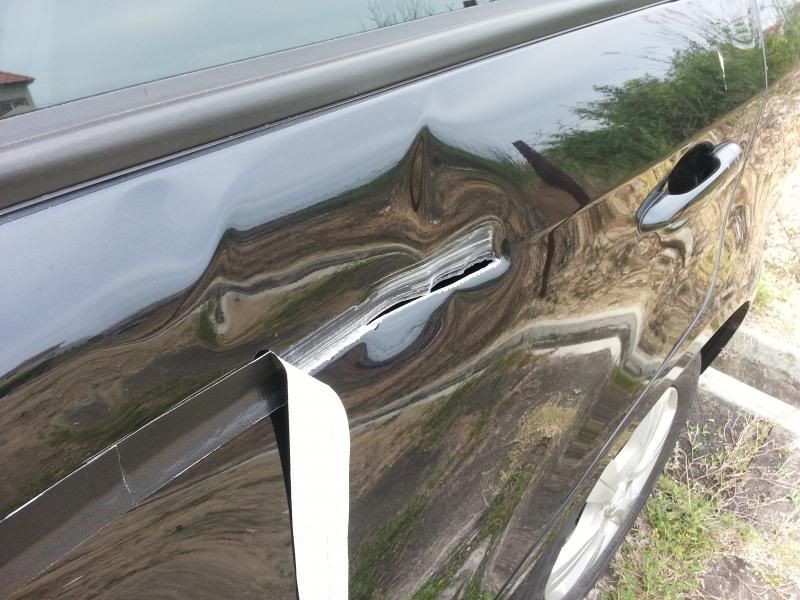

Hi guys...how's everyone?
Firstly. quite bad for me. my Saga was broken in just for a few coins. The thieves broke my drivers side Window. damn them to hell.
luckily I have windscreen coverage. my insurer covers all windows.
got it replaced and going to claim.
Attached Image Attached Image

QUOTE(drfeelgood @ Sep 18 2013, 09:21 AM)
Feel sorry to you. Any thing lost?

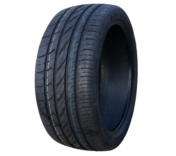

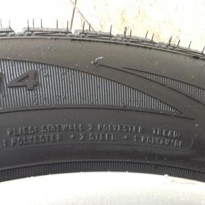

QUOTE(coolkwc @ Sep 18 2013, 08:19 AM)
it is true that the size of the tire affects the speeds of the car.
look up tire size comparison on Google.
simply put a bigger tire turns a bigger revolution as compared to a smaller tire in the same engine speed.

QUOTE(coolkwc @ Sep 18 2013, 09:30 AM)
they took some coins and my jump start cable from my boot. they also ransacked my car glove compartment but there is nothing there of any value.

QUOTE(drfeelgood @ Sep 18 2013, 09:34 AM)
Yes, size of the tire affect the speed, but NOT THE READING FROM THE METER PANEL. Your meter panel only show what it calculated from engine, not from tyre actual speed, so it is fixed.
You only can know your actual speed when you read from GPS.

QUOTE(adriangan @ Sep 18 2013, 06:55 PM)
They use the leftovers from BLM? hmmm...
Go read your car owner's manual, in the car transmission specification there, look for the gear ratio of your gearbox.
If ur is old gearbox, the ratio should be as below:
1st 3.333
2nd 1.954
3rd 1.285
4th 0.926
5th 0.755
Final 4.705
After that open your driver side door, look at the bottom of B-pillar (center pillar), there is a silver plate that printed with vehicle load and some other information, if you find a word 'MFA30A', confirm this is achi pokai gearbox from old BLM/FL. rclxub.gif
Anyway, curious to know your manual SV speedometer is BLM/FL type or FLX one???

QUOTE(adriangan @ Sep 18 2013, 11:08 PM)
BlM meter, seat also blm. Tmr I go and check manual
also post here the gearbox code from B pillar (driver side door)
Achipokai GB 9k++
Getrag GB 4k++

Hoho, so manual SV using BLM meter is not a rumours...so gearbox is Achi Pokai is no surprise at all...
So additional for SV manual spec
- Old BLM/FL meter
- Close ratio Achi Pokai GB
Looks like Proton is doing a f***ing job for SV...i doubt manual SV using IAFM+ or old IAFM...
