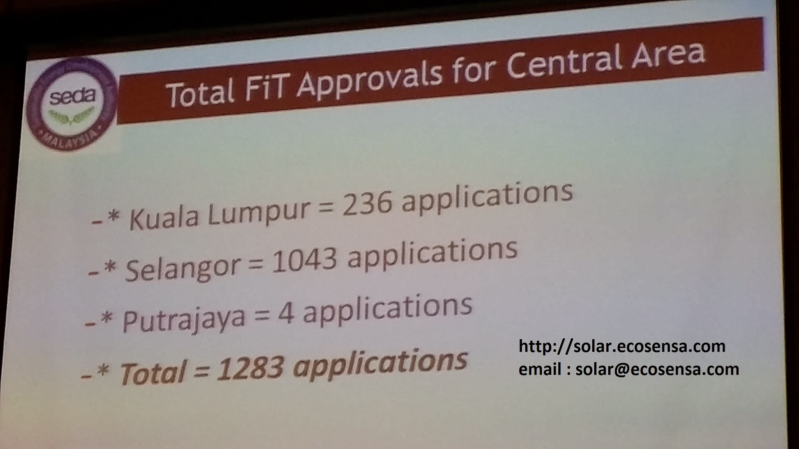

yorkhan
post Jan 11 2013, 10:15 AM
598 posts
Joined: Nov 2006
http://seda.gov.my/go-home.php?omaneg=0001...000000000&s=140
Why so many in KLIA? What are they supplying?
I am actually very interested in this Solar PV, however the cost and redtape is high. I have a friend working in a company that will deal with all paperwork and installation. Its just sad that Malaysia is like this.

TSlocke
post Feb 26 2013, 06:08 PM
156 posts
Solar PV FIT updates from 26th Feb briefing with SEDA at UNITEN:
For Individual applications:
- Maximum capacity per application: 12 kWp
- Maximum Feed In Application (FiA): 2 applications per individual
- Maximum total capacity per individual: 24 kWp
- Application charge: RM10 per kWp and minimum RM100
- Processing charge: RM100 (online), RM200 (manual)
- FiA Transfer charge: RM1000 ( sell property etc)
- FiA Transfer charge: RM200 (pass away)
- Feed in Applicant(FiA) and property owner can be different person (parents, siblings, children and etc)
For Company applications:
- Maximum capacity per company: 30 MWp
- Maximum capacity per individual in company: 5MWp
- Company need to declare shareholder until individual, PLC, GLC or foreign company
- Announced 20 MWp quota for Solar PV system < 500kWp announced for end of Mar 2013
- For capacity > 24kWP, regessesion rate changed from -8% yearly to -20% yearly starting 2013
- Company need to have paid up capital of 20k for <24kWp and 50k for >24kWp
For Community applications:
- Proposal for community application for house of worship, hall, etc and max capacity 24kWp
This post has been edited by locke: Feb 27 2013, 08:20 PM
avereng
post Feb 27 2013, 10:35 AM
232 posts
Joined: Dec 2010
QUOTE(locke @ Feb 26 2013, 06:08 PM)
- Maximum capaciy per individual in company: 5MWp

Attached Image This is from the secure page.
It shows the C02 avoidance and FiT reimbursement.

Guys,
There are only 2 more window of opportunity to get this year rate. If you interested, please drop an email to solar@ecosensa.com or PM me.
Check out http://solar.ecosensa.com
From SEDA website :
Putrajaya, Tuesday (27 August 2013): Sustainable Energy Development Authority Malaysia (SEDA Malaysia) during their Open Raya announces the release of 1,500kW of solar photovoltaic (PV) quota for the individuals in three batches. The first 500kW quota for individual under the Solar Home Rooftop Programme will be released on 28th August 2013 (Wednesday) followed by another 500kW on 4th September 2013 (Wednesday) and 11th September 2013 (Wednesday) at 12 noon.
According to Datin Badriyah Abdul Malek, Chief Executive Officer of SEDA Malaysia, “there will be no more release of any solar PV quota for the individuals for 2013 after 11th September because it is not realistic for these individual Feed-In Approvals Holders (FiAHs) to be able to achieve commercial operation of their PV system by year end”. Datin Badriyah added any renewable energy projects which are supposed to achieve commercial operation by this year and fails to do so will incur further degression to their Feed-In Tariff (FiT) rate as stipulated in their Feed-In Approval (FiA) certificate. It is thus important for all FiAHs to note for solar PV for the individuals, the degression rate is 8% whilst for the non-individuals, it is 20%.
Happy Investing! GREEN ENERGY, GREEN MONEY !

post Oct 17 2013, 06:15 PM
150 posts
Joined: Jul 2012
Hello all,
Happy to share this email with all who are interested :-)
study visits by prior appointment always welcome. pm me.
cheers from sunny Putrajaya,
arjunaidi
Attached Image Attached Image

Can i ask this rm637 is what duration? monthly? I think your installation is a 2.x kv.
QUOTE(arjunaidi @ Oct 17 2013, 06:15 PM)
Hello all,
arjunaidi
arjunaidi
post Oct 18 2013, 10:52 AM
150 posts
Joined: Jul 2012
Yes, mine is a 2.5kWp system. the payment was the first since T&C, so it was for 2 months' reading of the PV meter.

Update & Sharing : we are completing an installation in Setia Eco Park today . 8kwp rclxm9.gif

Hi Arjunaidi, I was there. Representing myself ( i am a FiAH ) and my customer also thumbup.gif
Some interesting info and statistic to share here >> http://solarmalaysiafit.blogspot.com/2013/...ral-region.html <<
For those that miss this event, summary of the dialog : "Choose your consultant and system integrator wisely".
Find the SI that you are "comfortable" with. Registered with SEDA. With inhouse ISPQ. With PW4 that attended SEDA training.
Dont be penny wise, pound foolish.
You go for cheap stuff. You get cheap stuff.
If you want more info, PM me. Free consultancy and info sharing. Glad to do that.
Those believe in this investment vehicle. You are advised to plan and prepare early and get ready.

Putrajaya 4 installations approved in 2013. Mine was the 4th :-)
Yes, i totally agree with kongkokking. Don't be penny wise and pound foolish. You want a system that's going to work for at least 21 years.
cheers,
