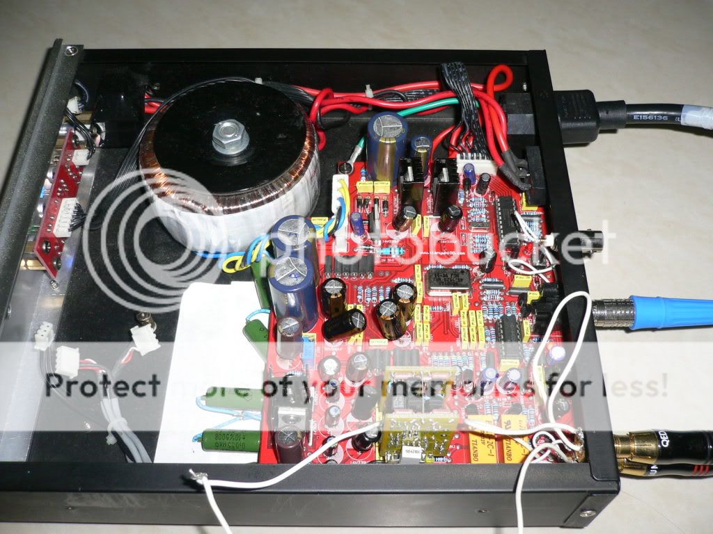

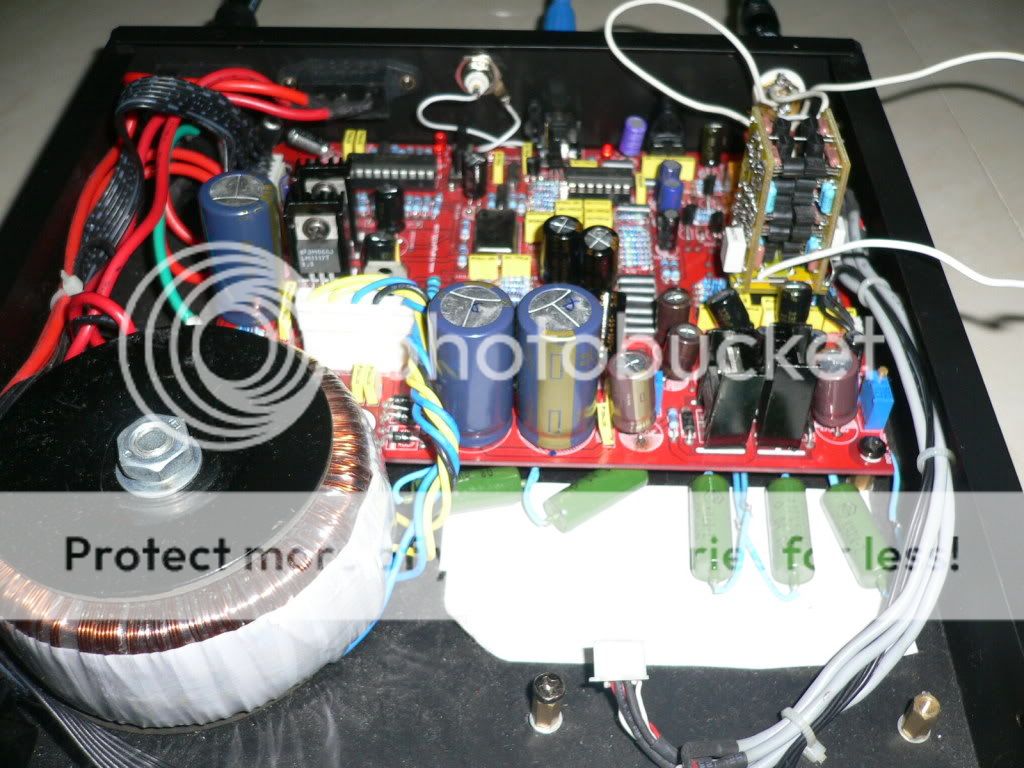

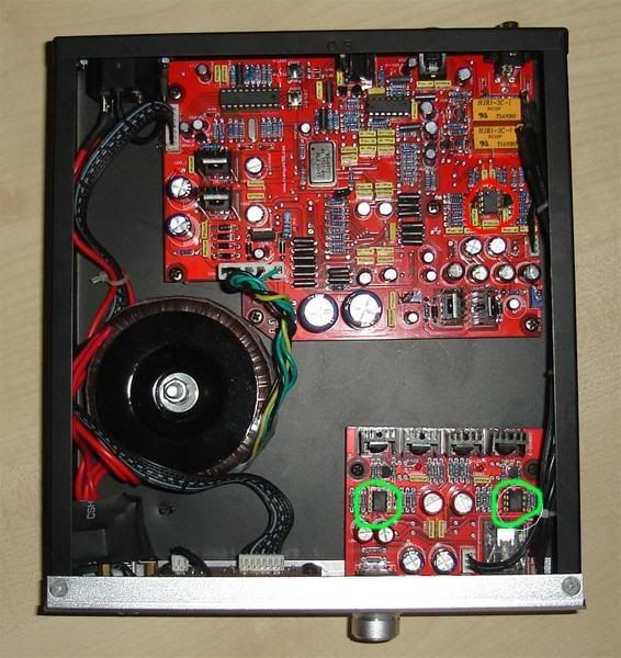

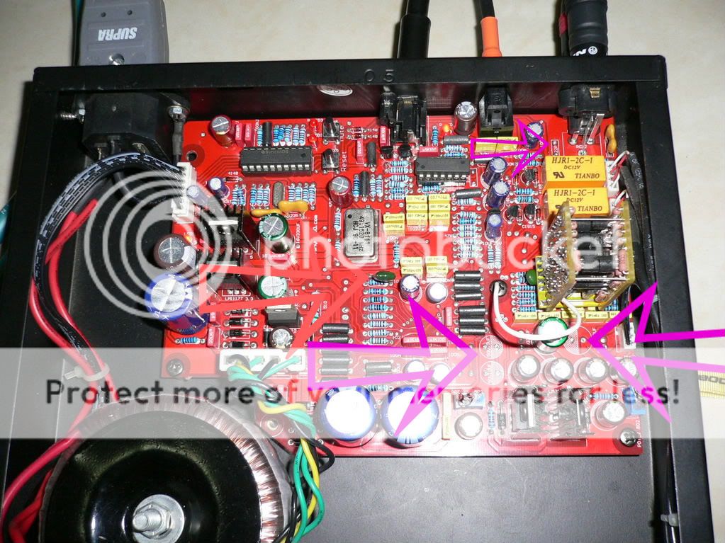

full topless view...
the DAC section
the next few pictures are for those who has a fetish for capacitors... so here u go biggrin.gif
(all the blue caps are of the same brand some kekekkekekeek brand laugh.gif )
AMP section
the opamp
the caps...which is written ELNA on it.

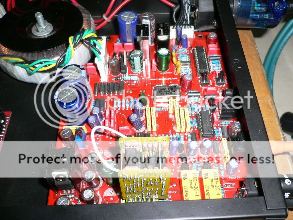

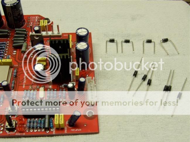

Major parts upgrade required lol, gogogogo, add in new Elna caps, MUR820 diodes, tantalum stability caps, extra decoupling and takamisawa relays!

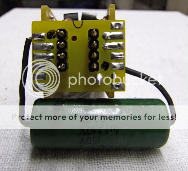

EDITED: For those who like to do opamp rolling, me and mADmAN could teach you how to get impressive FREE opamp lol
This post has been edited by GodLuvSxS: Jan 22 2008, 10:09 PM
mikelanding
post Jan 22 2008, 10:20 PM
2,865 posts
QUOTE(GodLuvSxS @ Jan 22 2008, 10:07 PM)
I leave my unit loan at mADmAN there, I'm not from W.Maju, but it's just that I may be frequent there maybe once in a month, cos I'm Ipoh lang tongue.gif
lai lai..teach me/ enlighten me.I need single channel opamp..tongue.gif...so far I rolled opa627...really like the detail and also the tight, deep bass. Not sure about other.

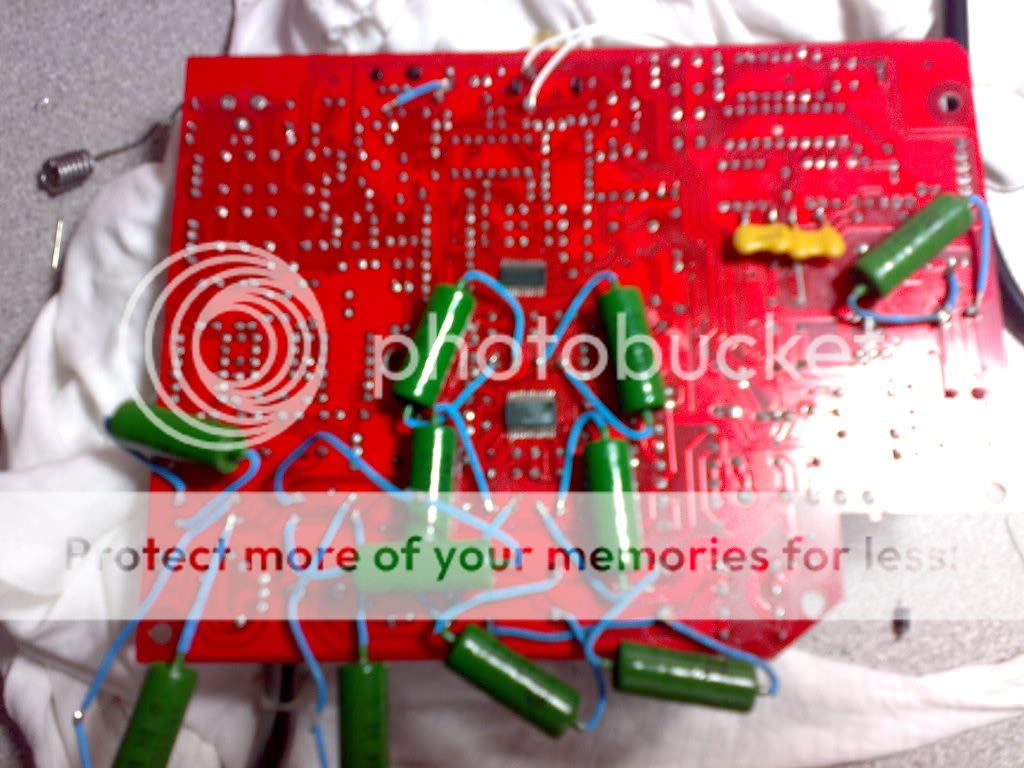

Added on January 23, 2008, 6:26 pmoh by the way....is it possible to mod this to be able to accept USB input????
This post has been edited by mADmAN: Jan 23 2008, 06:26 PM
GodLuvSxS
post Jan 23 2008, 07:11 PM
1,359 posts
From: Ipoh
QUOTE(mADmAN @ Jan 23 2008, 06:23 PM)
whoah....that doesnt leave me much time to gather the cash.....will see how it goes....currently the amp still doesnt belong to me so modding something that aint mine...aint nice laugh.gif
Very dooable, but this will take quite long as USB to I2S/SPDIF converters usually come in SSOP28 or MSOP28 which is hard to solder and very hard to make a board for. Alot of thus has to be ordered.
I'll ask TI if they have a free evaluation board.

shocking.gif very doable? damn....lemme know of the availability of the stuff and cost as well....

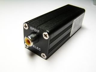

Hi, brothers and sisters, the ZERO dac bulk just need another two units to kick start the bulk, HURRY UP! Anyway, a big thank you for you guys, thanks for considering!

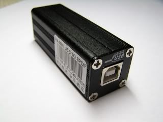

For those who are bothering about no SPDIF connection available from you computer, I may help you guys getting USB to SPDIF signal converter like below, so it works like getting signal from your USB port and through that device, after that the signal will be convert into SPDIF signal and send to the ZERO dac. TATTa ~~~ There your ZERO dac would start singing! And this useful little device would only cost you guys RM20.
mikelanding
post Jan 25 2008, 12:13 AM
2,865 posts
QUOTE(GodLuvSxS @ Jan 24 2008, 11:47 PM)
Wow..i want 1X USB to SPDIF signal converter...can help me get it??

QUOTE(mikelanding @ Jan 25 2008, 12:13 AM)
is it connect tis device by using mini to rca to the dac??
if u can manage to get this device, pls collecte order at bulk, if im not mistaken, i can point out at least 3 person who are looking for this tongue.gif

Nope, it connects your USB cable to this device and then convert the USB signal into SPDIF. So this is for those got DAC which accepts SPDIF digital input but unfortunately the computer got no SPDIF output.
QUOTE(yuheng @ Jan 25 2008, 08:22 AM)
QUOTE(SYAMiLLiON @ Jan 25 2008, 08:58 AM)
LOL I guess i gotta do one time FREE community service to help you guys get this but of course with the condition: I'm able to complete the ZERO dac bulk! So you guys please hurry up to grab your ZERO dac! cool2.gif

QUOTE(GodLuvSxS @ Jan 25 2008, 10:10 AM)
oh..forgot to ask. wat is the spdif output? optical only? or coax only or optical ony or both?

QUOTE(mikelanding @ Jan 25 2008, 04:22 PM)
QUOTE(scy320 @ Jan 25 2008, 09:16 PM)
yeah,any review on this device?
Emm .... so far none, just treat it as somekind of converter smile.gif For those who are interested with the converter please leave your name and quantity here, once the bulk is ready to kick start, I would start PM you guys smile.gif

Is this the browndog adapter you guys mentioning about? Normally how much does this thing cost? I need some reference to nego with the seller if that thing is browndog adapter smile.gif Seriously if those who are really serious about getting the best out of ZERO dac, should consider swap in OPA627 for the DAC section, 2 x OPA627 BP = USD22 plus another small fees for browndog adapter and perhaps some fees for DIY sifu to help u guys solder in, i  think the cost should be just around RM100 and you get one of the best sound biggrin.gif
LOL still no ppl confirm with me that the thingie inside the picture is browndog adapter?
mikelanding
post Feb 1 2008, 12:48 AM
2,865 posts
yes..it is a browndog adapter..But need to take note izzit socket or solder on...

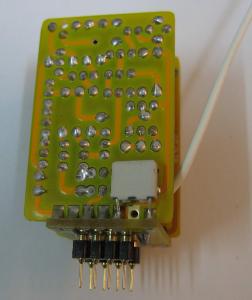

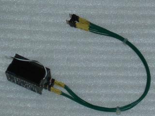

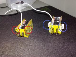

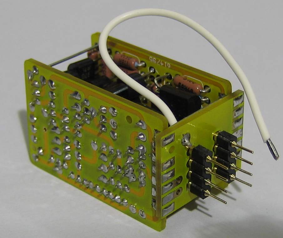

Is this the browndog adapter you guys talking about? Changing single op to dual op. I can get 5 for around RM10 if you guys want. There also the adapter to change SOIC to DIP.
mikelanding
post Feb 1 2008, 03:30 PM
2,865 posts
QUOTE(teNtiOn @ Feb 1 2008, 02:43 PM)
wow..that is cheap..but is only the pcb board rite?
Browndog adapter that i lookin for is like below:
A complete with socket (DIP)
Can u find it? and how much?
teNtiOn
post Feb 1 2008, 03:42 PM
683 posts
Joined: Sep 2004
Yup, that's only for the pcb board. The dip cost around RM1 for 1 unit and the pin around RM3 for 40 together. It's a little bit cheaper but lazy to do the conversion. It's selling separately so need to do some solder job. So should be around RM20 to get 5 set.

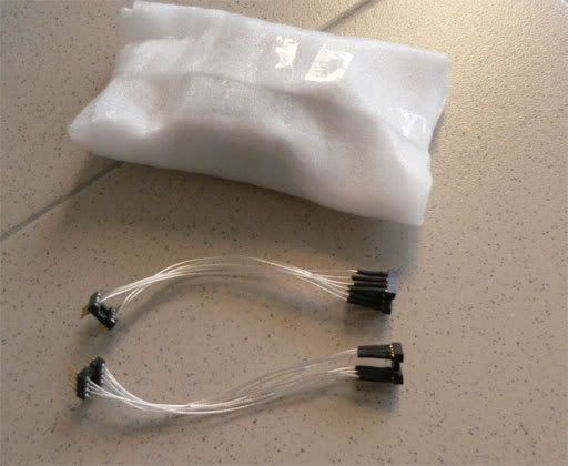

The part for Browndog adapter had arrived early. It was unexpected because seller use EMS instead of normal mail. Some extra charges incurred but it all settle out between me and tention bro...Kudos to him!! thumbup.gif
here some pichaa
For the OPA627AP, it already sent out before CNY...should be arrived sometime this week or next...smile.gif

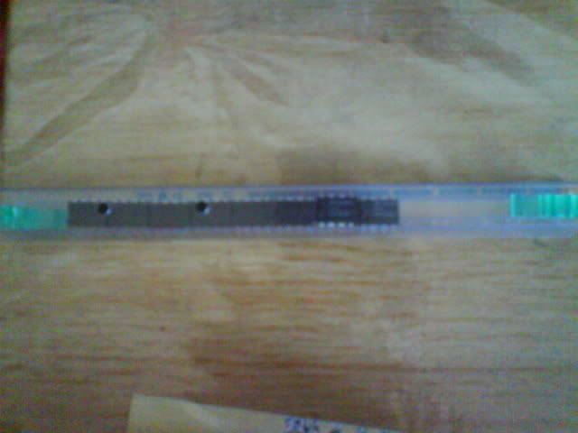

Good new!!!
The OPA627AP had arrived safely!!
Picture time!!!
I asked my friend to sent me more OPA627AP. So any1 who need can pst me. USD14 per piece + Rm6 poslaju fee.
I also got myself 4X OPA602AP. Just want to test out, compare to OPA627AP later...tongue.gif

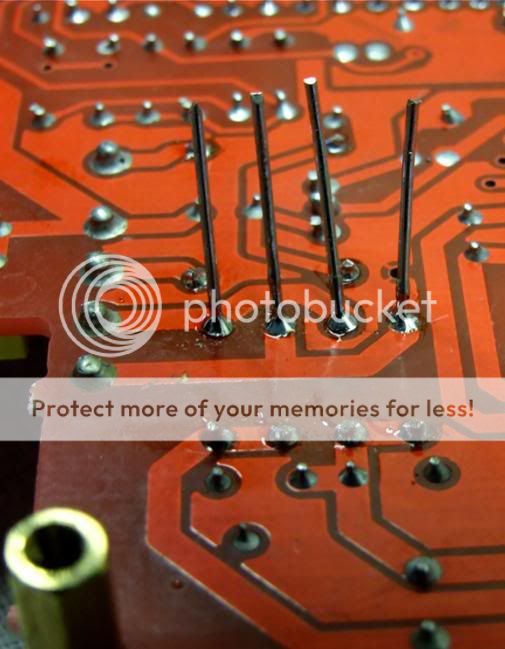

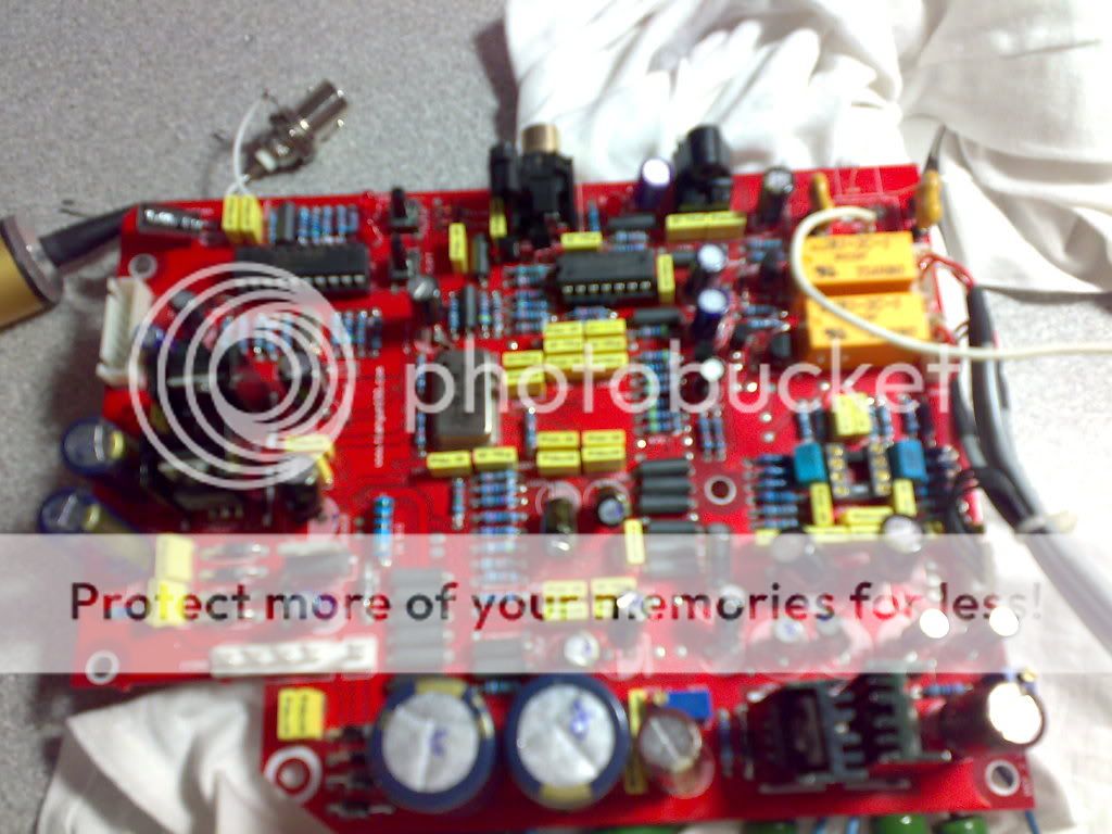

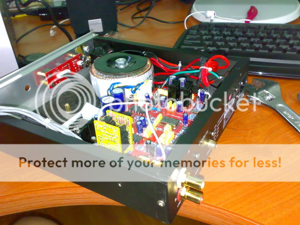

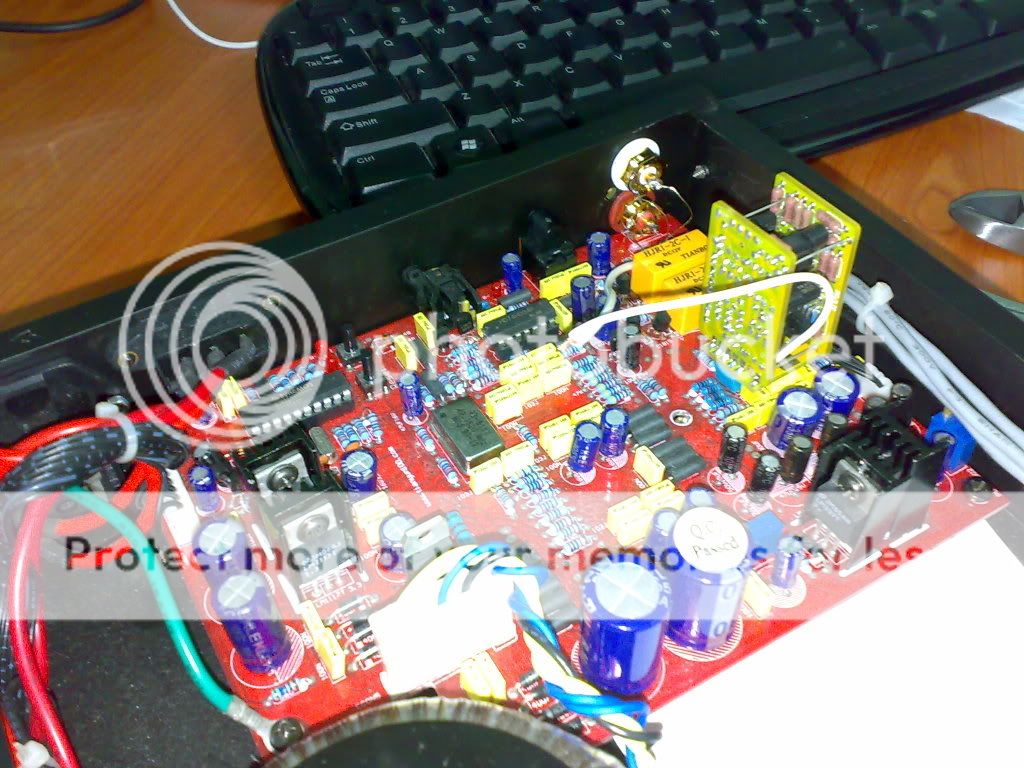

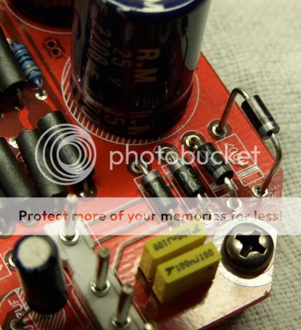

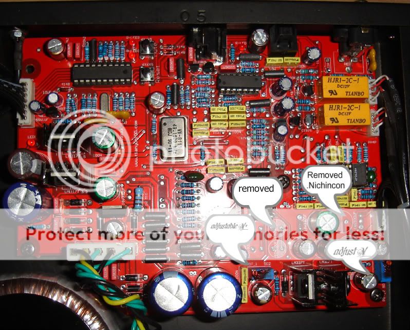

Currently modding the DAC.
Stuff done so far,
1) Some cap replacement
2) Diode bypassing with ceramics to whack switching noise (since the spacing isn't suited to the fatter MUR820s)
The only complaint so far i have is with the bad soldering and cheap PCB, the plated holes seem to lift and crack everytime you desolder them, not any different with my ZL or the YuLongs i've worked on, though i wish something China made would have a good PCB.

No...U need 1 unit of browndog adapter + 2 units of OPA627AP for 1 sockets. If u change all 3...u need to multuply by 3..which is QQ to me... tongue.gif

Some good new!!
All Browndog adapter had been make into final product!! Big thank to tenTion bro for his help.
But....the bad new is: 2 out of 10 unit had some problem during making. tenTion told me he might be able to fix it. If worst case scenario, I will fork out my 2 units to let other got their adapter. Err...this mean I got no adapter liao cry.gif cry.gif cry.gif
Anyway, I recieved some interest for this adapter. I might organise another non-profit bulk for this browndog adapter. But I need help from other kind soul who can help us make it into final product...smile.gif Any volunteers?? tongue.gif
I will post some photo on the browndog once I back home...Picture poison alway work!! laugh.gif laugh.gif

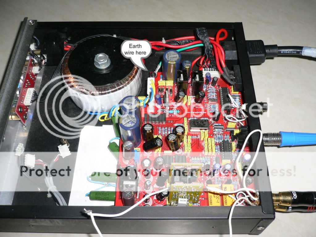

empy....post the mods u did pls
GodLuvSxS
post Feb 15 2008, 03:43 PM
1,359 posts
From: Ipoh
QUOTE(mADmAN @ Feb 15 2008, 02:41 PM)
wheeeeeeeeeeee

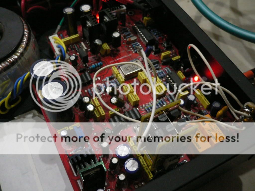

empire23
post Feb 16 2008, 12:55 AM
Team Island Hopper
Staff
9,417 posts
From: Bladin Point, Northern Territory
Here is mah list of short mods. Could have done more with my osci and mm, but i'm leaving on monday, so didn't have enough time.
1. Diode Bypass (reduce noise)
2. Stability and Noise killing mod for digital section (PS bypass replaced with Silver Mica)
3. Ground loop breaker mod (better caps)
4. More capacitance for the main analog stage, from 4400uF to 6600uF
5. More capacitance for the digital stage with Silmic II parallel, from 2000uF to 2330uF and bypass.
6. Cap replacement on analog output stage
7. Film cap replacement with german Wimas near the clock, DAC and supply lines.
This post has been edited by empire23: Feb 16 2008, 12:56 AM

mikelanding
post Feb 19 2008, 02:19 PM
2,865 posts

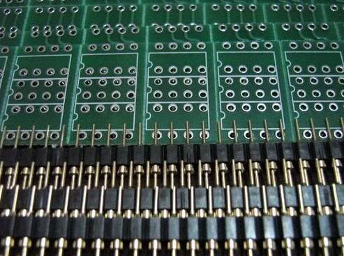

As pormised earlier. Some picture on the adapter. They still at Tention bro hand. Picture taken by tention
Bottom view..Nice pointin legs..hehe

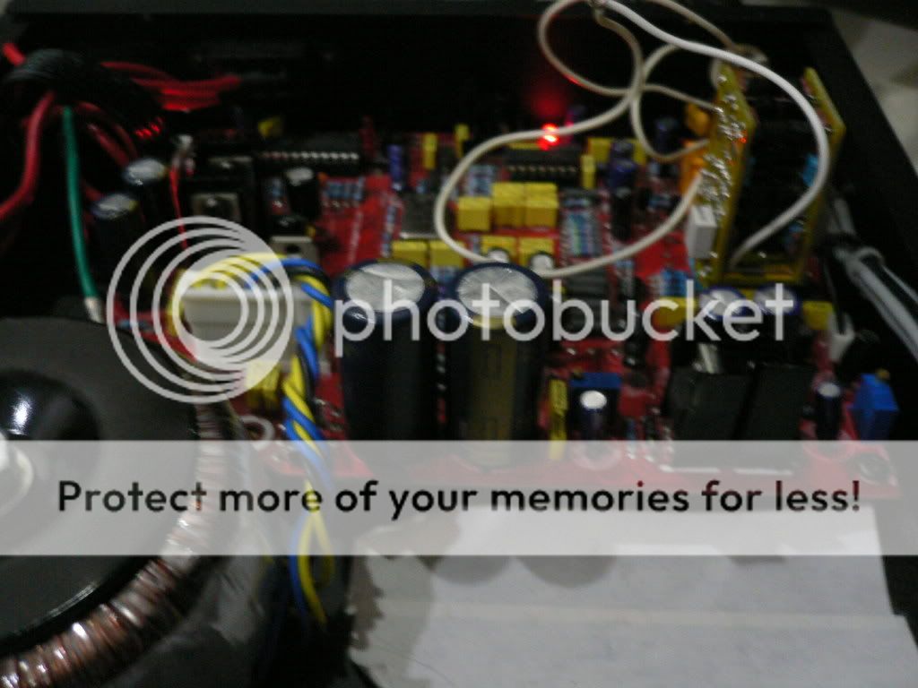

okie..so i got bored and decided to install the OPA2107 opamps into my ZERO...
Metallica - Through The Never
the highs are much tamer now...although even with stock it was real good already...but soundstage is VERY much improved. first time im hearing things where theyre really coming from... i.e left n behind and not just left only...that kinda thing...
also the intro to nothing else matters...im hearing where the guitar is echoing in the room. never heard that before...
there is 1 drawback though... mid range. the DT990 already has a recessed midrange...pair that with the airy sound signature of the 2107 the it makes the recessed midrange apparent.
lazy wanna take out and remove for now so ill just leave it be...i like the way it sounds oso anyway biggrin.gif

Today got some free time so doing some packing.Some picha to show!!
Dope with LYN nick on it to avoid confusion
Next, I will wrap the "Dope" in newspaper and then mail with bubble wrap envelop...double protection...smile.gif
About next bulk, again browndog adapter will be a non-profit bulk. Part already ordered and will ship to my friend to DIY it. Still havent arrive yet. Hopefully by next 2 weeks can reach my hand..smile.gif. Other who interested do post here or PM me.
Next bulk order list:
1) Rock_Fever - 1 X Browndog adapter + 2X OPA627AP
2) Madman - 1 X Browndog adapter + 2X OPA627AP
Cheer

Another 20 pcs Browndog adapters already arrived at my hand and ready to ship out.
Those in the 2nd bulk list below. Please pm me if U still interested..
2nd bulk order list:
2) Madman - 2 X Browndog adapter + 4X OPA627AP
3) xtremedummy - 2 X Browndog adapter + 2X OPA627AP
Price for browndog will be increase to RM9 per pcs coz it took 2 times airplane...lol..Taiwan to Philippine..then to Malaysia...tongue.gif
All Ready stock OPA627AP already been booked. If Any1 want OPA627AP, I need to get from my oversea friend. Leak time is 2 weeks.

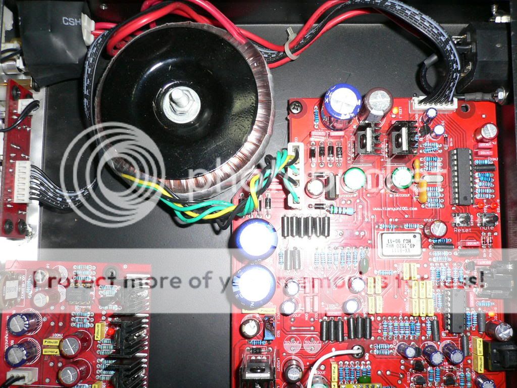

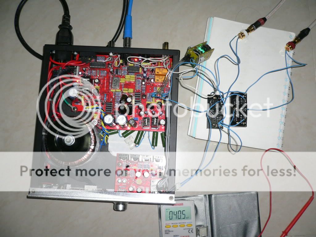

just to tease u fellers whos waiting for the zero and also the opa627..... my opa627 in DAC slot... brows.gif
anyway....here are pix of the internals of the zero after modded by empire23. dunno exactly what to take pix of...so i just hentam take only la...
enjoy the pix
ccschua
post Mar 22 2008, 08:33 AM
1,630 posts
Joined: Jun 2006
looks like the two green ceramic capacitor has to be bent to make way. what tools u used for the change?
mikelanding
post Mar 24 2008, 12:42 AM
2,865 posts
QUOTE(ccschua @ Mar 22 2008, 08:33 AM)
NO need special tool to swap opamp. Just use a smaller screw driver to slowly, carefully pry out the existing opamp.
Then slot in the new opamp WITH CORRECT ORIENTATION.
Be careful not to bend the pins of opamp or browndog adapter.

my pc doesn't have the spdif connection so i used the convertor which i purchased from godluv as well.. my setup is like this: pc -> usb to spdif convertor -> zero dac -> ms-1
i been burning my zero for around 2 to 3 days.
i found out that, i am really really disappointed with the sound.. background noise is so obviously and i am using wma lossless which all from cd audio converted it. or i used audio cd to test as well.. background noise is real loud, overall high/mid/bass so "bad", cant reveal the feeling of that music.. so "digital"..
can anyone tell me what's wrong? is the converter cause all these problem or i need not used pc as source.. should i get a reliable cd player?.. or headphone problem? surprisingly setup of zune 30gb -> visely amp -> ms-1 is "FAR" better than the dac setup i mentioned above..
hmmmmm??

Hmm... not sure about your problem. but I'm using the same setup as you,
PC > USB spdif converter> Speakers/Headphones but I don't have any background noise.. could it be that there's something wrong with the Zero you got?
I used a variety of sources from flac to mp3 which are only 128kb and haven't notice any background noise...

@kwekeugene
i suggest getting them chipset heatsinks like the ones from zalman or even coolermaster. should help dissipate the heat a little.
of course itll be better if u can figure out a way to blow a fan on the heatsinks as well biggrin.gif
anyway.....
wooooohhhhoooooo!!!!.......... just received my last 2 units of opa627s....thanks mike!!! gonna install them now rclxm9.gif
Added on April 7, 2008, 4:06 pmall installed.... rclxm9.gif
headamp section....

those who are using PCs... check ur motherboard specs.. see if it has any SPDIF header or not. especially at the I/O ports at the back...if got...use that instead....
if dont have...check ur mobo manual. look for SPDIF pins on the motherboard itself. if got then use the SPDIF PCI bracket like the one i used....u can probably get this at sri computers or something...heck...check ur mobo package.. might even have it.
this is what i used before i used the Maya44. works like a charm... no issues whatsoever and even had more volume than my Maya44. also easier to setup.
