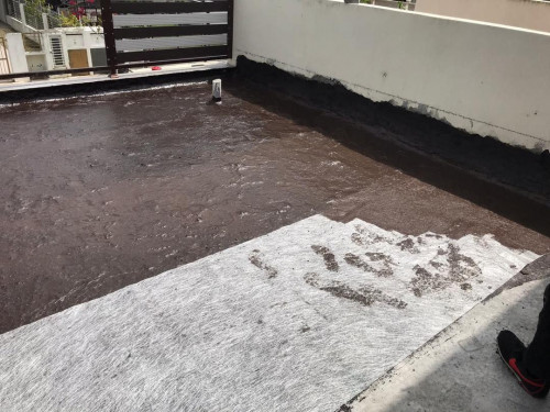

In general, There are few types of waterproofing chemical
1. Liquid applied PU waterproofing membrane
2. Cementitious waterproofing coating
3. Chemical PU injection waterproofing system
4. Exposed waterproofing system
5. Self adhesive waterproofing system
Nowdays there are a few improvement in waterproofing technology such as
Crystallization effect, epoxy coating, Silicone waterproofing, water repellent coating etc.
I believe Water leaking or Waterproofing problem is the most nightmare defects rectification work compare other defects. Worse still some contractors proposed wrong method solving the leaking matter or some contractor disappear after owner engage their service and many nightmare stories that i heard.
I will be very glad to share some of my experiences rectifying water leaking problems or waterproofing problems and share my knowledge the best solution to rectify it smile.gif
First of all, apologize for my English and please focus on my knowledge sharing here smile.gif

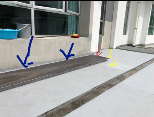

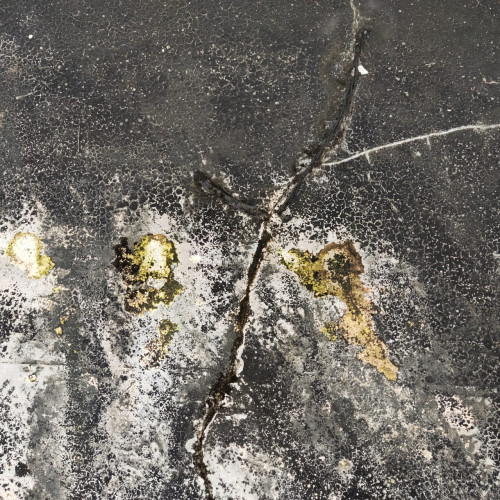

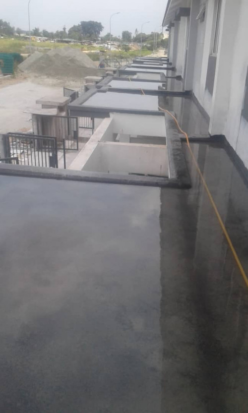

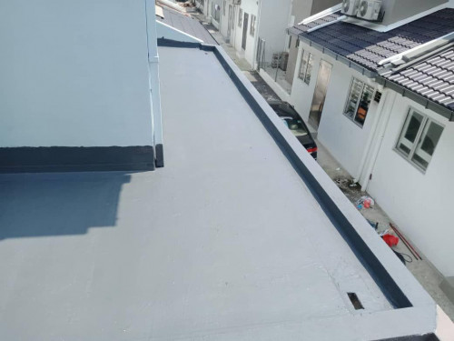

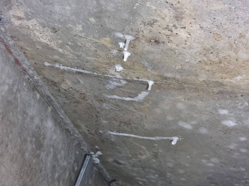

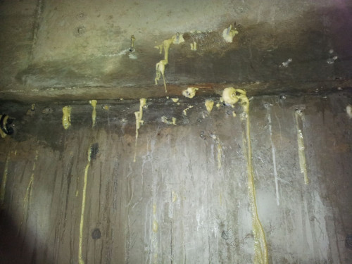

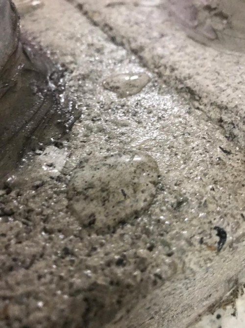

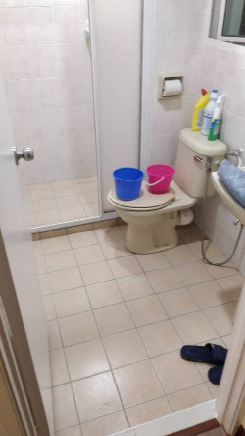

user posted image user posted image user posted image
Share me what is your water leaking & waterproofing problem here. Learn together and lets solve it.

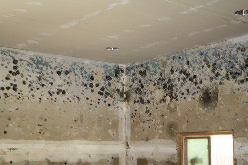

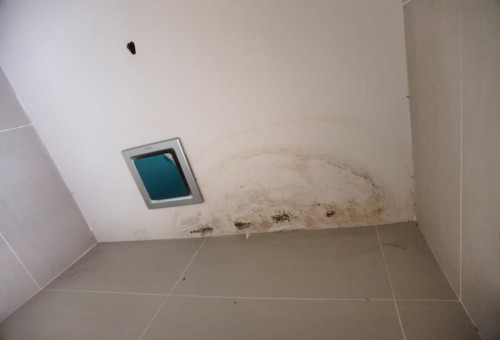

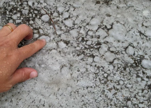

Your question regarding retiling is absolutely necessary to change if hollow sound can be heard on tiles excl.gif
It must be replace as soon as possible because over time as moisture / water will be able penetrating into tiles and structural concrete. This will create big problem in future.
The present of moisture / water over time in concrete will result concrete deterioration that will encourage mold growth, bacteria growth and steel corrosion.
The concrete deterioration means weaker concrete strength and will eventually lead to structure concrete failure.
Structure concrete failure means massive crack inside the concrete.
That is the reason we always say be careful purchasing old house as massive repair needed to be done. Water leaking problem. Waterproofing problem. Crack everywhere. icon_idea.gif

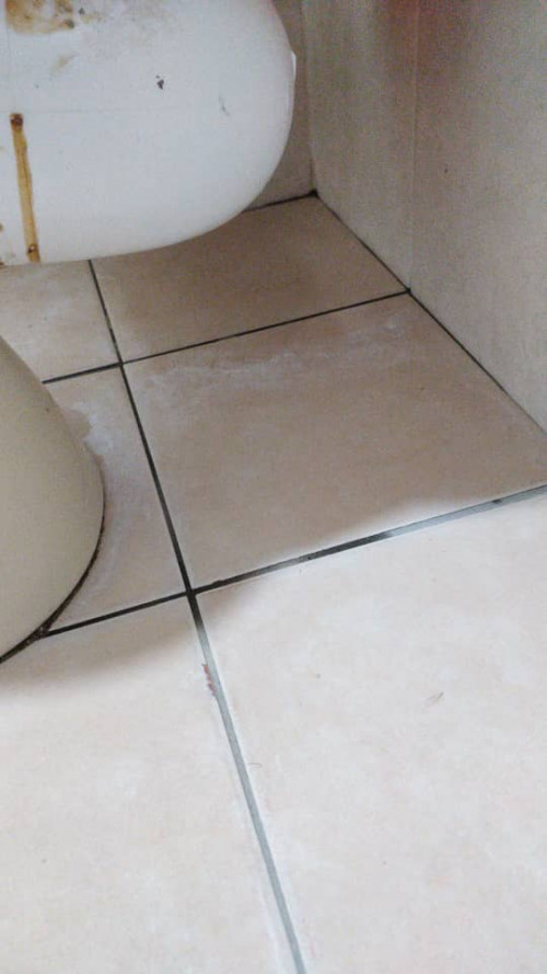

user posted image mold growth

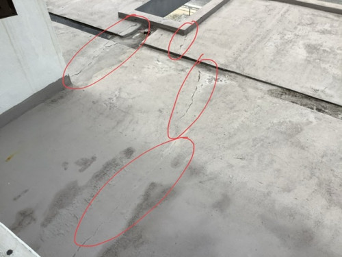

kennykck
post Jun 6 2020, 09:59 PM
!!!~~<((Bankai))>~~!!!
1,711 posts
Joined: Sep 2006

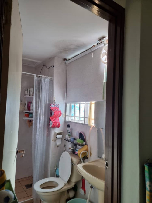

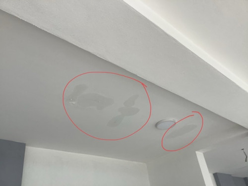

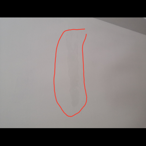

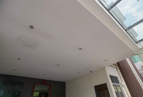

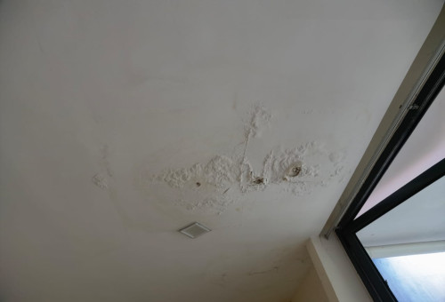

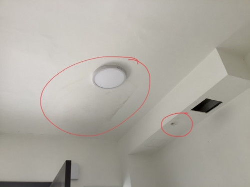

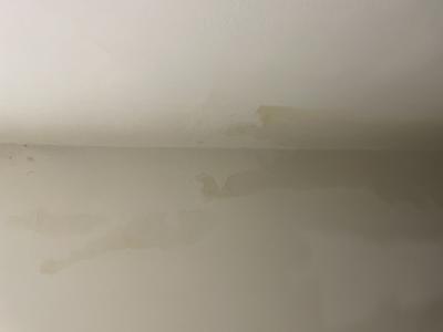

The upper floor shared bathroom ceiling has water mark during heavy rain (double storey house). What is the recommended method to repair it? Any recommended contact in klang valley?

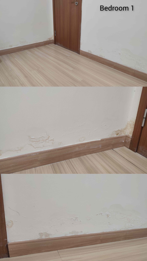

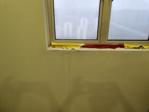

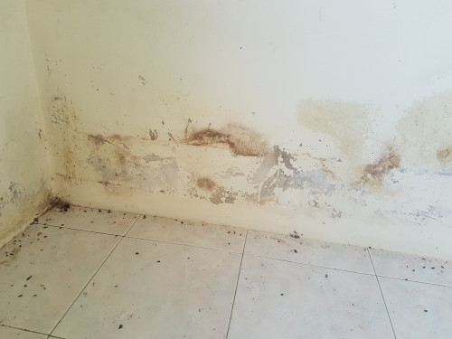

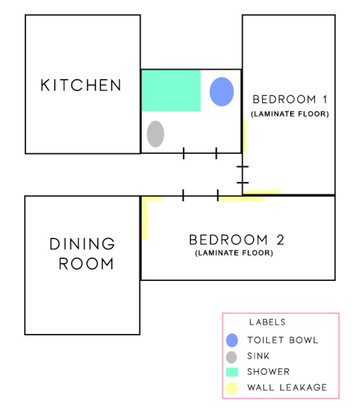

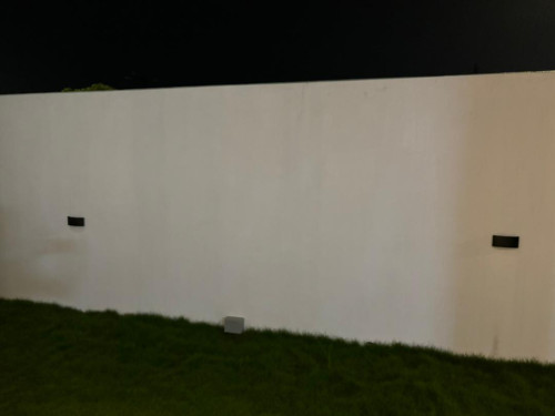

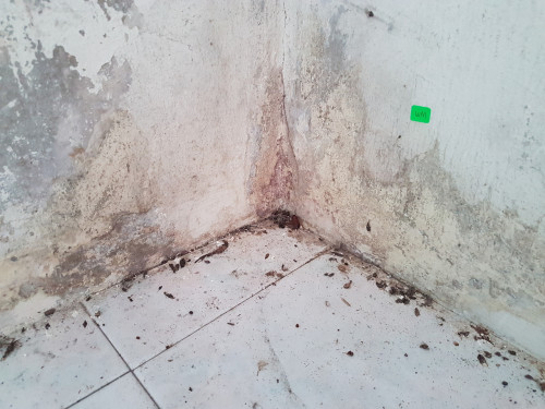

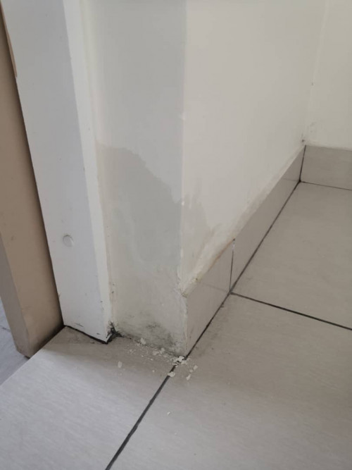

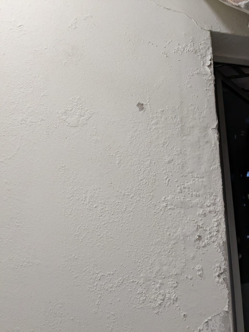

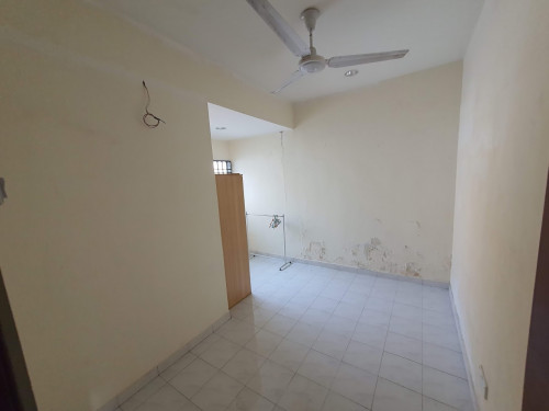

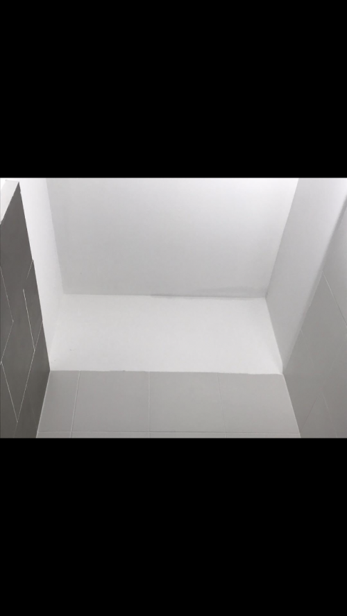

Hi sifus, i'm glad to have found this thread.
As you see in the image, i have a wall (between neighbour) that is moist at the bottom. Neighbour terrace house is actually on a higher level (about 3 feet higher). Our street is on a slope. Wondering if there's any long-term solution that can be applied?
(Sorry I did not read the previous thread - not sure if similar problem has been addressed.)
Thanks in advance.

QUOTE(kennykck @ Jun 6 2020, 09:59 PM)
Firstly need to identify the water leaking source, since you mention heavy rain only leaking,
1) it could be clogged drain that resulting water ponding, then overflow rainwater leak to the shared bathroom (this is not waterproofing problem)
2) if waterproofing problem, the need to study and access the condition. i) concrete surface (crack?) ii) the side of corner area (angle fillet) iii) does it have enough rainwater downpipe? iv) old waterproofing wear out?
You can PM for recommended waterproofing water leaking contact in klang valley. This will be good for lowyat waterproofing case study biggrin.gif
QUOTE(metalbod @ Jun 8 2020, 10:46 AM)
Thanks in advance.
From behind
1) If you could somehow access the concrete wall behind, apply with fast setting mortar cement, best to hack alittle deep (U shape) into concrete wall before applying fast setting mortar cement. The bonding strength will be stronger.
2) Another option is applying epoxy sealer around the area.
From front
1) use PU grouting injection chemical to fill the porosity crack concrete.
2) many ppl scrap the painting wall / plaster wall and apply with epoxy coating or waterproofing coating. Then repainting back. It works and you wont see leaking patches however there is a possibility in future growth of mold inside the concrete as the water / moisture will still be there

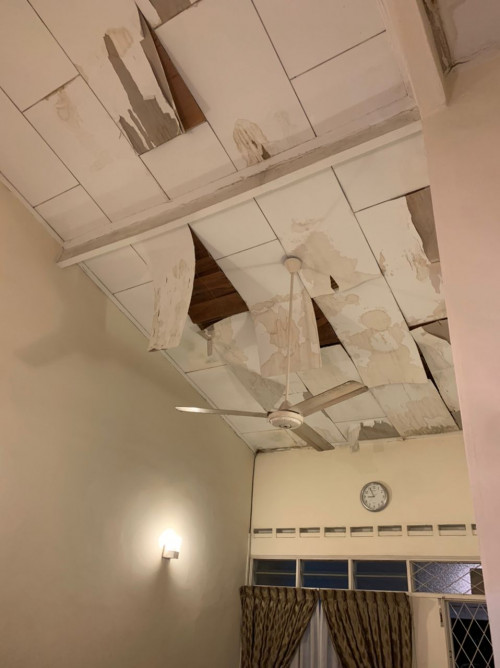

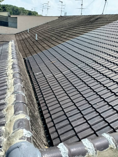

Hi,

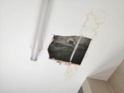

My zinc roof at my balcony kinda leaks badly when it rains heavily. Beneath the zinc roof, there are plaster ceiling and they are already brownish in colour - not sure if it's due to the leakage or simply the paint is not good enough.
One part of the plaster ceiling eventually fell off and I could now take a peek at the leaks when it rains and seems like it's mainly leaking at the roof joints / "paku".
Do you know what to do to fix this permanently? Apply silicone on the paku area? Or something else?

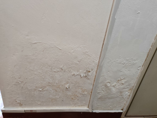

QUOTE(Daang @ Jun 9 2020, 09:57 AM)
From behind
From front
Hey, thanks for the advice.
Unfortunately i won't be able to access from behind as it is neighbour's wall. smile.gif
OK, will do the work from front. Ya, I think the future issue with the trapped moist will be an issue. sigh... But better than let it "rot" like now.

QUOTE(Refuzed @ Jun 9 2020, 12:42 PM)
Hi,
The nail should be at the top section of ~ zinc which shouldn't leak, unless it is heavy rain, whereby inclination of the roof is not steep enough to drain out the water fast.
There is a kind of tape or black soil stuff that can seal off the hole, which is easily available in hardware shop. Just tell them you want to seal off the nail hole of your zinc.

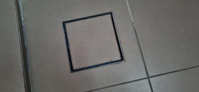

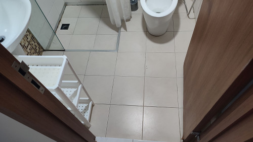

Hi Daang and sifus,
My masterbedroom bathroom is leaking to the lower floor. already did waterproofing using the solution but only last a few months and now starts to leak again. At the bottom of the stairs, there're water dripping from above.
Already asked quotation from a contractor. He suggested to do the whole bathroom.
What I'm not agree with him is the time taken. His proposal schedule:
1. hacking - 4 days for a 8x5.5' bathroom
2. Water proofing - 4 days( 2 days to cure and 2 days testing)
3. Tiling 4 days.
My question:
Is it really 4 days to do the water proofing?
I need shorter days coz I cannot take longer leave days.
Thanks

post Jun 17 2020, 09:28 AM
68 posts
Joined: Feb 2020
QUOTE(merci @ Jun 16 2020, 09:49 PM)
Hi Daang and sifus,
3. Tiling 4 days.
My question:
Thanks
Is it altogether 12 days? That would be too long for a bathroom waterproofing work. But 4 days for the whole work that would be usually the case as hacking and tiling takes time, waterproofing needs time to cure as well. Water ponding test does require days but you do not need to be there to monitor.
