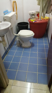

Is your small bathroom completely new? The entire floor is "naked'? If so get those "cementitious Waterproofing type will do. Cementitious Type waterproofing is the cheapest among other membrane type (Polyurethene PU, Torch On membrane, Acrylic Polymer etc...) Internal areas can be apply with cementitious waterproofing membrane because internal areas do not exposed the sun and rain.
Exposed area to sun and rain must not apply with cementitious type waterproofing. The reason is over the long period expand and contraction will easily damage the brittle type cementitious waterproofing.

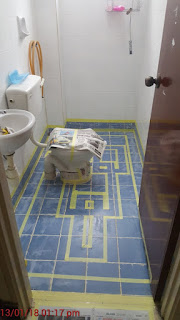

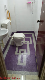

I assuming your self adhesive waterproofing DIY type is pour on the tiles flooring surface and allow it penetrate into the concrete pore? This DIY type depending on the tiles and concrete profile surface. If the concrete profiles surface full of severe crackline / very porosity or the existing waterproofing embedded inside the concrete poorly apply. This self adhesive DIY won't be effective.
This DIY might work if the leaking is very minor and concrete profiles surface is not severe.
My definition of self adhesive waterproofing type is those apply at large scale project spec by architect. Its not very popular type of waterproofing

I think those DIY type is less effective to counter water leaking unless the situation leaking area is very minor. There is another method solving the water leaking without hacking existing tiles and redo the waterproofing which is inject PU grouting. Inject PU grouting is pretty complicated and one must be experienced and skillful to inspect the leaking area to made the best decision. This PU grouting is the most popular method and widely use by the developer and contractor when newly move in house owner complaint their unit is leaking.

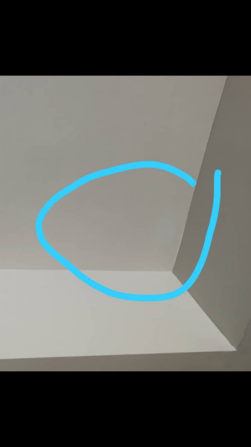

Moonhowler,
I chance upon this thread, and hopefully u can help me out.

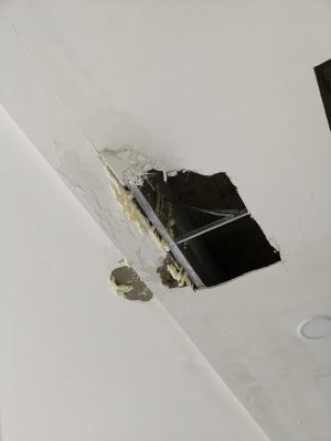

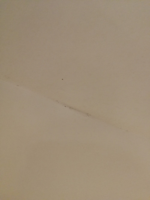

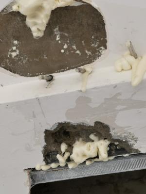

I'm currently extending my backyard yard to a wet kitchen, and the current progress is say bout 70% done. Roof tiles are the large cement(or clay) corrugated kind, and ceiling are plaster ceiling. There isn't any insulation in between.
The issue is we found moisture/condensation spots on plaster ceiling joints on a few spots, and we thought it was due to roof leak. Efforts has been done to seal the roof even more, with bitumen tape i think, hopefully will stop the issue.
However, since laying the wet ground cement (prep for tiling) yesterday, this morning i found the condensation was more severe on the ceilings, especially the usual spots..and i found out it might be a condensation issue instead of roof leak, when i wipe the inner windows and its all damped. Usually I close off that area during the evening and night, so no ventilation movement, and i can feel its very humid with heavy masonry smell.
Now, i am leaning towards this might be a condensation issue due to the wet masonry works that's not all dry out, and bad airing practice i have been doing at this phase.
Does anyone faced this kind of issue before, and hopefully can enlightened me, as me and my contractor are still puzzled. My contractor is those China-man self employed kind, so i suspected he isn't well versed on this condensation matter as well.
Next phase I will try hoisting the new roof with pipe water to chk if any leakage from roof, so i can rule out the roof.
Its a nightmare for me at the moment, not knowing what shit is gonna come down the road due to this water/leakage/ condensation issue.

QUOTE(tcb2010 @ Aug 4 2017, 10:53 AM)
Moonhowler,
it's concrete curing process - they release heat which causes the condensation
pus some fans to dry out the place during these 2 days (weekend) and see any difference on monday or not before continue work
damp rising from ground floor slab shouldnt be obvious at this stage and will not cause water droplets to appear on the soffit or ceiling board
Moonhowler,
Can do some initial investigation first if not sure. Any raining that particular day?
To check whether its condensation or leaking at the plaster ceiling. Maybe you can ask the contractor to cut that area of moisture / condensation spots on plaster ceiling and allow few days to monitor any minor leaking?
If condensation, just install exhaust fan could easily get rid of the bad ventilation humid air.

QUOTE(iamoracle @ Aug 9 2017, 08:40 AM)
Thanks for your informative reply.  smile.gif Any other method that can make it less slippery?

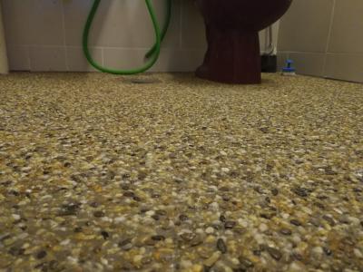

I met the waterproofing contractor that using another method more or less similar method like Epoxy flake waterproofing but without apply epoxy final layer. Less slippery and pretty good looking too.
Attached Image Attached Image
Its finishing using those typical pebbles type and he did a very slope. Water flow down to downpipe very fast leaving the area floor dried up very quick. Due to pebbles rough surface, its not slippery at all.
I will explain in more details his method on my next post.

QUOTE(moonhowler @ Aug 19 2017, 05:35 PM)
Sorry for the delay update. I wasn't accessible to my computer for one week due to outstation =)
I semi-retired doing waterproofing work already. Hahaha!! However if you want a truly specialize waterproofing contractor around klang valley. Those only do waterproofing and rectifying water leaking. I could share their contact number here. I can find my old specialize waterproofing contacts at Johor and Penang area too after i ask their permission. =)
I classified two types of waterproofing contractor.
1) A waterproofing contractor specialize doing commercial big development project (example: Shopping mall, Condo etc)
2) A waterproofing contractor specialize doing only residential house (example: house toilet, shop toilet)
I will share their contact numbers here after i get their permission. Because some of them are attached to manufacturer waterproofing plant.

fuhh... the pebble floor is a nice way to refinish toilet floor & waterproof it too. this is brilliant
Interesting concept. Is it more expensive than regular Epoxy flake waterproofing?

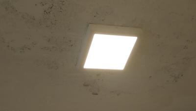

Hi sir,
I suspect my newly bought condo unit to have some water seepage from shower to the wall. Paint on the wall right outside the shower area have some bubbles / wet mark. The wall is dry now as bathroom have not been used for a year. Switched on all water pipe for 2 days and wall still dry hence i believe piping still ok.
Any services that you can recommend?
Many thanks.

is this New Condo like BRAND NEW or you just bough a resale unit?
which area of wall outside shower area is leaking? wall inside bathroom outside shower area?
usually wall waterproofing only until few inch from floor, the rest of the floor usually use tile to cover. even with waterproofing the normal paint used indoor may not be suitable for wet environment and should use waterproof paint used mainly outdoors, or maybe add a sealant on top of the paint.
when water sips in from surface and cannot escape bubble starts to show.
if got photo easier to tell.

Many thanks for your reply. the condo is subsale unit.
the wet sign is at wall outside toilet. not inside.
Below picture for reference.

After 7 years of ignoring the leaking.. finally..
From this
into this
It cost me rm970 for this small toilet.. and I can get it at rm800 if the epoxy is just of a single color.. This price is for toilet below 30sqft. It's been 2 months now, and I still dont see any leaking.. Phewwww.. what a relief.. Looking from far away, the pattern looks nice, but when looking closer, it's farrrr from perfect. Not as beautiful as the one I saw in a hotel.. The lines/pattern boundary are blurry ... lots of color.. how do i say it, color bleeding? something like that..
This post has been edited by zeese: Mar 1 2018, 06:02 PM

so what did you do on the toilet actually other than changing tiles?
SUSadvocado
post Mar 1 2018, 06:57 PM

ok so what is on the other side of the wall that has the bubble? is the other side tiled? or just bare wall? gets wet often?
show us what's at the other side.

zeese
post Mar 1 2018, 07:25 PM
Warning Level
1,818 posts
Joined: Jan 2005
QUOTE(advocado @ Mar 1 2018, 06:56 PM)
I'm not changing tile! I'm putting epoxy coating on the floor.. It's like you spread a glue (epoxy coating) all over the floor (no tile removal), then sprinkle a colorful flake on it, then finish it off by spreading a last layer of clear epoxy coating above it..
This post has been edited by zeese: Mar 1 2018, 07:26 PM

QUOTE(zeese @ Mar 1 2018, 07:25 PM)
So far got no more leaking? U satisfied with the solution n workmanship?

QUOTE(zeese @ Mar 1 2018, 05:56 PM)
From this
into this
can u share the pics of the process they did to prepare such flooring?
SUSadvocado
post Mar 1 2018, 09:00 PM
2,948 posts
Joined: Jun 2007
but color change to purple and got new grey pattern. those are the epoxy or the flakes?
the epoxy not slippery?
u got put epoxy few inch on the wall above the floor?
Interesting, didnt realize such a product/solution exist! thanks for sharing.
Did you DIY or hired a contractor.
I just goggled and found pretty straight forward in application, but a little pricey, i think?
https://www.youtube.com/watch?v=8LBT_3JnJ3E
https://www.lazada.com.my/epoxy-colour-flak....750b126c5SK8tC

zeese
post Mar 1 2018, 10:20 PM
Warning Level
1,818 posts
Joined: Jan 2005
QUOTE(enduser @ Mar 1 2018, 08:08 PM)
Im planning to do epoxy flake coating also but need to find trusted installer first.
Yeah. No more leaking. I am satisfied. About workmanship, I mentioned in earlier post, it looks beautiful from afar, but at closer look, i think they can do it better.
QUOTE(lucifah @ Mar 1 2018, 08:32 PM)
I just took 1 picture.. this is the early process, after sanding the tile. Marking & masking according to required shape/pattern. Then, applied a glue (epoxy) on selected part, then, sprinkle a whitish flake. Wait till dry. Then, re-adjust the masking tape and apply glue on another part followed by sprinkling a purple flake.. (just like how to paint a car with multiple color that requires lots of masking tape).
QUOTE(advocado @ Mar 1 2018, 09:00 PM)
Yes..those colors are a flake, that looks like a flour/sand to me, and they also applied on the bottom part of the wall too ... The floor surface is not smooth actually, so, it is not slippery. They can make a smooth surface, if it is for table top application.
QUOTE(VeeJay @ Mar 1 2018, 09:11 PM)
I just hired someone after I search on fb/mudah/lelong. Keyword I use was "epoxy+flake+toilet". In theory, it looks easy, but when I saw them do it, the first thing they did was sanding the tile to remove the slipperiness of the tiles. It looks tiring to me. Anyway. from youtube, I agree it looks easy to DIY especially if using just 1 flake color.
This post has been edited by zeese: Mar 1 2018, 10:47 PM

QUOTE(zeese @ Mar 1 2018, 10:20 PM)
may i know what is your toilet area so i will know roughtly how much / sq ft the cost is
they sand it using sandpaper manually?

QUOTE(lucifah @ Mar 2 2018, 12:30 PM)
Mine is below 30sqft... Anything 30sqrft or smaller, the price still the same. That's the min price..
The guy sanded using hand drilling tool..

QUOTE(zeese @ Mar 2 2018, 02:48 PM)
are you sure is hand drilling tool? last i check, either not enough torque or too much rpm. tools used for grinding tiles is special one, much more expensive than drill.
and no car polisher doesn't work too well too.

I have been facing this car pouch leaking issue near the beam. Currently the issue have been "rectified" by developer sub contractor under warranty. However, after PU injection still have water leakage stain as per photos below. Not sure is it water or the PU injection leaked out and touched plaster ceiling that causes yellowish
Any kind input would be much appreciated.
Thank you
SUSslimey
post Oct 28 2018, 04:50 PM
6,914 posts
Joined: Apr 2007
QUOTE(crusher @ Oct 28 2018, 04:32 PM)
Guys,
Thank you
What type of roof above the car porch?
Also, does the position of the water mark coincide with the water drainage of the roof for the upper floor?
crusher
post Oct 28 2018, 05:17 PM
1,345 posts
Joined: Jun 2006
QUOTE(slimey @ Oct 28 2018, 04:50 PM)
Concrete slab.
Suspect the leakage leaked down from the beam. Unfortunately the water mark does not coincide with water drainage of the roof
SUSslimey
post Oct 28 2018, 06:13 PM
6,914 posts
Joined: Apr 2007
QUOTE(crusher @ Oct 28 2018, 05:17 PM)
Concrete slab.
i suspect they PU injection the wrong place.

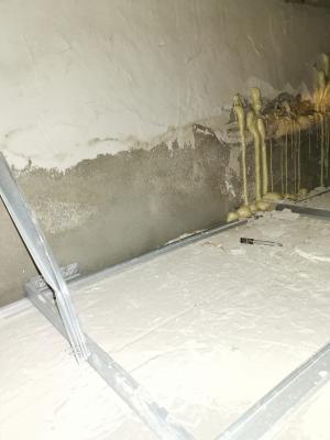

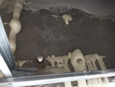

this. one time i see liao i know they injected at wrong place
should have injected it on the beam near the slab (topmost) or on the slab nearest to the beam
what i see is they inject in the MIDDLE of the beam, which does nothing
May have weaken the beam lol

Apparently the leaking after PU Injection has become worst. Water has been dripping down onto floor.
Any good contractors can recommend to fix this issue? Afraid by the time contractor from developer come is too late

Yes I have stopped the contractor from doing so. However he have no idea where is the leaking come from. He did a second time PU Injection on the leaking beam but it does not stop the leaking for overnight.
Apparently there is a crack when they did the pu injection from inside and outside. Injection done at bottom but PU leaked out from upper part
If wasnt under Defect Liabity Period by developer, this contractor considered as failed one. The contractor wouldn't want to spend extra to do torch on membrane by other sub contractors that I wish to propose
ok. does it only leaks when it rain? if not, then you are looking at other leak sources
and again, the contractor is injecting the foam at the wrong place
you dont inject it in the middle of the beam

Previously yes, once rain heavily only will leak. After the first PU injection in middle of beam, the leaking has become worst.
Now, as for today from one whole row has become only one place dripping down. Suspected the water stucked somewhere and leaked in.

QUOTE(crusher @ Nov 8 2018, 02:14 PM)
Lel. Still injecting at the wrong place.
Hopeless contractor that knows shit about waterproofing.
I suggest stop wasting time with the same contractor. And hopefully the developer ditch that useless contractor.

Yeap. They keep injecting at wrong place as per mentioned by other contractors too, damn worried my beam kena damage by their PU injections.
Now developer getting architect to come but architect on leave till next week. Till then I think its harder to find the leak as no more heavy rain coming days

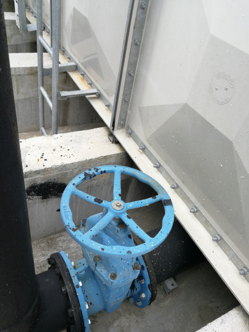

post Nov 23 2018, 09:21 PM
54 posts
Joined: Jul 2007
Hi all,
Advice needed from all the sifu here. I moved in to my condo last week and start to notice some mold mites on the ceiling. Then only i started to found out that they are actually stick around on my ceiling area that is damp and water marks are seen as well but is kinda difficult to notice. The affected area is quite big, almost quarter of my living room and my closet area
I have reported to my the condo defect team but after they examined, they told me need to inject PU from my unit instead of from the above (I stay at top floor, level above is sky deck). That's why I would like to get 2nd opinion before they simply inject PU on my ceiling.
Any sifu here got contact that is able to help?
This post has been edited by yumi17: Nov 23 2018, 09:24 PM
lucifah
post Nov 24 2018, 11:56 AM
St. Fu
Staff
7,948 posts
Joined: Jan 2005
From: Soviet Sarawak
QUOTE(yumi17 @ Nov 23 2018, 09:21 PM)
Hi all,
if you can take pic of the skydeck then it would make for a better decision
what i am afraid most of is when they do the pu injection at that place, the leak will creep to other place because the whole sky deck isn't waterproofed
plus, PU injection marks are very ugly no matter how you want to hide it. the injection ports and marks are difficult to conceal
yumi17
post Nov 24 2018, 03:36 PM
54 posts
Joined: Jul 2007
QUOTE(lucifah @ Nov 24 2018, 11:56 AM)
That's what I am worrying as well. I will take a picture tomorrow. Thanks

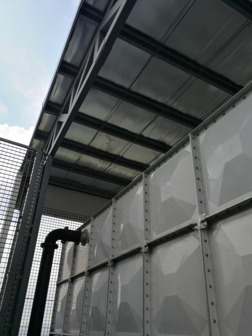

post Nov 26 2018, 09:46 AM
54 posts
Joined: Jul 2007

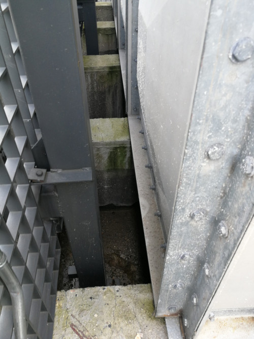

Above is actually a water tank, difficult to access, any other option in this case? They came to visit just now, and told me they will see whether able to inject PU from above.
Also, I saw there is this act Strata Management (Maintenance & Management) Regulations 2015 (SMR) PART XV that developer is required to identify the root cause within 7 days of my notice. If I am dissatisfied with the solution, I should go to commissioner. Anyone has tried this method before?

lucifah
post Nov 26 2018, 01:17 PM
St. Fu
Staff
7,948 posts
Joined: Jan 2005
QUOTE(yumi17 @ Nov 26 2018, 09:46 AM)
if water tank then check if the water comes from the water tank or piping leaks
it doesnt seem to be from rain water leaks as i see roof on top of the water tank from your picture

I'm not sure the size of the leak but there is only one patch of it from the ceiling beneath, i believe the leak is from the cracks from the concrete roof, any idea how much is the price to do the membrane per sgft and any recommendations? do they fix the plaster ceiling beneath as well?

Just did a comparison. PU injection RM1850, epoxy flake rm850 and addresses the problem from the root cause (ie from the leaking bathroom itself). With this price/benefit ratio, can someone share what is the advantages of PU that cause more than 2x the price while solving the same problem?
Of course the scenario being addressed here is limited to bathroom leaking, other scenarios maybe PU might be more convincing.

yumi17
post Nov 29 2018, 03:27 PM
54 posts
Joined: Jul 2007
QUOTE(lucifah @ Nov 26 2018, 01:17 PM)
This is the reason of the dampness on my ceiling,
Other water tank got no such issue, probably because of the shelter?
Any idea what I can do about it?
lucifah
post Nov 29 2018, 04:02 PM
St. Fu
Staff
7,948 posts
Joined: Jan 2005
QUOTE(yumi17 @ Nov 29 2018, 03:27 PM)
i think this one is under developer / JMB resposibility already
best way is to do waterproofing from the top as there are a few possible water entry point - either from the RC plinth - slab corners OR from the anchor bolts that was drilled into the concrete slab, damaging the waterproofing layer / membrane
