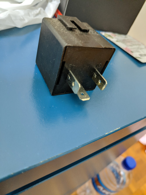

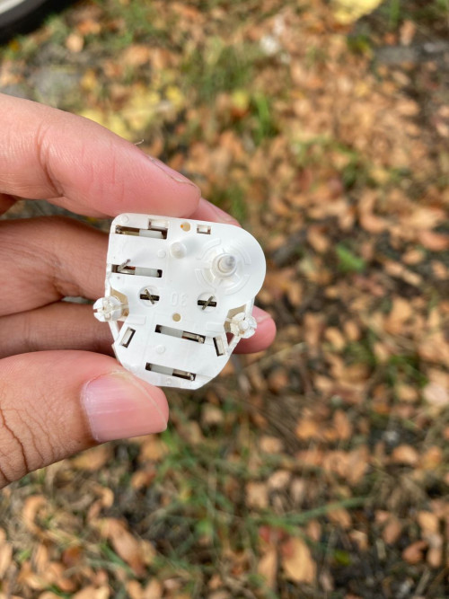

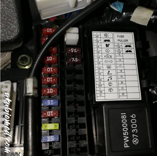

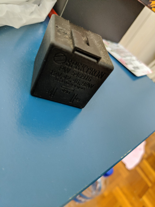

This is the relay I was talking about. Model number is PW 546916. I plugged it out and put it back in, it worked for a while then back to no signal.
I search for the model number online and found plenty of seller, so I went ahead and bought one since it's below RM20.

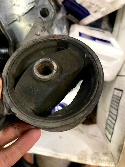

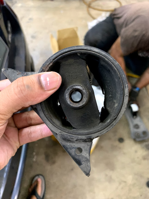

Just changed all 4 engine mounting for RM330 including labour, of course it’s non ori, the foreman said ori one cost 500 haven’t add in labour. Hope it will last.
Add on, also done ECU tuning and injector cleaning , cost bout 135. Now the car feel very light and more powerful and also quiet , less vibration , I think due to new mounting too. Like a new car already.

QUOTE(wklow28 @ Jul 3 2019, 08:43 PM)
Not sure what that fella do, plug in OBD read only i guess, and do fuel injector cleaning. But after tuning can feel obvious difference, the car really feels lighter and engine quieter.

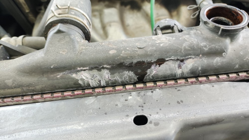

guys, my persona coolant disappearing without leaks.
1) Did pressure test at workshop, no leaks observed
2) Went to flush and change coolant. After turning on car, coolant starting overflowing from opened radiator where the cap is supposed to be. Workshop said thermostat faulty so changed thermostat, radiator cap, and new coolant 50/50
3) after 3-4 weeks without checking everytime , the radiator fan will continue moving even after I turned off the engine. This is an indicator when the coolant is not enough. Everytime in the radiator have to top-up around 1 litre+, reservoir totally empty
Now people saying its blown/cracked head gasket. But my engine still running fine. Engine oil normal color. Foreman recommended to do top overhaul. Even when/before/after the radiator fan continue moving after engine off, the temperature gauge is still fine. Never overheated before or anything.
Foreman also said maybe the coolant leaking into exhaust?
what do you guys think?

QUOTE(diversity @ Jul 4 2019, 10:00 PM)
3) Every 3-4 weeks, the radiator fan will continue moving even after I turned off the engine. This is an indicator when the coolant is not enough. Everytime in the radiator have to top-up around 1 litre+, reservoir totally empty
Wah this sounds bad... You ever consider to buy those UV dye recommended by Scotty Kilmer to trace leak?
Edit: Scotty Kilmer is a channel in YouTube. Just search for coolant leak scotty kilmer.
This post has been edited by inferno_17_85: Jul 5 2019, 12:42 AM

Hv u guys changed radiator before? Dam I just realised there’s water dripping at the front I suspect it’s from radiator. Blardy hell 200k mileage prob starts coming out 1 by 1
inferno_17_85
post Jul 5 2019, 09:13 AM
14 posts
Joined: Oct 2009
QUOTE(anakMY @ Jul 5 2019, 12:36 AM)
On my second radiator after accident in 2013 until now.. Probably it's relatively new so haven't kaput yet. But better check bro. Later overheat and engine damaged.
same problem here. my radiator water will splash out like volcano.. i just let it be.
update me after you fixed the problem i want to see the cost.

My friend's persona had the same problem, water drying and the leakages not visible anywhere. Than his mechanic saw a small leak from the coils in the radiator. Due the the radiator fan and the air caused by it, the water leakages not dripping as usual but dried due to the air flow.
