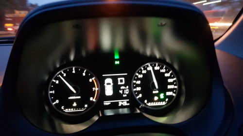

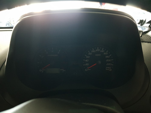

cold started engine, idle for 10minutes, no turn on air con at all, temperature bar go up to 3 bar, fan no spin at all, reservoir overflowing.
Possible fan relay spoiled? or I can just confirm temperature sensor spoiled? are these under warranty?
if fan relay spoil then by right the fan won't start turning when you switch on the aircond. Maybe you should pay a visit to car sparepart shop if you don't mind spending some money for a new radiator cap. If changing the radiator cap works, then it is the problem. Else, it could be others. I have a wild guess is that the coolant system might behaving air pocket. Something that is common for persona vvt, but then the temperature will shoot up to 4 bar and the fan will keep on spinning non stop even you off the engine.

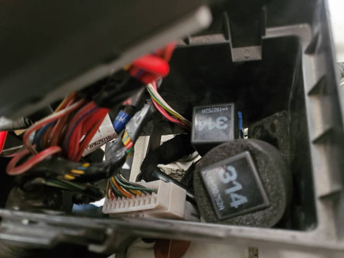

6. RADIATOR FAN RELAY ISSUE. MY CAR OVERHEATED 3 TIMES. Once on the wat home. Once in Penang. Once again on the way home. - First time happened. Changed fan relay as it was burned. SC said it was faulty FUSE BOX. Need rm700 to fix. I did not proceed as it still works after new relay. SC said it might happen again suddenly relay burned due to fuse poor contact in the relay box.
- 2 months later in penang, it happened again. Overheat, stopped at side. But after shaking the fusebox, the fan started to run! Since i was rushing that time I didn't think much about it and went on my way. Feeling fortunate I can get it running. I thought it was indeed a loose contact in the fuse box.
- 3 months later happened again. And I managed to drive it home although 5 out of 6 bars temperature. And this is what I discovered and solved. The relay connector for my radiator cooling fan have loose contact! Not the fuse box electronic issue. See video below as I push that relay, my radiator fan stops but starts when i release or vice versa. After discovering this, I send my car to a workshop and he just changed the relay connector for me nicely and problem solved!!!
This below after change the relay connector harness to new. Now even if I shake vigorously it won't affect my radiator cooling fan .

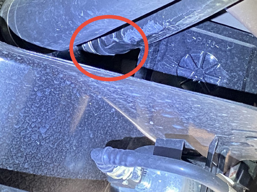

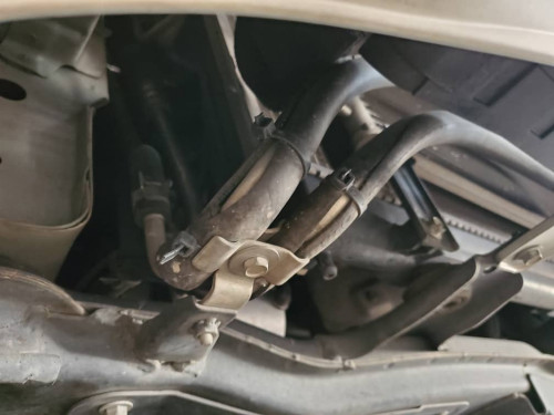

2. Radiator hose drop cause overheat.
3. The coolant fill from the factory side is not full, it's filled lower than the minimum level. (WTF !!!!???? Proton Save cost manner? )

May I know where is the radiator fan relay located? under the fuse box? thanks in advance.
Yes inside the fuse box. Opening the top cover, u will see many fuses, that part can further remove (have 3 latches) to reveal the radiator fan really underneath.

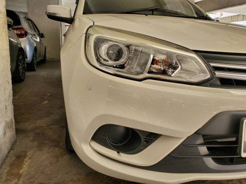

21. The bumper design defect causes the annoying noise when rolling down the uneven road.
22. Fender (both side) edges design defect, causing metal hit metal noise.
23. The Rearview camera is not calibrated centre, cause parking is not parallel. ( even Toyota honda Nissan etc the rear camera install at the side, the image remains centre. SO PLEASE do no blade saga facelift owner parking is not straight especially for the female drivers who are much reliant on rear view camera for parking and reverse.)
24. Rear Seat belt bearing produces weird noise.
25. The remote key button is very hard to press, not sensitive and not friendly to us, especially female have long nails.

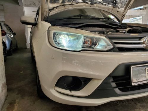

26. The headlamp shines very narrowly ( Proton engineers brain also that narrow and straight! hahaha ).
27. The headlamp low beam brightness is not evenly distributed. ( Proton engineers resources also not distributed well! hahaha)
28. Paint defects skated around the outer shell. (hand spray or machine spray? I thought Proton using World most sophistical manufacturing technology like promoting in Discovery Channel) 29. The owners manual has a lot of wrong illustration and instruction that make user confuse. such as, using Persona and Iriz image illustration and the instruction was not correctly tech.
