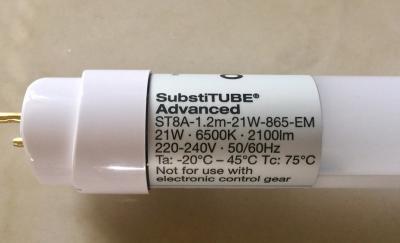

TSmot88
post Oct 6 2017, 11:21 PM
141 posts
Joined: Oct 2005
Philips T8 Led has gone down in price in 2017. There is a higher lumen of 2100 for RM 17.50 that is coming soon. Noted most shop has not reduce the price following Philips recommended price. This includes big hypermarket.
The next question is where to get? There is one Philips authorised reseller in Kuchai Lama (opposite of De Tropicana condo, also nearby NSK), which item can be order if not in stock. Heads up they normally serves more to contractor, so don't expect very good service from them, i.e tell them what you want, pay and leave the store.
Philips Led 2017 catalogue

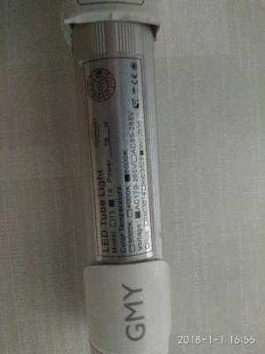

IM using China no brand T8 LED tube daylight now ..not sure how many lm
the cover was plastic ...as Attached the light ...like not bright enough..

Plastic T8 cover is earlier generation led. Now, most if not all T8 is sold in glass tube. Since you are not sure brand and the wattage led, hard to advice.
China T8 led is usually Type A. If your lamp holder does not has a hole to put in starter or the wiring has been disconnected from the starter hole, you need to open and modify the wiring, i.e not plug & play for Philips T8 led.

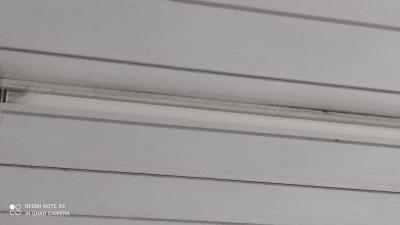

Just plugged in, seems quite bright to me or at least bright enough biggrin.gif

quick question. do i need to peel off the sticker at the end of the tube that says where the head should be?

Philip tube received ...
removed my existing casing install the casing came with tube ..
attached was my China T8 LED tube ...
thanks ....
TSmot88
post Jan 2 2018, 12:16 PM
141 posts
Joined: Oct 2005
QUOTE(advocado @ Jan 1 2018, 09:16 AM)
is T5 better or T8?
also you mention Philip T5 has different connection, majority T5 in the market has wires on 1 side or both side? what about their T8?
do T-5 have short & long length like T8 do?
T5 is slim version of T8 for Led. T5 comes with bracket 'LN' is at 1 side only as the main pupose of using T5 is to join the light side by side for kitchen cabinet /plaster ceiling cove lighting. Most if not all T5 led comes together with integrated bracket. The tube cannot be detached once its not functioning. Please check the T5 led at shop to understand better and the variety of lenghts available.Yes, T5 led is available in various lenghts.
Btw, this discussion is on T8.
QUOTE(sgpdsmss @ Jan 1 2018, 05:09 PM)
thanks ....
Thanks for sharing. Havent seen this brand of T8 led tube before.

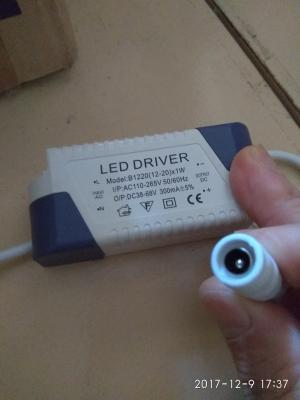

QUOTE(frostier @ Mar 17 2018, 11:12 PM)
Usually it’s the product specs on wattage, power factor , liken output, lifetime and CRI.
EM rating usually not shared unless you requested for test report
Pls refer attached driver photo ...anyway to know less distortion driver ?

Hard to see from the image alone.
If got brochure,maybe easier.
sgpdsmss
post Mar 18 2018, 09:00 AM
1,704 posts
Joined: Jan 2005
QUOTE(frostier @ Mar 18 2018, 08:46 AM)
those China LED driver only seldom have brochure....

If you guys looking for Osram Substitube Advanced 21W T8 tube, let me know. Available in 6500k and 4000k. Come with replacement choke.
Attached Image Attached Image
sgpdsmss
post Mar 22 2018, 06:01 AM
1,704 posts
Joined: Jan 2005
QUOTE(ykho21 @ Mar 21 2018, 08:58 PM)
how much ?
how is the EM insulation?
thanks ..
ykho21
post Mar 22 2018, 10:13 PM
48 posts
Joined: Oct 2008
QUOTE(sgpdsmss @ Mar 22 2018, 06:01 AM)
how much ?
thanks ..
This tube doesnt affect radio signal like some cheap tube. For 4ft is RM48. 2 ft is RM38. Min 5 pcs/ order
