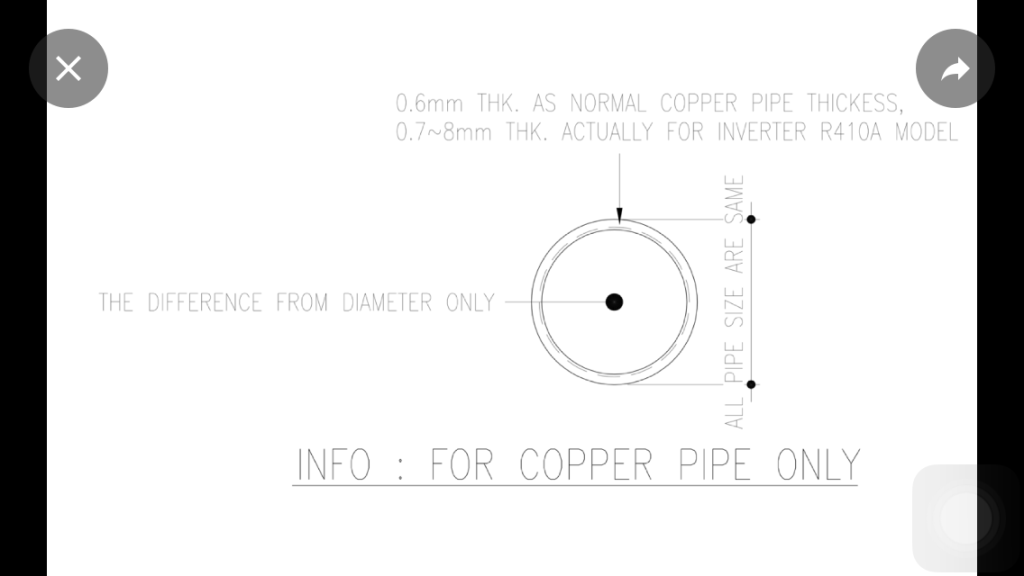

I'm assuming you are changing from an existing R22 gas aircond installation to a R410A inverter type. You can save money on the piping by just getting Daikins. They are the only brand in the market with R22 gas + inverter combo. Best case scenario is you won't need to change your piping at all. Plus, their compressors are more thermally efficient than Panasonics

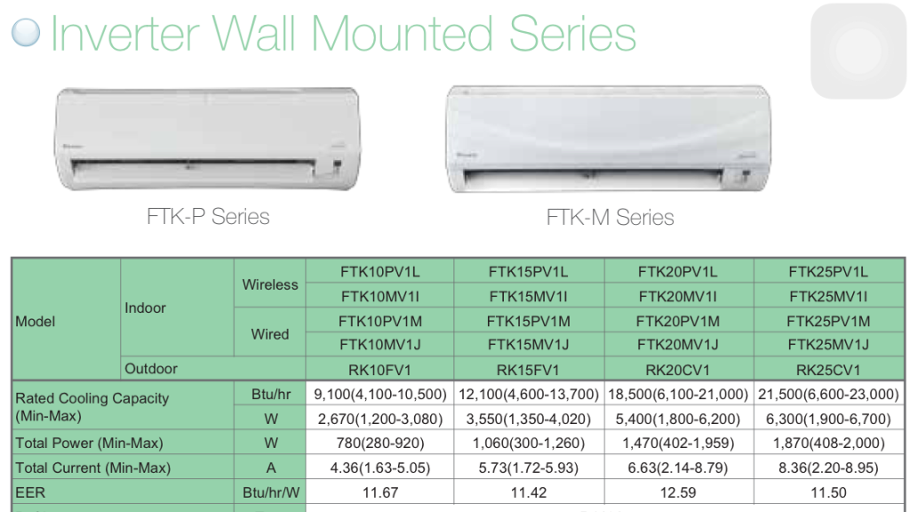

Taking the non-inverter models as a baseline, for 1HP
Daikin consumes 800W and outputs 2600W cooling capacity, that gives a ratio of 3.25
Panasonic consumes 865W and outputs 2650W cooling capacity, that gives a ratio of 3.06
Higher is better.
Once you factor in the inverter, things get a little bit more tricky, as the airconds don't always work at full power and output the same capacity
This is just a rough estimate based on the datasheet
Daikin R22: 1 HP inverter
at min consumption of 300W output should be cooling of 1200W, so max efficiency ratio is 4
at max power consumption of 1100W output should be cooling of 3200W, so efficiency is 2.9
Daikin R410a 1HP inverter
at min power consumption of 300W output should be 1200W, so max efficiency ratio is also 4
at max power consumption of 1050W output should be cooling of 3200W, so efficiency is 3.0
Panasonic R410a 1HP inverter
at min consumption of 225W output should be 840W, so max efficiency ratio is 3.7
at max power consumption of 920W output should be cooling of 3280W, so efficiency is 3.6
For inverters, it then implies that Daikins are more efficient as long as you don't turn on full blast at a super low temperature set point. Obviously if you right size your airconds, i.e., use the appropriate HP, then you wouldn't have to, because the room would be cool without a super low set point. (That's why buying the right HP for your room size is also important)
mimi1986
post Apr 18 2013, 03:39 PM
109 posts
Joined: Aug 2009
QUOTE(oe_kintaro @ Apr 18 2013, 03:13 PM)
Higher is better.
Really appreciate ur explanation above.
But the comparison above only valid for min and max output range, what's really happening in between is what really matters to conclude which inverter is more 'thermally efficient' no? Ofc like u said it's just a 'rough estimate', but these estimates seems abit weak to form a conclusion.
Seems like the Panasonic inverter cooling capacity output can go further 360W lower than the Daikin inverter at lower power consumption of 225W. Despite of the slightly higher efficiency in the Daikin in this lowest output level, if in a situation where a room is very small with excellent insulation where a cooling output of around 800W is sufficient to maintain the set temperature, then the Panasonic inverter would save more electricity rite?
This post has been edited by mimi1986: Apr 18 2013, 03:48 PM
oe_kintaro
post Apr 18 2013, 03:58 PM
2,222 posts
From: Penang
QUOTE(mimi1986 @ Apr 18 2013, 03:39 PM)
Seems like the Panasonic inverter cooling capacity output can go further 360W lower than the Daikin inverter at lower power consumption of 225W. Despite of the slightly higher efficiency in the Daikin in this lowest output level, if in a situation where a room is a very small with excellent insulation where a output of around 800W is sufficient to maintain the set temperature, then the Panasonic inverter would save more electricity rite?
I think you misunderstood a bit: you would want the cooling capacity to be HIGHER for a lower amount of electricity used, not less.
to put it simply: at lower electricity consumption, the Panasonic would also not be as cold. But having said that, if you just need 800W steady state to maintain the temperature, Panasonics will do fine. It's just that you have to shell out extra money to rip out your air-cond piping and replace them with thicker pipes to accommodate the higher working pressures of the R410A gas. If your existing pipes are in good shape, why bother? That was my rationale in choosing Daikins R22 inverter models over Panasonics. tongue.gif Don't forget too that in the event you need to refill gas during a servicing, R410A is about 3x more expensive (last I checked)

Anyway, my existing pipes is the thicker pipe for R410a so not an issue. And the quotation for installation of R410a inverter model is rm200 versus R22 inverter model rm150, so the only concern is the gas refilling cost. smile.gif
efficiency = output / input. how much you get out of what you put in. High cooling efficiency means you get more cooling out of less power used. IOW, more cold for less electricity used.
If you already have thicker pipes, then it shouldnt be an issue any more.

Hi, thanks for your recommendation. Does all model of Daikin R22 can use back the old piping? But I assume need some wiring for inverter control right?
oe_kintaro
post Apr 21 2013, 08:24 AM
2,222 posts
From: Penang
QUOTE(czlee88 @ Apr 21 2013, 12:27 AM)
Piping yes, I think can reuse, but wiring might be different. Best you check with your installer

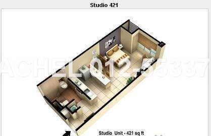

Guys how many HP air con is recommended for a 300+/- studio?
sovietmah
post May 21 2013, 09:47 AM
2,243 posts
Joined: Nov 2005
QUOTE(B u B u @ May 20 2013, 10:24 PM)
At least 2.5HP for 300sq studio.
the 300 sq is bout a big size of living room 17feet x 17 feet.
OMG serious?! I was thinking something like 1.5HP would be sufficient...
platinum_12
post May 21 2013, 09:19 PM
953 posts
Joined: Sep 2012
From: Selangor
QUOTE(B u B u @ May 21 2013, 10:05 PM)
From a few online calculator. 1hp is enough for your case provided your room is well shaded and no kitchen in it. If not take 1.5.
B u B u
post May 21 2013, 10:02 PM
chill
1,479 posts
Joined: Nov 2008
QUOTE(platinum_12 @ May 21 2013, 09:19 PM)
sovietmah
post May 22 2013, 09:48 AM
2,243 posts
Joined: Nov 2005
QUOTE(B u B u @ May 21 2013, 10:02 PM)
Seriously I don't think 1HP is enuff for you.
1HP maximum cover around room area bout 10feet x 10 feet.
So your studio is 300 sq or 421 sq?
if 300 sq, u need at least 2.0HP, summore weather is very hot around april/may.
http://aircon.boxpinoy.com/
B u B u
post May 22 2013, 04:20 PM
chill
1,479 posts
Joined: Nov 2008
QUOTE(sovietmah @ May 22 2013, 09:48 AM)
Only need to take 300sq into consideration, as the remaining (421 - 300) are the toilet and outside gate area.
platinum_12
post May 22 2013, 04:54 PM
953 posts
Joined: Sep 2012
From: Selangor
QUOTE(B u B u @ May 22 2013, 05:20 PM)
Yes. Its takes 2 hp for your case not 1 hp. Looking at your house plan, if i were you i'll install two 1 hp aircond to get better cold air distribution. But it will cost you a bit more on wiring.

Daikin Inverter (1.5HP)
FTKD35GVM (R22) - 10,900 (4,750 - 13,650)
FTKS35DVM (R410A) - 11,900 (4,750 - 13,650)
Panasonic Inverter (1.5HP)
CS-S13PKH (CU-S13PKH) ~ 1.5HP - 12,500 (3,140-14,300)
In such case, Panasonic seems to hv higher BTU as compared to Daikin's , isn't it Panasonic better?
Any brand good for a non-inverter for hall like 2.5HP or 3HP? I calculated my hall with kitchen(since is open area), if well insulated it's 24833btu, if medium insulated then is 33111btu. The balcony sliding door will be tinted and if rooms doors are close, but there will be computer in the hall, can I assume it's well insulated?

c. installation cost for normal ac
d. installation cost for inverter ac (needs thicker pipe for the higher pressure)
e. refrigerant cost - R22 (normal) & R410A (inverter)
Cleaning cost for the 2 types will be about the same as per the manufacturer.
There is an interplay between your choice of A/C brand and the 2 factors here.
i.e.: Daikin has a R22 inverter model ...if you opt for that one, you don't need a thicker pipe and don't need to use R410a, which is still more expensive.

Suggest looking at the EER numbers of the 2 ac. The higher the number the better, more efficient in converting electrical energy to cooling duty.
Once you have the EER numbers, please share with me. I am compiling a table of type, HP, price & EER.

Previously I did this back of the paper calculation based on the specs:
QUOTE
Based on my limited understanding, if you open full blast, maybe the Panasonic is more efficient, but if you don't overstress it, the Daikin is more efficient. So basically it depends on your usage pattern. Regular service difference isn't much I guess, just the gas pricing.

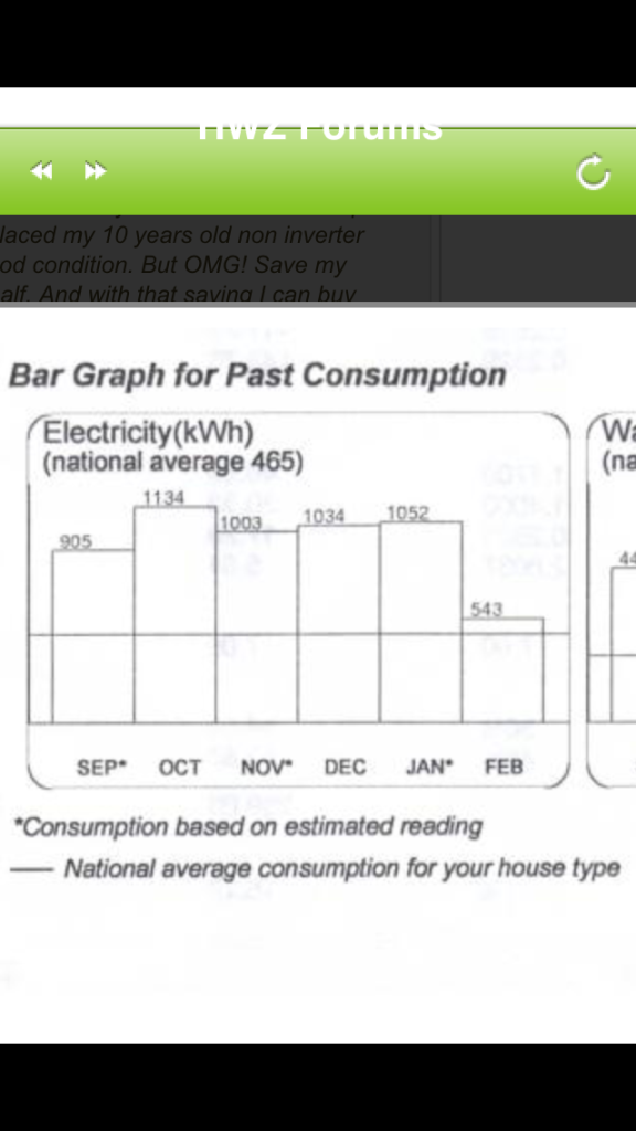

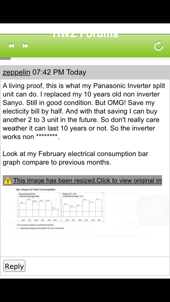

Had used a 1.5 hp aircond for almost 11 years and changed to a panasonic 1.5 hp inverter since mid August this year as electricity consumption of the earlier aircond unit was 12 kwh nightly from 10 pm to 7am at 23C. No longer efficient in power usage.
I have been tracking the new inverter aircond usage and on average it is around 6 kwh nightly for the same duration at 24C.
I am satisfied there is good savings in electricity consumption.

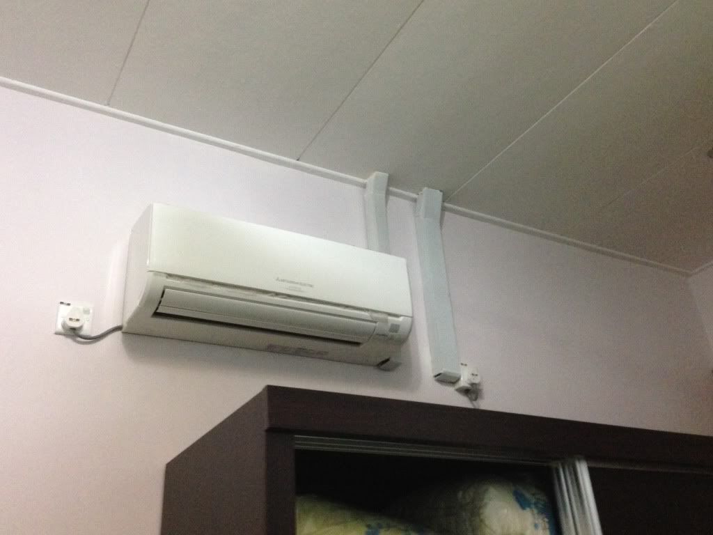

inverter air cond need 4 wire for the compressor?
weikee
post Oct 24 2013, 11:42 PM
10k Club
12,019 posts
QUOTE(dinor01 @ Oct 24 2013, 11:12 PM)
Yes minimal. Some need 5 so better check the requirement for the model you plan to buy.

Non-inverter power indoor, so the wire will tap from indoor to outdoor only.
For inverter type indoor need to connected to outdoor and power supply from outdoor to indoor socket.
Unless outdoor had built in power socket for you.

QUOTE(dinor01 @ Oct 25 2013, 09:09 AM)
Not True, copper (not used) will remain ductile for 100yrs +
is like wiring direct from DB -->outdoor compressor unit
then from compressor ->indoor..
normal one is wire frm DB->indoor unit
indoor unit--> outdoor compressor..
right?
SUSkimsim
post Oct 25 2013, 05:51 PM
Let Me ❤️ You
5,847 posts
Joined: Nov 2010
From: Malaysia 🇲🇾
QUOTE(dinor01 @ Oct 25 2013, 01:48 PM)
right?
Bingo

for living hall one a bit hard...cos compressor at upstair balcony area..damn it...other stil ok can put casing at outside wall...
damn..air cond man dun even tell me tis.. done his job n leave.......... as i never installed inverter unit b4...
wireman jus lay cable to indoor unit...follow standard way...

Ya that is commons skills.
I had the same experience, end out like it.
In living look nice without anything
At the back inside my master bedroom.
For 1 way wire from IU = indoor unit, need to add new wire to power supply only, for that consealed wall just tap from IU to Outdoor only.
Option
If wanna install inverter also can, from ID tap to Outdoor only, for Outdoor wire just direct to power supply.
To be drill and tap from anywhere nearest to Outdoor compressor.

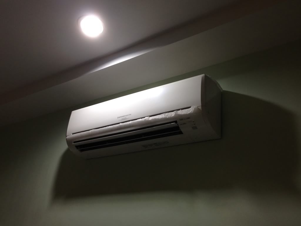

Let me show you a photo on air cond installed near to kitchen after 6 months once I back to my villa.
Then only you decide on it.

Anyone have approach contractor or aircon installer for the copper to be conseal into wall before aircon installation?
I have 3 bedroom + 1 Living room. I would like to know what is the price per feet for below:
1 HP aircond (non-inverter type) (Guestroom)
1.5 HP aircond with inverter type (master room)
2 HP for living room (Non-inverter type)
I find majority of lowyatian mention that non-inverter will use different copper right?
SUSkimsim
post Oct 30 2014, 07:46 AM
Let Me ❤️ You
5,847 posts
Joined: Nov 2010
From: Malaysia 🇲🇾
like my friend he is Aircon installer base in s'pore.
For some customers may not change thier copper pipes at all, just reused the original copper pipe n used gas to flashing an existing oil out then to be used back.
Maybe in s'pore standard copper pipes will be more thicken for Kia Su Needed.
Actually in m'sia installer here if they used the same thickness for non-inverter n used in inverter unit do you check it out?
No right if never gas leak = good installation.
Can be try to used the concealed wall of original comes with devolpment one.
Workmanship unsure they can do as much perfectly done.
Good luck
