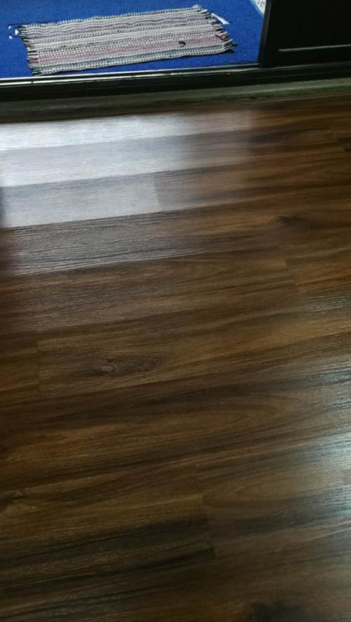

EDIT: Just realized I posted solid wood info on Laminate topic... TS if you want me to remove, pls let me know, otherwise I leave it here. Sorry for off topic
Just sharing some pricing on solid wood based on my research. One thing that stick out is the 20mm belian is really heavy. The rest weigh like cheap plywood in comparison. Really a lot to learn about all these different kind of wood
My house lighting = yellow
Left pic = without flash
Right pic = with flash
Hope you guys can see the difference
Attached Image Attached Image
Its ok.. thx for your sharing..

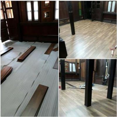

Hi, im planning to renovate my house, 20 y.o wooden house, just wanna ask whether laminate flooring can be laid on solid timber flooring..do i need to cover it with plywood first?
TSksuniconcept
post Dec 23 2015, 11:19 AM
147 posts
Joined: Oct 2013
QUOTE(SAB2811X @ Dec 23 2015, 09:48 AM)
Mean the old house now with solid timber flooring? So any issue on the solid timber flooring now? Got broken?

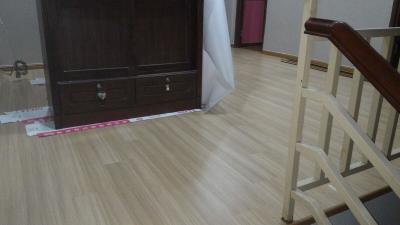

TSksuniconcept
post Dec 23 2015, 11:23 AM
147 posts
Joined: Oct 2013

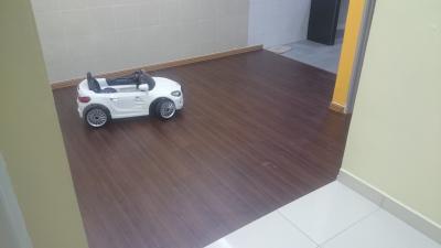

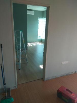

Done installed Laminate Flooring @ Semenyih
Old house look like new house now...
@This colour not bad after installed..

QUOTE(ksuniconcept @ Dec 23 2015, 11:19 AM)
actually, there is no issues at all, just trying to give a new look to my house..

QUOTE(SAB2811X @ Dec 23 2015, 03:03 PM)
Ic..then is no problem for u to lay the laminate flooring on the solid wood..

TSksuniconcept
post Dec 31 2015, 09:44 AM
147 posts
Joined: Oct 2013
Done Laminate flooring for Kitchen Area...
Finishing with PVC skirting...

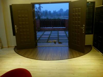

TSksuniconcept
post Jan 5 2016, 03:06 PM
147 posts
Joined: Oct 2013
Done Laminate Flooring @ Taman Hillsa ,PD.

TSksuniconcept
post Jan 11 2016, 05:28 PM
147 posts
Joined: Oct 2013
Laminate flooring work @ Banglo enstek
Full Ground Floor Hall+dining+kitchen Laminate flooring and vinyl flooring installation...

post Jan 31 2016, 04:57 PM
147 posts
Joined: Oct 2013

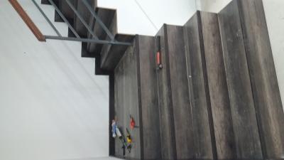

SJKC PARIT TINGGI @ Sendayan, Seremban.
Laminate Flooring Installation in Library...

Done installation...

Photos added. Price is around RM6.60 per sq ft + RM8.00 per foot run for skirting
Attached Image Attached Image Attached Image Attached Image Attached Image Attached Image Attached Image

sonerin
post Feb 29 2016, 12:10 PM
8,739 posts
Joined: Aug 2009
12mm will be better and parquet will have to be remove before install

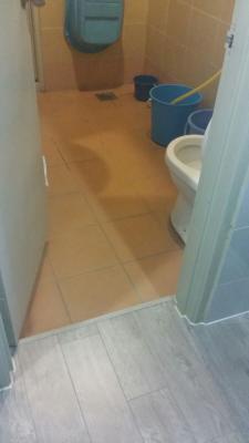

QUOTE(lunchtime @ Feb 24 2016, 05:59 PM)
Do you have any photos to show a toilet with 4G laminate?
And any comments on ionwood?
Photo for ur referenCe..

QUOTE(ksuniconcept @ Mar 3 2016, 09:58 PM)
TSksuniconcept
post Mar 4 2016, 05:44 PM
147 posts
Joined: Oct 2013
QUOTE(ah_chung @ Mar 3 2016, 04:48 PM)
No, i didn't use... at the end, i didn't change floor to my condo..
why?
TSksuniconcept
147 posts
Joined: Oct 2013
QUOTE(lunchtime @ Mar 4 2016, 12:17 AM)

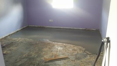

Self leveling after remove parquet..
It ensure the floor level is smooth..
TSksuniconcept
post Apr 15 2016, 05:53 PM
147 posts
Joined: Oct 2013

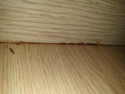

Anyone know how long actually the laminated can stay clear of termites in general or based on experience you know?
pyy
post May 11 2016, 09:57 AM
114 posts
Joined: Sep 2008
no laminate can stay clear of termites unless is WPC. Is better u do yearly check up for termites as is not only affect ur floor it will affect your roof, furniture and all thats. and one time check is 50 bux, so is well worth it.
Zot
post May 11 2016, 11:11 AM
7,938 posts
Joined: Mar 2014
QUOTE(pyy @ May 11 2016, 09:57 AM)
What you meant by acronym WPC?
pyy
post May 11 2016, 11:18 AM
114 posts
Joined: Sep 2008
Wpc = wood plastic composite
Half wood half plastic
But is not recommended since it is plastic and plastic have degradation which is bad for health
Zot
post May 11 2016, 11:37 AM
7,938 posts
Joined: Mar 2014
QUOTE(pyy @ May 11 2016, 11:18 AM)
I have this laminated floor, can't recall what brand it is, that has been "termited". It was not supposed to, not at least for 20 years, but it was. I don't think it is WPC though.
Actually, this is located at the kitchen floor but it is not the waterproof type, There was a pipe burst and it was flooding all over the floor. I did not get it replaced for few years blush.gif and it just dried up naturally. The inter-locking design is not good that panels are not latched together properly. Once the panels expand and shrink they will leave a bit of gaps.
I'm looking for the water-proof type which I know only Floor Depot has it. I guess the termite issue most likely because of the boards were soaked with water and lost their termite-proof property. What do you think?
Looks like termites go through the concrete wall cracks and also wiring. I had those cracks around the house poured with termite poison already and also at two sockets that caused power trip. So far looks okay hmm.gif Need to check from time to time. The roof frame is metal, so not worry there.

TSksuniconcept
post Jun 20 2016, 02:22 PM
147 posts
Joined: Oct 2013
Inovar laminate flooring installation at semenyih***
This color is nice and popular..

Banglo laminate flooring installation..
Full using Innovar laminate floor except ground floor.. 👍👍👍

Vinyl floor installation for opening soon cafe...
Job done😀😀😀

TSksuniconcept
post Jul 11 2016, 11:41 AM
147 posts
Joined: Oct 2013
Laminate floor before and after installation..

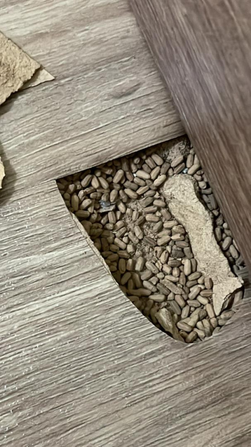

post Oct 17 2016, 11:30 AM
384 posts
Joined: Dec 2005
hi, looking for laminate skirting replacement (prefer plastic or pvc type), dun wan mdfboard type
my skirtings have been aten up by termites few months back, now after termite baiting process, it is gone (i think)
hence looking to replace damaged skirtings, basically whole 1st floor of a 24x80 house (except masterbedroom wardrobe area, as the wardrobe alrd fixed there and can be moved)
below sample pic of the type of skirting i previously have, after removing some of it, noticed the gap left on the floor is not consistent accross all places
pls suggest the many appropriate replacement and where to get those & price
suprisingly the other type of snap on low skirting was not impacted, i suspect it maybe the material is plastic, but with the gaps left on the other skirtings, not sure can buy this to replace, any advice??

TSksuniconcept
post Apr 7 2017, 11:17 AM
147 posts
Joined: Oct 2013
Installation of Inovar flooring today😊

TSksuniconcept
post Apr 7 2017, 04:48 PM
147 posts
Joined: Oct 2013
QUOTE(okhui26 @ Apr 7 2017, 11:27 AM)
To install the skirting need to remove the tile ah?
Can we install the skirting without remove the tile?
Have to remove tiles skirting..

TSksuniconcept
post Apr 30 2017, 12:06 PM
147 posts
Joined: Oct 2013
Inovar flooring portfolio👏👏👏
rizts
post May 7 2017, 07:19 PM
46 posts
Joined: Oct 2007
Robina timber flooring nightmares.
I thought it is easy installation.. but it is not.
Very very difficult to lock the timber floor together. Regret using this Robina timber flooring.
2 days still cannot finish intallation
Anyone one can help?Attached Image

TSksuniconcept
post May 8 2017, 11:43 AM
147 posts
Joined: Oct 2013
QUOTE(rizts @ May 7 2017, 07:19 PM)
U are owner? U buy urself and install by urself?

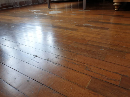

Planning to do something on my parquet floor in all my bedrooms as some parquet are flipping out and it is very annoying.
Can I still do laminate floor with my furniture inside (bed, wardrobe, table)?
Need to remove parquet and install laminate or can just install on top of it?
Currently some parquet are flipping and abit scratch, other than that, no other complaint.
What r the charges and estimated time to complete?
Thanks in advance

QUOTE(akky @ May 8 2017, 05:53 PM)
Hi all,
Thanks in advance
Based on your description on your parquet condition, you can install laminate right on top of it.
Furniture needs to be placed to one side and installed section by section. .
Pm you charges and time to complete.

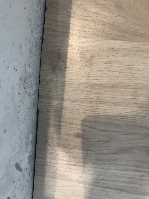

post Aug 22 2017, 06:53 PM
19 posts
Joined: Jun 2016
Hi,
I installed a laminate flooring (inovar) in less than 8 months and now I can see a lot of gaps in between the planks. Is this normal?
The gaps appear on both the long and short side of the planks.
Zot
post Aug 22 2017, 08:05 PM
7,938 posts
Joined: Mar 2014
QUOTE(propnoob @ Aug 22 2017, 06:53 PM)
Hi,
what brand is that? This is not normal. Should be under warranty, right?
sidq
post Aug 22 2017, 08:33 PM
113 posts
Joined: Aug 2010
Inovar but the sales person said it is normal since the planks will expand over time. So far the largest gap is almost 1mm but my main concern is too many gaps. I think probably around 30-40 gaps.
Im still under warranty

Zot
post Aug 23 2017, 08:14 AM
7,938 posts
Joined: Mar 2014
QUOTE(sidq @ Aug 22 2017, 08:33 PM)
I don't know much about Inovar. Each piece is interlocked to each other. For me, 1mm gap is visible and not acceptable. The expansion gap is hidden under skirting at the wall about the thickness of the plank itself or 1/4". The floor panels should expand and shrink due to change of temperature day and night and should push and pull each other leaving no gap.
There are manufacturers spec for their product such as how long the laminated floor can span before needing expansion gap, which they need to use T profile. The distance is different for long and short end, like 40' for long end and 20' for short end. If not the interlocking will not work properly leaving gaps.
My floor is already 10 years and no such problem except noticeable (about 1mm) gap on small area exposed to rain all day long while I was at work because I forgot to close the window but that was 8 years ago perhaps laugh.gif . Mine is no big name local brand. I'm trying to recall the name hmm.gif
This is my experience and I don't know much about others. Perhaps anyone using Inovar can tell theirs

is it bad?

QUOTE(propnoob @ Aug 30 2017, 03:20 PM)
is it bad?
The first top two pictures are not acceptable for me.
The others though not that bad but it was caused by poor installation. Some cases, the plank itself defect such as it curved a bit but that is not your problem. They need to replace. In some cases, the installer did not align the plank straight thus causing a bit of gap on one end.

QUOTE(Zot @ Aug 30 2017, 04:03 PM)
is it easy to fix these kinda gaps?
will it cause any problem in the future? i contacted them already. waiting for them to come and fix this.

Installation of laminate flooring @ Kampung House

QUOTE(watabakiu @ Jun 13 2019, 04:26 PM)
Is it true that laminate requires door hacking, due to thickness?
Well, it is not really "hacking". When the laminated floor panel is laid on the floor, the floor height increased by 6mm for example. So, the gap between door railing and existing floor will close up.
If you have just plain plywood door inside house like this
they just need to remove the thin railing at the bottom. Normally can be done using screw driver and a hammer. Probably 20 min job the most. If you have solid wood door, then need to cut with circular saw, but then the installer will do laugh.gif
My house, the installer have to remove the door, take outside and trim the door. (This additional charge)

Hi need some opinion from those who have installed laminated flooring before. The installation at my staircase and the whole of upper floor is completed just now. For staircases, I only chose to install it on the treat (where we step on). There is a noticeable gap between the end of the flooring with the staircase's riser. I highlighted this issue to the salesperson. He told me it's because my riser is not 90 degrees enough and their installer did cut the flooring in a straight line. He instead asked me to get people to touch up the riser by applying ASG and paint it over. Is this a normal practice when it comes to laminated flooring on staircase?
Zot
post Dec 4 2019, 05:07 PM
7,938 posts
Joined: Mar 2014
QUOTE(kayciekc @ Dec 4 2019, 04:48 PM)
Normally the installer just fill it with silicon glue of same color with the floor. I don't have floor board on stairs but surround the cut for the handrail anchor, they applied wood color glue matching my floor board.
kayciekc
post Dec 4 2019, 05:37 PM
69 posts
Joined: Jul 2012
QUOTE(Zot @ Dec 4 2019, 05:07 PM)
[/spoiler]
Thanks for sharing your experience. For my case, every single step has a gap from one end to the other hence it will be too much silicone to apply and may affect the aesthetic look of it
Zot
post Dec 4 2019, 05:44 PM
7,938 posts
Joined: Mar 2014
QUOTE(kayciekc @ Dec 4 2019, 05:37 PM)
You can glue a strip thick enough to cover the gap, but then if the strip is flexible, it can still show noticeable wavery. If the strip if rigid, then the strip itself showing gap laugh.gif
You have white stairs (marble?) there, I'd just fill with white silicone and will not be noticeable. Most important is your reference line is straight floor board. The problem is the edge to the wall, not same length. Need to trim to make it even. Probably need to put skirting there.
pyy
post Dec 9 2019, 09:54 AM
114 posts
Joined: Sep 2008
a colour silicon will do the job

StuartLee2015
post Apr 1 2020, 12:41 AM
1,221 posts
Joined: Sep 2014
From: Malaysia
Anyone what's those thing ?
it keep coming out of those seams...... and it's unsightly
How do i fix this ?
StuartLee2015
post Apr 22 2020, 03:41 AM
1,221 posts
Joined: Sep 2014
From: Malaysia
Is this thread still active? I still having ' moisture build up ' and condensed into water and coming out of the seams between floor and side cover ( not sure what's called )....
Zot
post Apr 22 2020, 07:53 AM
7,938 posts
Joined: Mar 2014
QUOTE(StuartLee2015 @ Apr 22 2020, 03:41 AM)
Was that the previous picture? I was thinking of rotting but did not comment since not sure if it was something else smile.gif
The first thing that you need to do is to find out what is the cause of condensation. It looks like there is leakage somewhere. What is behind the wall? Is there bathroom?
No point to repair the flooring if the cause is not solved.
StuartLee2015
post Apr 22 2020, 06:00 PM
1,221 posts
Joined: Sep 2014
From: Malaysia
QUOTE(Zot @ Apr 22 2020, 07:53 AM)
Theres a bedroom behind the wall. I guess is humidity from the subfloor?
Zot
post Apr 22 2020, 09:11 PM
7,938 posts
Joined: Mar 2014
QUOTE(StuartLee2015 @ Apr 22 2020, 06:00 PM)
Normally before they lay the laminated floor, a plastic layer is laid and the foam sheet as sound absorber.
When I got my laminated floor replaced, the plastic was like a bit sticky and damp but that was not the under side. The flooring board was still fine.
StuartLee2015
post Apr 23 2020, 02:01 AM
1,221 posts
Joined: Sep 2014
From: Malaysia
QUOTE(Zot @ Apr 22 2020, 09:11 PM)
What about the seams between the flooring plank and side cover? Mine seems to ooze water...
> is yours tile/marble?
There's a foam sheet ( white ) when i laid mine last November.... SPC on top, foam underneath only... no plastic sheet or anything....
Only rooms has this kind of problem.... Outside where Living room and dining hall is dry. no sign of water condensation...
If i slit a paper between the seams, the paper is wet.... confused.gif , I got a video recorded... to show to the Installer when he comes after MCO.
Could this be humidity that comes from subfloor ?
> My furniture ( 3 tier shelf ) most bottom part where it's kissing floor shown signs of water damage , not because of mop ( super careful when moping on not touching it ), that was before laying SPC flooring... when it was still marble floor, and that particular area always feel kind of cold to touch.
Now i drill some holes on the side cover to let it breath, hahaha.... I tried to seal it with silicone, but then the water ooze out from the plank ( near the side cover where the foam didn't cover that plank's edge near to the wall ) , is my guess...
This post has been edited by StuartLee2015: Apr 23 2020, 02:02 AM
Zot
post Apr 23 2020, 07:55 AM
7,938 posts
Joined: Mar 2014
QUOTE(StuartLee2015 @ Apr 23 2020, 02:01 AM)
I wonder what makes the floor wet.Like humidity high but should not cause this. Seems like that the hall or the other side of the wall is much colder all the time but hot room laugh.gif
I have no idea what cause it. Let's see what the contractor say.

The solid timber flooring for my near 10yo house is peeling here and there. It use to be those smooth matte finish.
Is it possible to renew it back to like-new condition? What are the better options?
Thanks
Thanks
I think it will be sanded by machine, filling gaps and varnished again.

Necroing thread because I went with a new type of 8mm laminate floor product. It was more expensive than the SPC that I was originally looking for but the core is made from charcoal fibre + bamboo fibre. So chose it because after numerous threads of seeing SPC from other users having issues a few years down the line.
The salesman guaranteed us it was waterproof and even threw in a free upgrade to EVA underlay. Had a sample soaking in water for a week to show us. Price was RM11.90/sqft but we decided on RM14.90/sqft which included the concrete leveling to be done by them. Hopefully it will last.

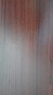

Secret_Garden
post Aug 19 2024, 01:31 PM
199 posts
Joined: Apr 2006
Hi Anyone encountered this kind of problem before? The laminated flooring became like this. the core of the laminated flooring became small particles of wood.
This post has been edited by Secret_Garden: Aug 19 2024, 01:31 PM
iconic123
post Jan 20 2025, 01:09 PM
52 posts
Joined: Sep 2012
Hi tenant left my floor like this, is it possible to be fixed?
