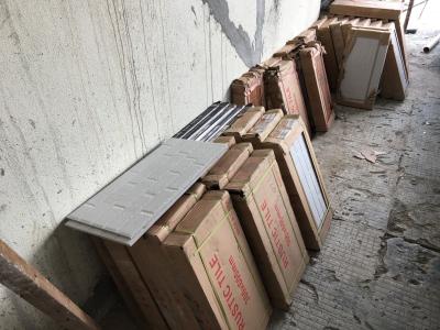

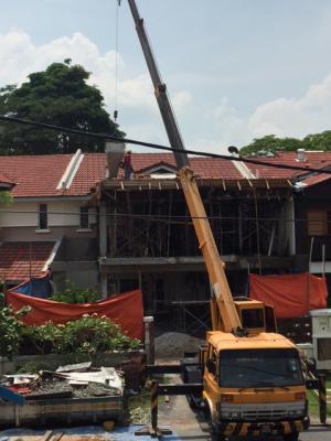

Going to start renovation journey starting today. Lots of equipment had just been unloaded and work is about to begin.
Is going to be a 6 months long journey, hopefully to be shorter as possible. Well will start posting some pics up soon.

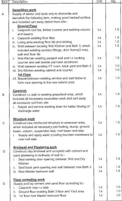

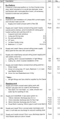

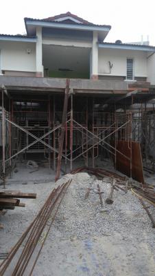

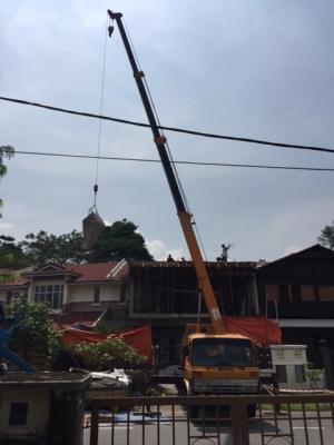

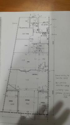

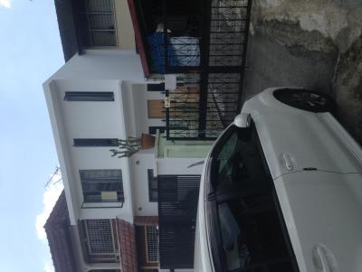

This is what has been done so far for day 1. Removing of the roof in the car porch. Today will be continuing of demolition work on the car porch. Will see more progress after work.
Below are the list of items for the whole reno work for wet work and the structure of the house. Interior is still searching for a contractor.
Rough sketch up on the extension and changes to some of rooms.

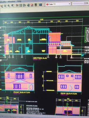

Architect drawing.

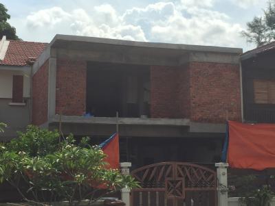

Walao, your neighbour do extension till like that?
You gave approval?

QUOTE(ckseong80 @ Dec 10 2015, 03:50 PM)
You gave approval?
Well by law, there is no need neighbour to approve but you need majlis perbandaran to approve.

Really? Im living in MBPJ and theres a neighbor doing major reno, from bungalow to double storey bunglow with pool. We got a letter from MBPJ seeking approval from neighbours within 20m radius.
I think this should he the correct procedure unless the reno is not extending beyond original plan.

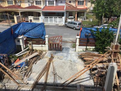

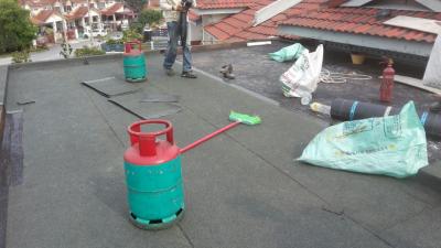

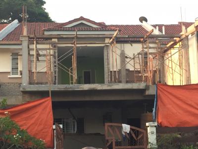

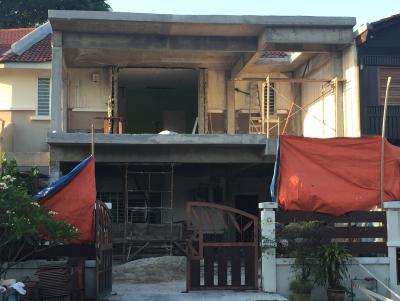

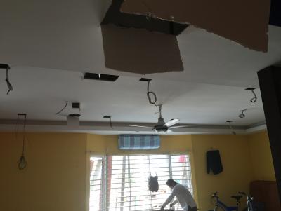

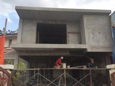

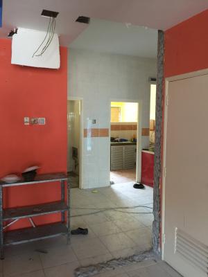

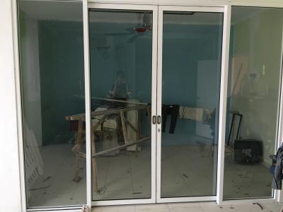

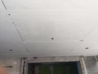

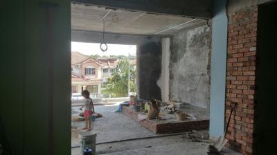

Finally had a chance to do some update after 1 week. Things had been progressing well even with this raining weather. Well is not even 1/10 of the work, very long more to go.
Piping for water to drain from the roof.
Wood casting to be ready for the pillar of new extension.
Another pillar on the opposite side.

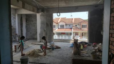

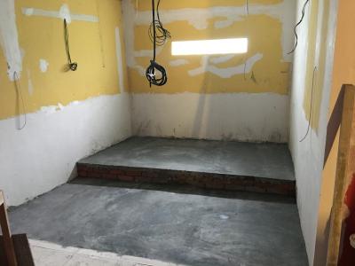

My personal favourite, extended room for my new home theater a.k.a (man cave)

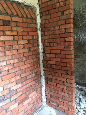

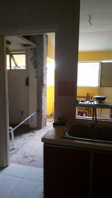

Wall hack down for the dry kitchen.
Wiring for 3 phase had just begun.
Upstairs view to be soon new extension of the master bedroom + balcony.

Envy your man cave... For me, I have to sacrifice 1 bedroom to convert into... "Study/work purposes" (term to use in front of gf)... So, only left 1 guest bedroom.

Don't say that, for me I don't have guest bedroom at all.

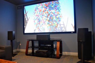

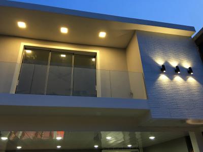

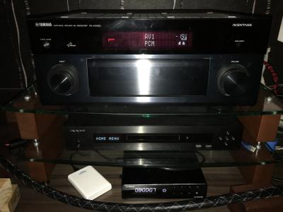

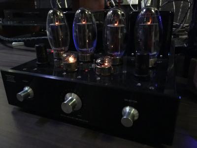

Attached Image Attached Image

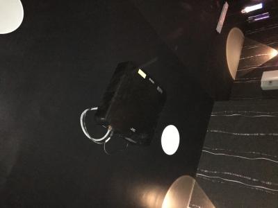

how about this ...

I would complain if my neighbour did that - block all the wind into my house. And probably made the house darker as well.

Yeah this is nice.

Quick update of the continue demolishing workAttached Image
This post has been edited by sonerin: Dec 22 2015, 10:16 AM

Today started the upper floor extension.
More walls being knock down to relocate the toilet
View from my master bed room. The platform is to be mould for the extension flooring

Been 2 weeks and had completed the floor of the new extension for master bedroom. Living room all the tiles are hacked. The demolish work for the toilet is almost done. Wet kitchen is stil in the midst of demolishing.

New toilet door
Wall building up in between wet and dry kitchen.
New walk way from dry to wet kitchen.
Extension of my man cave is completed. Need to finish up the plastering of the wall and floor.

Upper floor extension with column just done with putting in the concrete. Now waiting for it to dry

Raise floor for the HT room
Upper floor extension continue. The concrete roof is coming up.

Brick up the gaps as the height of my car porch is much taller now.
Adding new meter for 3 phase
New fuse box.
Crane arrive to lift the concrete up to the roof
Cement mixer
Pouring out the cement into the backet to be lifted up to the roof.
Going up.
Putting it in.

Ground floor plan after Reno

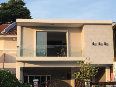

Finally the front structure extension is completed. Now waiting for the brick walls to go up.

lookin good. got any 3D render?

Unfortunately I don't have that as this is not design by those ID.

Finally walls are coming up.

Its amazing that you can take snap-shots of the progress.... almost like building a lego. rclxms.gif

Plaster ceiling just finished, started painting. Next in line will be carpentry... All things almost went up by 20-30%, very heart pain... cry.gif

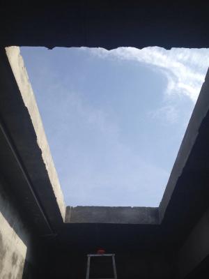

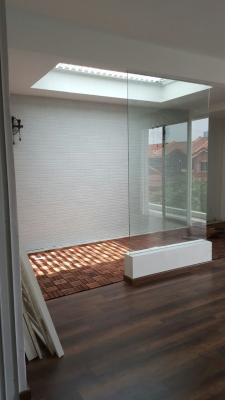

Skylight for master bedroom. Internal wall cement plastering is completed. Now waiting to complete the external walls.
This post has been edited by sonerin: Feb 13 2016, 03:47 PM

QUOTE(sonerin @ Feb 13 2016, 03:47 PM)
Won't too much sunlight be coming into the room ?
TSsonerin
post Feb 13 2016, 08:55 PM
8,738 posts
Joined: Aug 2009
Yes have to have bigger budget to everything or else will always have to think again what to do. The skylight is 8 feet X 4 feet. Is actually very small as the room is 520 sq feet. Anyway will have openable roof system for the skylight. Is up to me control how much light to come in

I am thinking the same thing for my master room.
Natural sunlight - save electricity. Mine plan to go down to G-floor.
Kinda like skylight tube.
Only concern - if burglar come from roof - how if no grill?
What kind of tempered glass are u using, and how do you control amount of light comes in? (manual?)
TSsonerin
post Feb 19 2016, 07:15 AM
8,738 posts
Joined: Aug 2009
QUOTE(loginet @ Feb 18 2016, 11:38 PM)
I had fixed motorized louvers. So I can control if want sunlight to come in or not

Liking the skylight, thumbs up

Really nice and good progress...
bro u have idea how to clean it, bird poop poop not gooding

Maybe can angle slightly (not sure if possible) then when rain at least can cuci a bit tongue.gif
TSsonerin
post Feb 19 2016, 02:46 PM
8,738 posts
Joined: Aug 2009
QUOTE(phoenixxx @ Feb 19 2016, 02:34 PM)
That is a good idea. Will do that

the roof-glass is gonna be a nightmare after a while.. watermark.. bird poo poo etc..
TSsonerin
post Feb 22 2016, 01:57 PM
8,738 posts
Joined: Aug 2009
QUOTE(Sky.Live @ Feb 22 2016, 01:52 PM)
That is true. Will need maintenance for sure
Sky.Live
post Feb 22 2016, 03:45 PM
Proctected Species
4,390 posts
Joined: Oct 2004
From: Cheras, Malaysia
QUOTE(sonerin @ Feb 22 2016, 01:57 PM)
Plan for service route, many people ignore this, how to place ladder, accessibility and safety line.
I foresee in near future we going to be like in the west, many of the repair needs to by DIY because hiring a contractor is going to be too pricey. I realise that when I did my window cleaning before CNY
TSsonerin
post Feb 22 2016, 03:56 PM
8,738 posts
Joined: Aug 2009
QUOTE(Sky.Live @ Feb 22 2016, 03:45 PM)
Totally agree with you

I'm still in planning stage to extend my front porch, to take up 2 storey.
This is same with all neighbours like this sample.
Question, if i do a staircase to the roof, and make it a chill area, without any structure, is it legal?
Does that need MBPJ approval?
TSsonerin
post Feb 23 2016, 09:02 PM
8,738 posts
Joined: Aug 2009
QUOTE(loginet @ Feb 23 2016, 08:49 PM)
Not sure but I will think it won't be approve

The openable louvers for the skylight. It comes with remote.
Skylight will be covered with glass when its complete.

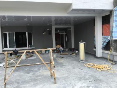

Outside is almost done, just some final touch up and is ready for paiting.
Raise platform for king size bed. Save cost, dont have to buy bedframe. biggrin.gif

i have 2 sky light at home. I notice that the one with some angle (says 30 degree) has less watermark/dust than the one which is flat
TSsonerin
post Mar 9 2016, 11:09 AM
8,738 posts
Joined: Aug 2009
QUOTE(kiwijuice @ Mar 9 2016, 10:55 AM)
True. Need some angle if not water stain

Plaster ceiling up.

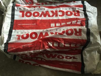

Home Theater room with rock wool inside the ceiling. The frame of the ceiling is build from wood.
Rock Wool
Aluminium profile for car porch roof.
Finally almost all ceiling done. Now is mainly left the floor tiling and some tiling for walls. rolleyes.gif
This post has been edited by sonerin: Mar 13 2016, 01:32 PM

Finally tiles arrived. Should start tiling next week.

Water proofing for the flat roof.

can i ask, where you got your tiles. Any design ideas given by the tiles guy for the tiling work.
TSsonerin
post Mar 26 2016, 06:27 AM
8,738 posts
Joined: Aug 2009
I bought my tiles in puchong. Home Delux. Not exactly design ideas but he does advice on how best to put it with the tiles I bought
loginet
post Mar 26 2016, 11:37 PM
50 posts
Joined: Jul 2008
yeah... keep the updates coming bro. Home Delux pricing ok ga?
TSsonerin
post Mar 27 2016, 07:14 AM
8,738 posts
Joined: Aug 2009
QUOTE(loginet @ Mar 26 2016, 11:37 PM)
Yes it is very cheap but is also 2nd grade tiles. It's pretty ok for me. In fact nothing to complaint since for the price RM2.90 per piece of tile of 1x2. Will take some photos next week and post

One major blunder of my renovation. Bad workmanship on the metal ceiling.

Aiyo yo.... what happened?

Trusted the guy so ended like this. The company name is ZE Metal.

same guy that always advertise here in the forum?
just ask them to replace one panel they not willing?
even use can opener also much cleaner than this jagged edge hole they made

QUOTE(sonerin @ Mar 24 2016, 09:35 AM)
What kind of material you using?
The joining will leak?

Yeah is the guy that advertise here. Talk like they are the best with cheap price and this is the result.

QUOTE(ozak @ Apr 7 2016, 08:55 AM)
Some kind of composite aluminium

Probably ask him to glue another metal sheet same color to cover that eye sore hole.

Well he had ignore my call. He said I am his first customer and he is from Penang. So I become first victim

looks like he doesnt have the proper tools to open hole

He making such ceiling and should be pro in open a hole.

you know la, everything here in bolehland is half bucket wan
hire inexperienced workers, never use proper tools, etc
sigh...If I, i wont pay the last payment
even plaster ceiling also difficult for these people to open

It is strange that they do ceiling and open hole for lighting is like compulsory and almost every project sure have 1.
But still cannot master it.

Not sure if mine is his project in Malaysia but indeed is very inexperience. Had to come 3 times just for measurement

Why you want to put a metal for the ceiling?
Any problem later when heat/cold cause the metal expand/retract and cracking sound comeout ? It is very common for the alu awning.
Another is the radiation heat from the concrete transfer to the metal or from the light. If the light heat is high, the surrounding metal paint will change color to yellowish burn mark overtime.

Well aluminium good quality will last. So I hope this will.

He should have use grinder cutter to open the hole.

Or invest in a mini grinder for better refine workmanship.

Skylight with the glass now install. Waiting for motorized louvers to be install next week.
Glass partition in between the skylight and the bed.

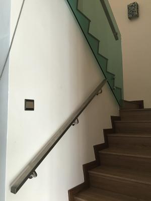

Glass railing installed for the balcony. Waiting for the hand rail to complete it.
Sliding door installed for the walk in wardrobe.
Front view.
Back view

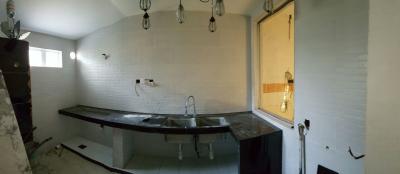

Wet kitchen completed the tiling

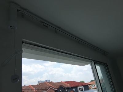

post Apr 14 2016, 04:50 PM
8,738 posts
Joined: Aug 2009
Motorized curtain installed.

QUOTE(sonerin @ Mar 9 2016, 10:17 AM)

Can the motor and wire hide out?
It is more neat.
TSsonerin
post Apr 17 2016, 01:06 PM
8,738 posts
Joined: Aug 2009
QUOTE(ozak @ Apr 16 2016, 08:52 PM)
It is more neat.
Yes. Later once the curtain is up it won't be seen anymore.
Car porch tiling completed. (Guocera 1 x 2 tiles)
Interior floor tiles completed. (Niro 3 x 3 tiles).
New toilet door.
Now the main thing left is the wall paper for all interior and Laminate flooring.

Almost done. Gate just install yesterday

The left side part (where the ladder is), what is it for? Do you plan to install skylight there? Also, your grey fencing, is it wood or metal? Looks nice.
This post has been edited by phoenixxx: Apr 25 2016, 11:17 AM
lanrambai
post Apr 25 2016, 11:38 AM
95 posts
Joined: Nov 2013
Actually what is the original size of the house lot? 24' x 80'?
TSsonerin
post Apr 25 2016, 03:28 PM
8,738 posts
Joined: Aug 2009
QUOTE(phoenixxx @ Apr 25 2016, 11:16 AM)
Oh not sure if I want to do anything like skylight. At the bottom will be a fish pond. The fencing is all wood

Lights bought from taobao

Some of the lights had just installed

QUOTE(sonerin @ Dec 9 2015, 11:00 AM)
Architect drawing.
why all lum sum?
TSsonerin
post Apr 29 2016, 08:39 PM
8,738 posts
Joined: Aug 2009
QUOTE(JapanKid89 @ Apr 29 2016, 02:47 PM)
why all lum sum?
What you mean lump sum ?

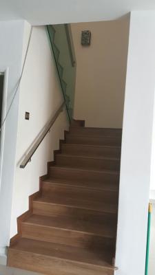

Staircase with glass railing.
Flooring is done

Really turning out well. Nice bro

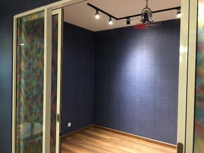

Children room
Indoor garden
Walk in wardrobe

QUOTE(sonerin @ May 10 2016, 08:19 PM)
Walk in wardrobe
The sliding door got bottom track or not? How much is the price...sliding and fix glass.
TSsonerin
post May 10 2016, 09:11 PM
8,738 posts
Joined: Aug 2009
QUOTE(lanrambai @ May 10 2016, 08:28 PM)
No bottom track. Is about 4K+ don't remember the exact price

My HT room is now done. Finally got to move back into the house after nearly six months.

bro, how did you do your speaker wiring for the audio room. is it a good idea to prepare the wiring going through ceiling for back speakers?
currently i am using a pair of B&W CM1 & yamaha (forgot what model) for back speakers, wires everywhere in my living room.
in the future (new house) I plan to convert the CM1 into back speakers and get a floor / freestanding full sized speakers for the front. currently i'm just thinking of preparing a ledge near the ceiling (along with wiring coming down from ceiling) that can accommodate the CM1 but wonder if there's any better way to do it

Yes I conceal the wiring inside the wall as like normal electric wiring for all 4 surround speakers. As I have ceiling speakers still, so practically all wires will be through ceiling to go to the front of the room where the screen is to connect to the AVR. I wall mount all surround speakers. If you look at the 2nd pic I posted on the room, you can see White color wire coming out from the wall. That is the speaker wire

Thanks. any specific cable type/brand I should look out for that can withstand being stuck in the wall or just any cable will do?

I am using OXYGEN cable is from UK. Is about RM9 per meter. Good quality
where u get this? how much?

http://www.crystalace.com.my
I think I paid about RM2k for it

QUOTE(sonerin @ Apr 6 2016, 06:56 PM)
Wow, I am SO glad I didn't rush into my renovation last year! Just came across your post today and you've done many of the things I've been thinking of doing but I didn't have a clue how to do.... May I ask where the metal ceiling is and why you decided to go with metal? Also, the front of your house looks wonderful! So nice and clean, the lines. May I ask if you used an interior designer or architect? Hope you've settled into your very creative house now and that you and your family are enjoying it.

You mean the white metal ceiling ? That is the car porch area. I didn't hire any professional to do any of it but just a contractor that I trust and I plan everything out. Practically all is done by myself and my wife. The contractor just carry out the work and provide technical spec of the house build

Does the car porch get hot because if the metal ceiling? Sorry to bug with all these questions! I have a nightmare of a porch roof that's leaking like crazy. One more question: Would you mind sharing your contractor's contact with me, please?

Not hotter than usual. Is just same as any other car porch ceiling. Anyway the metal ceiling company is really not good. Is my contractor. I found him online. The work done was not good. I won't recommend. I will send you my contractor number

wow..whole house is it?
include the curtain?

This is just 1 railing for the sliding door exclude curtain.

First time in use since moved in. Bosch hood and hob

Know you got the walk in closet. Do you mind to share how's the dimension? Hows the design? Any pictures share?
TSsonerin
post Jun 21 2016, 07:12 AM
8,738 posts
Joined: Aug 2009
QUOTE(rickk @ Jun 21 2016, 12:05 AM)
Finally read through all man!
I just buy the IKEA stolmen and I install myself. The dimension is 10 feet X 20 feet
Children room
Indoor garden
Walk in wardrobe
may i know where did u buy the white timber door? how much?

Hello,
May I know where you bought the hob and hood? and the price range.
Thank you.

QUOTE(nycx_12 @ Jul 18 2016, 10:57 AM)
Hello,
Thank you.
Bought it at Harvey Norman. I think is RM3500 for both. I dont remember the model. Is Bosch

QUOTE(sonerin @ Jul 18 2016, 11:47 AM)
Noted, thank Sir.
Hows the performance?
This post has been edited by nycx_12: Jul 19 2016, 10:33 AM
TSsonerin
post Jul 19 2016, 10:50 AM
8,738 posts
Joined: Aug 2009
QUOTE(nycx_12 @ Jul 19 2016, 10:32 AM)
Noted, thank Sir.
So far so good.

QUOTE(sonerin @ Jun 18 2016, 05:03 PM)
Sonerin,
Those brick tiles if not wrong, it was about rm2.90/pc right? Bought them at home delux puchong? Can i have the exact location pls? Can't seems to be able to google it, thanks

QUOTE(arrsoo @ Jul 28 2016, 04:50 PM)
Sonerin,
Yes is RM2.90. From Delux home. Is after the Puchong / Cyberjaya toll. The tile is no longer available as is clearance stock tiles.

QUOTE(sonerin @ Jul 28 2016, 05:01 PM)
Thanks for the info, will try check with them

QUOTE(arrsoo @ Jul 28 2016, 05:31 PM)
Infact, I didn't have enough. In the end, have to get some other to mix in.

nice house renovation!
Can share about the waterprofing works i.e cost, type etc
How's the quality?
Looking to do some waterprofing works...thx

QUOTE(siauann @ Jul 29 2016, 01:05 PM)
What do you like to know ?

Not sure how much as is bundle in with the extension cost. It's very good water proofing and is expensive I will say

Normal method of using sika, injection etc need to reapply after say 5yrs as it degraded.
Hope u can give feedback after few yrs.

For mine is using sika and some kind of oil cloth. They use blowtorch to burn it on the roof

QUOTE(sonerin @ Jul 29 2016, 05:34 PM)
TSsonerin
post Aug 1 2016, 06:41 PM
8,738 posts
Joined: Aug 2009
QUOTE(siauann @ Aug 1 2016, 03:41 PM)
Projector - JVC X5000
Screen - grandview 106"
AVR - Yamaha A3050
Tube amp - MP501 with KT150 power tube.
Front - B&W CM8
Center - B&W CMC
Sub - PB13U
Surround -DLS X 4
In ceiling - DLS X 4
Front speaker cable - Vermouth black pearl
Center speaker cable - XLO biwire
Surround and in ceiling cable - Oxygen
Interconnect - XLO ultra RCA
Power cable - VDH mainstream hybrid
- ohno cable
- XLO reference
Generally this is the equipment. Have few more small items I am lazy to list

Bro you have a nice modern house and i am freaking like it your sound system, mind to share with us your sound system cost? I feel happy after viewing your post and thank you.
TSsonerin
post Apr 19 2017, 09:20 PM
8,738 posts
Joined: Aug 2009
QUOTE(babygrand123 @ Apr 19 2017, 01:36 PM)
Thanks. I am assuming you asking about the price on speaker and amp price. I can't really remember but is about RM30k

Bro, the wall in your under the sunroof, is it tiles? what kind of tiles is that? interested in it. How much does it cost actually?
TSsonerin
post Apr 20 2017, 09:49 AM
8,738 posts
Joined: Aug 2009
Yes is just some normal wall tiles. Is quite cheap, if I remember is about RM1.90 per piece
Hi thanks for all the sharings. May I know which company did u hire to perform this waterproofing jobs? Roughly how much did u spend on this waterproofing project? Is the cost calculated based in square feet too? How much cost per square feet? Thanks again to u.
TSsonerin
post Jun 18 2017, 08:51 PM
8,738 posts
Joined: Aug 2009
QUOTE(hsunl @ Jun 18 2017, 05:04 PM)
I just ask my main con to do everything for as a package. Don't know the exact price

I'm interested to see what kind of door you use for your wet kitchen platform
TSsonerin
post Sep 17 2017, 10:12 AM
8,738 posts
Joined: Aug 2009
The doors are full aluminium
sonypshomer
post Sep 17 2017, 10:30 AM
1,594 posts
Joined: Aug 2017
QUOTE(sonerin @ Sep 17 2017, 10:12 AM)
Can those creepy crawlers go in through those ventilation louvres?
Usually we can find them inside these cabinets, excessive cooking without thorough cleaning is the cause, especially when there is a source of water.
This post has been edited by sonypshomer: Sep 17 2017, 10:31 AM
TSsonerin
post Sep 17 2017, 11:21 AM
8,738 posts
Joined: Aug 2009
QUOTE(sonypshomer @ Sep 17 2017, 10:30 AM)
Yes it can go in. Usually will clean every 2 weeks inside. Unless you want fully sealed which again is ok.
jootat
post Sep 18 2017, 10:28 AM
1,994 posts
even with proper cabinet without the louvers u still get those creepy crawlers in there. proper ventilation for wet kitchen cabinet is great idea.
TS, did it still smells with all the louvers you installed?
TSsonerin
post Sep 18 2017, 11:34 AM
8,738 posts
Joined: Aug 2009
QUOTE(jootat @ Sep 18 2017, 10:28 AM)
Actually it didn't smell. It helps a lot
jootat
post Sep 18 2017, 11:46 AM
1,994 posts
QUOTE(sonerin @ Sep 18 2017, 11:34 AM)
NielWooWoo1205
post Sep 18 2017, 02:59 PM
81 posts
Joined: Apr 2014
From: Bora-Bora Island
TSsonerin
post Sep 18 2017, 04:27 PM
8,738 posts
Joined: Aug 2009
QUOTE(NielWooWoo1205 @ Sep 18 2017, 02:59 PM)
If possible also to make sure the frame it use to mount into the concrete top is also aluminium.

QUOTE(sonerin @ May 6 2016, 04:32 PM)
Flooring is done
Hello There, I am interested on the "skylight" that you have done (shown in the flooring is done picture). Do you mind to share what exactly is the product used? Thanks!
TSsonerin
post Aug 7 2018, 12:56 PM
8,738 posts
Joined: Aug 2009
QUOTE(cvshi515 @ Aug 7 2018, 09:06 AM)
http://www.mnjss.com/mini-openable-roofing-system
cvshi515
post Aug 7 2018, 01:28 PM
1,188 posts
Joined: Mar 2006
QUOTE(sonerin @ Aug 7 2018, 12:56 PM)
Thanks for sharing. Mind to tell how much it cost and whether there is any leakages/security concern?
TSsonerin
post Aug 7 2018, 04:54 PM
8,738 posts
Joined: Aug 2009
QUOTE(cvshi515 @ Aug 7 2018, 01:28 PM)
I remember around 8k. On top of the louver is still a glass. open and closing just allow light to come into the room or not
cvshi515
post Aug 8 2018, 07:48 AM
1,188 posts
Joined: Mar 2006
QUOTE(sonerin @ Aug 7 2018, 04:54 PM)
Ah, good idea. Meaning the louver is acting like a shade. Thanks for sharing!
TSsonerin
post Aug 8 2018, 12:37 PM
8,738 posts
Joined: Aug 2009
QUOTE(cvshi515 @ Aug 8 2018, 07:48 AM)
Yes that is right. No problem. All the best to your reno

All 6 lights totally dead. The skylight working perfectly.

Taobao item is not reliable although is cheap. You also doing the Louvre for the skylight ?
Mind asking where u bought it?
And how much it cost 🙏
TSsonerin
post Jul 26 2019, 09:20 PM
8,738 posts
Joined: Aug 2009
QUOTE(nexona88 @ Jul 26 2019, 08:59 PM)
The door is custom made. If I remember correctly is RM600 per door

No, just thinking of skylight. No louvre. smile.gif My concern is leaks but yours seems to work ok.

It won’t leak because the glass cover the skylight area. I don’t know how to explain. 😁. The skylight is it inside the hall or some where else ? For room without louver is really not advisable

It's OK, as long as I know there won't be any problems. I was thinking of above the staircase with an indoor garden below. My purpose of skylight is to give more brightness to the whole house.

I think you mentioned you wall mount all your surround speakers? Could you recommend the mounting that you used? I am planning to do conceal wires and wall mount my speakers too but having hard time to find reliable wall mount that can angle towards the listening position
TSsonerin
post Aug 14 2019, 08:11 PM
8,738 posts
Joined: Aug 2009
QUOTE(kit615 @ Aug 14 2019, 11:31 AM)
I never use any mounting. Just put screw into the wall than just hang. Just like hanging a photo frame on wall

QUOTE(sonerin @ Apr 6 2017, 12:34 PM)
You can PM me your email. Will send you my quotation
Can send quotation
TSsonerin
post Sep 16 2019, 01:43 PM
8,738 posts
Joined: Aug 2009
QUOTE(nickl3ss @ Sep 16 2019, 01:26 PM)
Can send quotation
Sure but is 4 years ago price. This will have increase at least 15-20% by now
