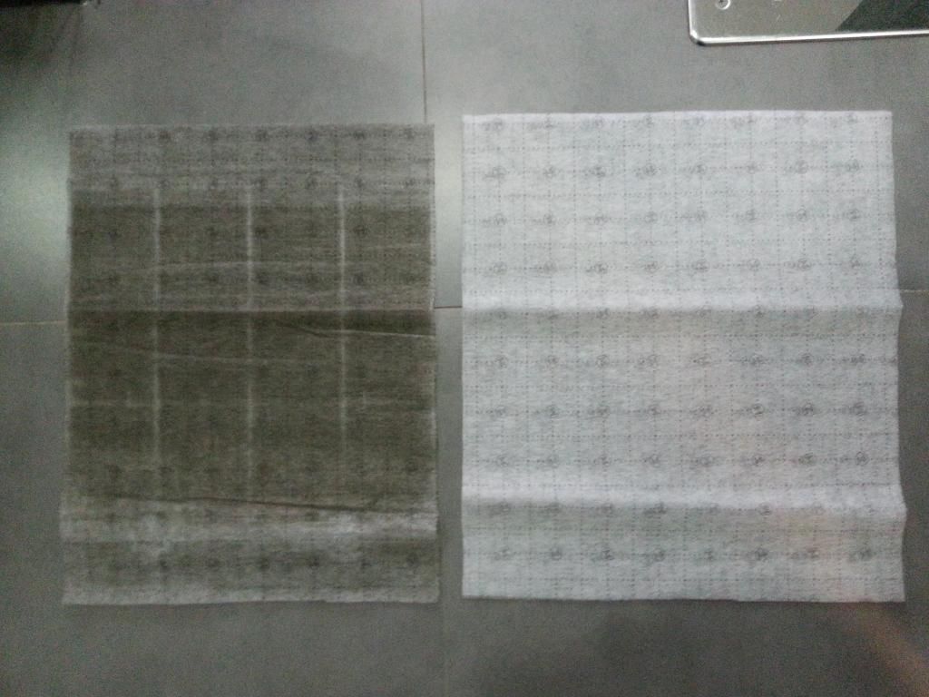

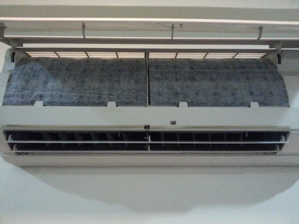

Finally found the filter cloth from Diaso, was there several weeks ago but ran out of stock.
Cut cloth according to size of filter mesh then slot it back in place.
Air flow not restricted and negligible. This will help filter more dust and dirt.

wdarke

QUOTE(Xccess @ Jul 19 2014, 07:09 PM)
Cut the cloth according to the size of filter mesh then slot it back in place.
I've been doing this since day 1. The blower still gets dirty after some time, but probably much lesser without the extra filter. In fact, I've been using the A/C every night for almost 4 years now, without engaging a professional service personnel. Just remember to change the filter from time to time because if it gets clogged you get reduced airflow.

QUOTE(wdarke @ Jul 19 2014, 07:50 PM)
Yes, we can't totally stop dust from getting through, only to cut down and prolong the period before the next servicing. You must have saved a lot of money by doing own maintenance. icon_rolleyes.gif
Cool same like mine.. When from new installed until today, From my blower still using an extra filter, even the Aircon man nothing to said, they said like this case, if everyone to be the same, from their serving program would be cut down 80% ha ha.
The 1st is aluminum fins didn't blocking on dust of the airflow still remain like new performance, just remember for change the filter on every month only.
The link here: http://www.kimrovacstore.com/mitsubishi-el...lean-video.html

TSXccess
post Oct 20 2014, 11:08 PM
Twinkle lil Stars
2,772 posts
Joined: Feb 2012
Replaced Daiso Aircon filter cloth few weeks ago, see the amount of dust and dirt trapped by the cloth. Overall I'm happy with the performance, cheap and useful. Without this filter, those dirt will get into the fan blade. Air flow not restricted in my opinion.
Used filter cloth after 2 months - Left / New filter cloth for replacement - Right
This post has been edited by Xccess: Oct 20 2014, 11:12 PM
wdarke
post Oct 20 2014, 11:11 PM
376 posts
QUOTE(Xccess @ Oct 20 2014, 11:08 PM)
Replaced Daiso Aircon filter cloth few weeks ago, can see the amount of dust and dirt trapped by the cloth.
How long was this?
TSXccess
post Oct 20 2014, 11:14 PM
Twinkle lil Stars
2,772 posts
Joined: Feb 2012

TSXccess
post Oct 20 2014, 11:17 PM
Twinkle lil Stars
2,772 posts
Joined: Feb 2012
QUOTE(wdarke @ Oct 20 2014, 11:11 PM)
How long was this?
2 months, should have change it after a month but was too busy. Shocked when I compared it with a new filter. laugh.gif
wdarke
post Oct 20 2014, 11:32 PM
376 posts
QUOTE(Xccess @ Oct 20 2014, 11:17 PM)
Your place must be very dusty. Mine doesn't look that bad even after 3 months, and I stay beside a busy road. I never open my windows though.
TSXccess
post Oct 20 2014, 11:47 PM
Twinkle lil Stars
2,772 posts
Joined: Feb 2012
QUOTE(wdarke @ Oct 20 2014, 11:32 PM)
My windows all closed, this unit is in the living room running more than 12 hrs 24/7.

post Mar 27 2017, 02:01 PM
3,812 posts
Joined: Apr 2009
From: West Malaysia
notice some mold build-up near the blower.. AC unit quite new.. less than 4 months of using..
anything we can DIY to clean? like sprayer? e.g.:
http://www.lazada.com.my/mr-muscle-mold-an...22.html?rb=3374
http://www.lazada.com.my/clorox-mold-amp-m...47.html?rb=3484
http://www.lazada.com.my/astonish-mould-am...0.html?rb=53139
picture as example.. not too bad in real.
Attached image(s)
