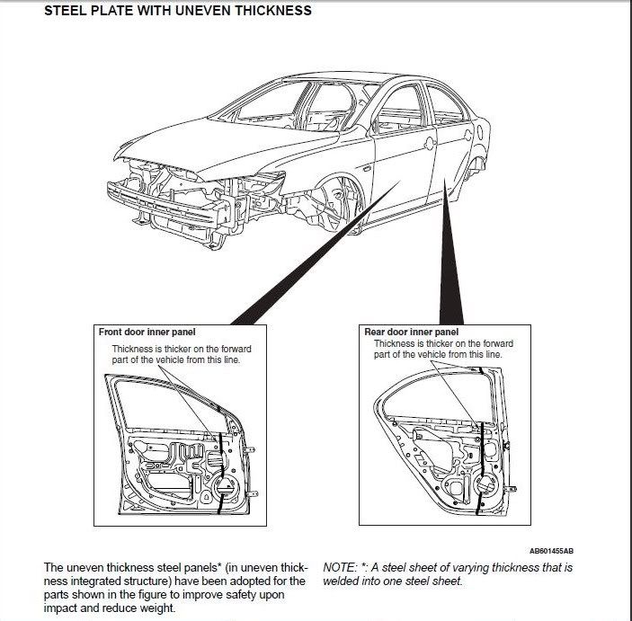

Yesterday I went to check out Proton Preve (Premium Spec) in a proton show room.
I got a shock when I noticed Proton Preve has welding joint on the
door side. Please see picture for the location of the welding joint.
A good quality and solid car should not have any cut cost and less safety
welding joint on the door side.
The car in the picture is Proton Gen2 (in China) that does not have any

post Apr 15 2012, 12:52 AM
658 posts
Joined: May 2006
From: Melaka
just because of the welding joint than its rubish? lol.. can anyone check this on merc,bmw, or any jap car tongue.gif, i doubt it basher will find any single thing, even this. doh.gif
This post has been edited by dadurtyz: Apr 15 2012, 12:52 AM
nzh0920
83 posts
Joined: May 2011
i wonder how u SEE then u know it is a solid or lousy car???
u got car body architecture back ground??
inspira also got joint on door side lo...... if u wan see tomolo i capture photo for u.....

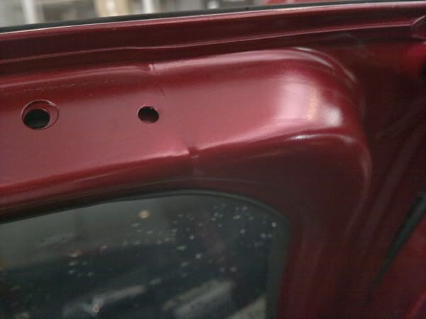

fireballs
post Apr 15 2012, 12:53 AM
10101
5,648 posts
Joined: Mar 2012
where's the joint?
http://img27.imageshack.us/img27/1670/20120413161431.jpg

TSDiamondBar
post Apr 15 2012, 01:00 AM
125 posts
Joined: Dec 2011
QUOTE(xin @ Apr 15 2012, 12:55 AM)
why din take picture ?
I did not expect this welding point on Preve since I knew Persona
had good quality original solid door side that without any cut cost
and less safety welding joint...
Very disappointed on Preve as a global car like this...
You'd better go to proton show room to check it out yourself..
I will check on the reinforcement bars on Preve later, I forgot to bring
my torch light when i was there...
This post has been edited by DiamondBar: Apr 15 2012, 01:04 AM

nzh0920
post Apr 15 2012, 01:26 AM
83 posts
Joined: May 2011
QUOTE(DiamondBar @ Apr 15 2012, 01:08 AM)
Welding joint on door side is weak and not strong enough to absorb the side impact when accident..
i think u know nuts about car.....
look at the picture....
the green bar inside the door is used to absorb the impact during accident...
not the JOINT ya...

At least my wira's welding joint is welded completely and no
hole; but for Preve, the welding joint is not welded completely
and you can see the hole...very scary quality...
This means my wira is welded 100% and cover the hole (joint) completely;
for Preve, it is only welded 50%, so you can see the hole...

Firstly, in a side impact that is strong enough to break your door, it is the chassis that is suppose to protect the passengers, not the door.
Secondly, the doors reinforcements are inside the door. Lets say you are right and the window sills are welded to the door instead of being the same piece. And a motorcycle rams into your door, the thing that will protect you is the frame inside the door, not the window sill. If you think about it, the places where the door are connected to the chassis is below the windows sills (on the body of the door), because the window sill cannot be load-bearing,and is in fact the weakest part of the door.
Number three, you havent show us the weld.
Pls try harder next time.

guys, TS is only pointing out what he saw on the car, although there are some bashing, but all in all we should thank TS and go see it ourselves. there are no point arguing it here. so MOD PLS CLOSE THIS THREAD

are u sure it is a welding or whatever it is.
some panels has been 'welded' together using synthetic glue which is meant to join the panels together.
i believe preve will have a high edge in cost cutting, whihc is normal. but the welding alone wont cost too much. just for the joint itself i might be because of other circumstances it has to be done in this method.
u need to check other makes to prove the point.

Boss, you'd better go to Proton show room and check it with your own eyes.
The Preve's cut cost welding joints and holes are very obvious there.
At the same time, check also Persona and Saga BLM that do not have
welding joints on doors, then you will know the difference..

WTF? I am certain the Preve will be safer than most Japanese ASEAN spec cars (the Avanza does as bad as the Gen2/Persona). Who cares about the welding joints in the door. To me that's just cosmetic, thus irrelevant. Will the car do well in crash tests? That's what counts. How are the materials they have used? You can't see that.
Of course if you can explain to me WHY visible welding joints are of any importance then I may change my mind. The welding can be of good quality (and how else are you going to connect the parts? You wouldn't want to use the same steel for the whole door, because you'd either use low quality materials which won't withstand anything or you'd use high quality steel, which probably has other problems, such as costs or weight. It seems like they have added a side impact bar to protect the passengers).
Seriously, chill and wait for ANCAP results. Then we shall see if what Proton promises is true. smile.gif

Very simple mah...
If this welding joint is acceptable for you, then this Preve is ok for you loh...
But I am a bit worried small cockroach can go in to build their house there..

if you strip down the car and look at how many parts of your chassis are welded together, you will probably never want to sit in a car ever again.

Very simple mah...
2 pieces of short broken steel bars welded and joined together, versus
one original no broken steel bar, which one is more solid?

Have you personally measure the chassis stiffness of both cars? Did you exert 10'000Nm of force on they B-pillars and saw which one buckled first?
Just for your info, the Waja had the stiffest chassis in proton's line of products, more than a volvo S40. The preve chassis is specced to be even stiffer than the waja.

QUOTE(DiamondBar @ Apr 15 2012, 02:59 AM)
Very simple mah...
Added on April 15, 2012, 3:01 am
Please go to check Persona or new Saga first, then you will know the difference...
you will know which one you prefer..
Which hole? there are holes to flow out excess rainwater and debris from the window. Btw, if i'm not mistaken, the panels are pressed. That's why they're welded together.

QUOTE(DiamondBar @ Apr 15 2012, 12:47 AM)
The Proton SA and I checked Proton Persona and Proton Saga BLm in the show
room, we did not see any welding joint on Persona and Saga BLM.
My Wira has welding joint on the door side which I do not blame because
I understand Wira is an old model of proton car
lol...those are safety features la..even the mitsubishi lancer has it. it is the part where 2 different metal strength are used.
Added on April 15, 2012, 6:45 amfrom inspira
Added on April 15, 2012, 6:46 amuser posted image

halo brader. it's just different in manufacturing process.
there's two ways to make the doors.
either stamp the whole door outer/inner shape in one piece (BLM, Persona, Exora)..or
only the bottom lower part + door sash, which require welding during assembly (Waja, Preve)
go learn about manufacturing first la before trolling preve buyers with this ridiculous issue.
both of this assembly process doesn't affect safety. because the main point on safety is the impact bar inside the door panels. All this already done simulation la bro and also crash tested in Spain.
btw, the one cck125 highlight in the Inspira is called TWB panels.
Tailor Welded Blanking. Proton started using that method since BLM for the front and rear door panels. Also in Exora & Preve. This method is used worldwide to reduce process cost because less welding process required at assembly line. The panel already came welded by the steel supplier before stamping. Widely used in Honda, Toyota and also european car makers.

QUOTE(mr_boonez @ Apr 15 2012, 07:19 AM)
+10

QUOTE(ckk125 @ Apr 15 2012, 06:36 AM)
this answers everything and everyone learns something new today.
say thank you to mitsubishi for having this in user manual, and yes, proton is bad because they never include this in their manual, thus making TS very very concerned and confused.

I don't think anyone can judge structural integrity by welding without taking in the whole sum of things. For example the Evolution, Mitsubishi's top end has its roof joined by just plastic screws, stamps and holders, not even welds, because it is near impossible to weld aluminium to the main steel pillars. Doesn't make it an unsafe car.
Welds also can be stronger than stamping depending on the way they're welded. If you go for an interior + long fillet, the joint can take even more energy than a normally cast or stamped joint. It all depends on the design.
TL;DR : TS is a moron.

I believe the preve is using a new hot iron press method, could it be the wielding joint is due to that?
Your picture did not show the welding joints..
This is not the ugly welding joints I am talking about on Preve..
This post has been edited by DiamondBar: Apr 15 2012, 01:49 PM

QUOTE(turbocharged @ Apr 15 2012, 08:28 AM)
This is not the welding joints I am talking about on Preve.
Please go to Proton showroom to check it out..

Penat aku explain door sash + door panel punya assembly...TS ni malas nak baca ke. BMW pun pakai door sash la weh

Ohmaigod? Mai car door also welded! Then hor, Mitsu sell this car as a global car how hor?
5 star in EUROCAP? How did mai car get this with a welded seam door? Wai, all conspiracy maa. Mitsu came out with a cost cutting car in 2008 and managed to sell it for 4 effing years w/o anybody noticing DAT DOOR WELD and even used IT TO CREATE THE EVO X.
Mitsu even sold it to Potong, who continued making (ehm, rebadging) this cost cutting car, including mine.
Oh Mai, MITSU IS EVIL.
Seriously people, have you even studied car manufacturing and Metalworking AT ALL, or even anything remotely related?
+1000
