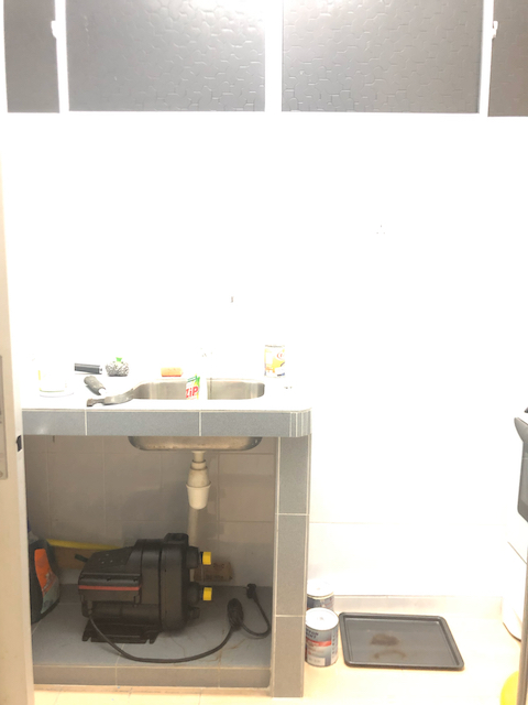

post Jul 30 2018, 07:58 PM
16 posts
Joined: Jul 2018
Hi sifus,
I'm new to landed house. Just moved in. I just want to ask which part of the house I should install the water pump. At the main water tank?
MEngineer
post Jul 30 2018, 09:24 PM
...Look at my stars...
888 posts
Joined: Mar 2011
QUOTE(sleepybear @ Jul 30 2018, 07:58 PM)
Hi sifus,
Depends on your house piping whether the water supply to your house is mainly for the tangki or from direct from the main supply. If mostly from tangki then fit the pump right at the outlet of the tangki to boost the water throughout your house

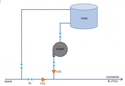

hi all
need advise on the water piping connection for my house. the black line is originally from main source to the house. i then added water filter and water pump to use the water from water tank. blue colour is the newly added and installed by the plumber.
problems i face:-
1. after using the water pump which pump out the water from the tank into the house i somehow feel the water pressure is not as good as the original direct source. water pump capacity not good enough? now running water pump, so valve 01 is close all the while.
2. plumber told me when i want to backflush the water filter, i need to off pump, closed valve 02 & valve 04 and open valve 01. rclxub.gif this is to use direct water source. he says if i didnt do this the pressure from water pump might damage the water filter
3. when there is power outage, i need to do the same for above to run direct water source. because no power, the pump not running there will be no water in the house unless switch to direct water source.
i somehow feels that this is not very convenient as u need to turn this on and off here and there. is this common for all water pump users?
there is one time at night raining heavily and suddenly power outage. i have to use umbrella go outside of house to turn all the valve to switch to direct line in order to use water inside the house sweat.gif
anyone can advise or any modifications to be done?

1. Checkvalve just before valve 01.
2. Checkvalve rarely spoil so can leave valve 01 open if check valve present.
3. Filter bypass and tank bypass and pump bypass. Good for maintainence and flexibility. Of course need a valve at the bypass. Tank bypass need to have a checkvalve.
4. Check the pressure reading at the pump. Check the pump model and spec and see if the pressure is at what it should be. Sometimes the automatic pump controller need to adjust the pressure setting if it is not properly set.
5. Check valve just after the output of the tank.
This with above modification, all the valves can remain open all the time with all the bypass closed all the time except for the tank bypass.
If power outage, you will have pressure of the main.
And can just backwash without on or off any valve.

have a look at the drawing.
normal daily operation is all valve open, water pump on. (except bypass line)
if no power, pump will not works, there will still water from main source into the house.
if washing filter, backflush, there will be no pressure from water pump to water filter because have check valve.
red colour line is the bypass line for water filter. if water filter damage/repair V-F1 & 2 close. V-BP1 & 2 open. normal operation V-BP1 & 2 will be close.
if water tank need repair/maintenance, V-02 & V-03 close. still will have water from main source. valve 04 need close? need install check valve here? water will go to pump?
if water pump need repair/maintenance, V-04 & V-03 close. water from main source will still go to tank. and also go to house.

Seems about right. But the filter bypass only need 1 valve for the bypass. No point having 2.
For tank maintainence no need close v4.

Seems like the checkvalve before V03 should be after pump not before. It can be before or after V04 even before the T junction to the house. By right just use either main or big water tank. When there rationing, open V04 and close V01. Allowing simultaneous flow from mains and pump not ideal. Adopt either or. V01 and V04 should be close together so that from one location you can close one and open the other.

QUOTE(halcyon27 @ Aug 3 2018, 03:41 PM)
Why the check valve need to be after pump?
Why simultaneous flow from main and tank not ideal?
halcyon27
post Aug 4 2018, 08:19 AM
2,140 posts
Joined: Nov 2010
QUOTE(siauann @ Aug 4 2018, 12:04 AM)
Simultaneous flow creates a pressure build up along the pipes where there two flows will meet usually at the junction.
Check valves prevent contra (opposite) flow. On a cold inlet of a hot water storage heater it prevents the heater from running dry due to siphoning. In a solar heater in the roof, it prevents hot water being siphoned from its inlet into the cold water line to the end point when pump operates which can be disastrous if the cold pipe is not rated to withstand high temperature.
In all cases I've seen, check valves are located after pump but more importantly it's located at a hot water heater or solar water heater cold inlet.
This post has been edited by halcyon27: Aug 4 2018, 08:26 AM

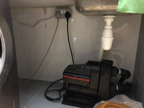

AhRon
post Nov 11 2019, 09:54 AM
84 posts
Joined: Feb 2005
Sharing here.
Live in an apartment at 20th floor. It's 22 floor apartment.
Water pressure on top few floors are weak
2 bathrooms.
Each having 1 pipe input, supplying to 4 taps sequentially. (wash basin, wall tap, toilet bowl and shower tap)
Dry kitchen 1 tap
Wet kitchen 3 tap (2 sink, 1 washing machine)
Bought Grundfos Scala 2 @ RM1700 from Lazada.
It's very quiet! Neighbors don't even know my pump exist.
Compared to many neighbours' pump where I know when they are taking shower. brows.gif
As Scala2 is an inverter pump, I was expecting water pressure to build up gradually when I turn on tap.
I was pleasantly surprised as water pressure is constant the moment I turn on my tap.

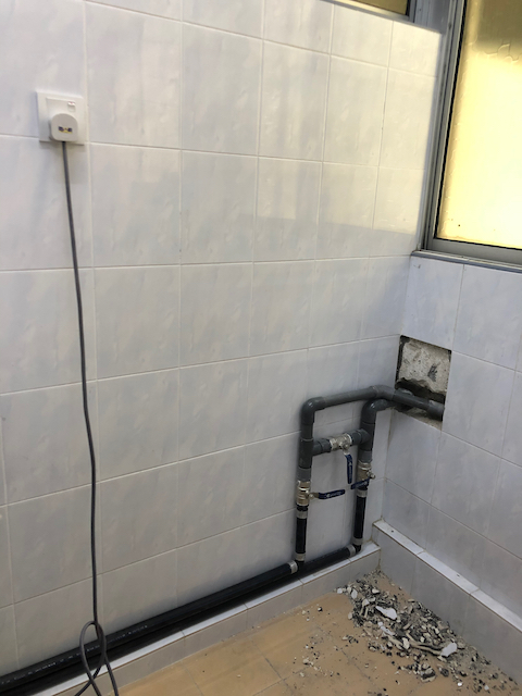

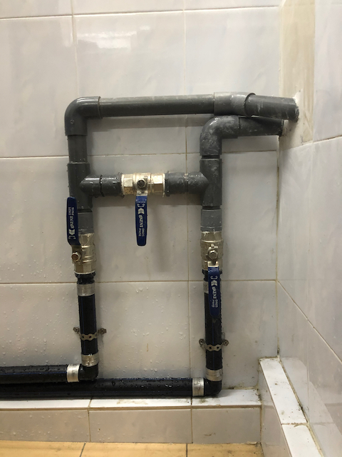

QUOTE(AhRon @ Nov 11 2019, 09:54 AM)
Sharing here.
2 bathrooms.
Dry kitchen 1 tap
Seems like Scala2 had build up pressure inside the pump before you use.
All taps now have very good pressure.
Toilet bowl got refilled very quickly, so less time to wait between flushes.
Only slight pressure drop at bathroom when I turn on ALL the 4 taps.
There is no way the Scala2 sensor can sense the 4 taps as it only sees pressure from only 1 pipe.
Lastly, I am only setting the pressure at level 3 of 10.
Initial test at 10 of 10 appears to have "clear up" the pipes.
Now even not running the pump, water pressure is high than before installation.
I have also got the plumber to install by-pass in case I need to take down the pump for maintenance.

I am not too sure about the material.
However, as it's connected to the mains from the meter, the size over there is 1".
Installer had been considerate to use some rubber looking flexi hose, and he kept the connection to the pump with flexi as well.
If you look at the 3rd picture in my post, other than from the mains 1", after the by pass set up, it's the rubber like hose.

Material of the pipe seems like HDPE(commonly known as poly pipe) pipe and PVC pipe. That's the easiest to use and install.

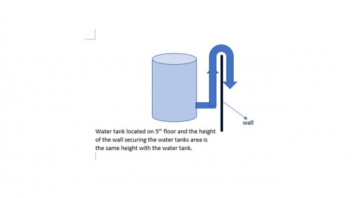

Hi guys
I have a question and hope to hear from you if you have any idea to help me solve this problem.
My water tank is on the 5th floor and my unit is on the 3rd. Problem is the water outlet from the water tank to my unit needs to climb over the wall and according to the plumber, there is a risk of air trap when the water level in the tank runs lower than the outlet. The 'climbing' can cost a lot of problems. He asked me to instal water pump which costs RM1800. Is this true?
Thanks!

QUOTE(Skydrop @ Sep 22 2020, 11:21 AM)
Hi guys
Thanks!
RM1800 seems on the steep side. I would say the risk of having the water running out on the main tank is rather low but good pump will have overheat protection. Your situation where by the water tank is higher than the unit is easy to pump so a small 150-200W pump will suffice as your water doesnt need to fight against gravity that much.
The entire surface area of the upstairs tank is easily 1-2 sq meters (if small tangki) is enough to push down the water into the 1" pipe.
A "150W HITACHI WM-P150 XS AUTOMATIC CONSTANT PRESSURE WATER PUMP" should run you around 660 for the pump only. Key is automatic pump so no need to turn on turn off.

QUOTE(ceo684 @ Sep 22 2020, 08:49 PM)
Can use class 7 pipe + inline ball valve to regulate the pressure so it will be good pressure and not excessively high.
You can backflow it from another outlet using water hose (tap to tap)?
Old high rise >15 years yes, iron pipes corroded and from 1" become 0.2" diameter left for water to pass thru. It could also be the WH filter clogged/flexi pipes clogged. Usually management will replace with new piping.
New high rise within past couple years no.. water pressure is so good I need to max out the WH to have enough heat to take bath.
Thanks Bro. I actually shared similar thought on the possibility of the tank running empty but the risk is still there. Suppose the tank is empty and the pipe is filled with air, when the water tank is refilled with water again, the water flow will be blocked by air in the pipe. That's why I was told to install pump to help draw out air trap in the pipe so water can flow again. Is this true? RM1800 is unreasonable to me! I am still trying to survey what is in the market.
What is the difference between class 6 and class 7 pipe btw? Which one is more suitable and durable for apartment/home use?
@Zheilwane, any comments/recommendations from you?

QUOTE(Skydrop @ Sep 22 2020, 09:08 PM)
Grey PVC pipe the higher the class the tougher the pipe due to thicker material. Class 0 is low class and should only be used for light duty (aka aircon drain pipe). If wanna bury in concrete use class 7 direct, its not that expensive but will save a lot of headache later on.
Depends on the pump type. Cheap pump will get water jetting when pump automatically switch on and off. it is because the pressure switch turn motor on and off abruptly. When motor is turned on the pressure build up in pipe but then the water out is less casing pump to switch off and when pressure low again the pump on and so on, causing water jetting. More expensive one have bigger bladder tank thus less water jetting effect.
Nowadays, high end pump is using inverter to vary motor speed, thus the pressure in pipe is consistant. This will let water flow smoothly. The inverter type even no need to have bladder tank.
The RM1800 probably this high end type. You need to ask. I know that Grundfos Scala2 is around RM1700~1800. This is real constant pressure pump.

QUOTE(Zot @ Sep 24 2020, 11:11 AM)
I don't think it is a high end pump because the contractor told me it is noisy but it is ceramic and durable. I fell that he is trying to slaughter me by charging that price. :'(
Difficult to find a good plumber these days.

QUOTE(Skydrop @ Sep 24 2020, 11:53 AM)
You can buy on your own and pay plumber for workmanship only. The pump shop can even advise you on your requirement. Which is more suitable for your house. Plumber probably not well verse on this.
blanket84
post Oct 27 2020, 12:15 AM
1,521 posts
Dear sifus,
I am planning to install a water pump (scala2 to be exact) on an open slab area where my water tank is. Since I need to pull a new wiring to power the pump, what size of wirings should I ask my contractor to provide? Can the wiring be shared? How the pump is typically connected to the wiring? 13A? 15A? Hardwired?

On Jan, i installed a water tank and placed a pump because water pressure was very weak before.
Just an off-brand pump that just works.
The setup is like image, with no check valve (CV) installed.
Currently only V1 is closed, while other was open.
But lately, it seems like the water pressure has been quite good.
So, I just wanna confirm...
1. Can I also open CV1 (mainly use water from main, and I'm hoping that the pump only kicks in when the pressure is low)?
2. I should install a check valve at CV1 to prevent backflow, right?
But should I also install one at CV2?
Can check valve withstand pressure from the pump?

just installed 1 water pump at car porch which direct put on floor (concrete based).
Setup as: Water meter -> water filter -> water tank -> water pump - >housing piping.
It is noisy whenever using water.
Any idea on how to reduce the noise?
I read through some comment that shall put a anti-vibration mat between floor and the pump. Is it effective way?
btw, the pump is "TANIKA"brand which introduced by the plumber contractor.

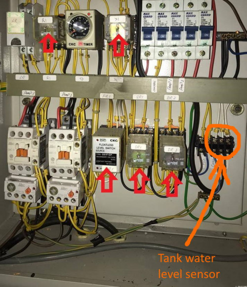

A water pump contractor came and suspect old fuses and relays (in the control panel) is causing the pumps not working. Can I buy the fuses and relays separately and ask any electrician to replace them, or the systems are too complex and requires water pump contractors?
Can take a pic of the control panel insides to see.

QUOTE(ceo684 @ Jan 4 2021, 09:28 PM)
Thanks for the fast reply.
This is the panel box. Two pumps automatic alternate one after another.
The 5 red arrows are the relay indicated to be the problem (of old age failing).

QUOTE(ashburn98 @ Jan 4 2021, 10:05 PM)
Sure you can replace the relays, by yourself even. They are all pull out and push back in, without any screw or captive mechanism. Just make sure you get the right voltage and contact rating for the relays. Best way is to pull out the relays and see the ratings. All pretty standard items. The Cikachi floatless level switch is here

ashburn98
post Jan 5 2021, 03:53 PM
Runaway train
1,570 posts
Joined: Nov 2005
QUOTE(stormer.lyn @ Jan 5 2021, 11:16 AM)
Edited to add : Have you checked that the metal rods in the tank are not corroded and sending back a correct water level signal to the CKC C61F-GP?
The Cikachi link is very helpful and I am checking out Relpot relay specs sheet as well.
This below is another picture focused more on the wires. The contractor didn't mention corrosion, so probably not.
The quirky problem is when you turn the selector switch either way and turn it back, the system works fine and both pumps works (for a few days or one week) and then revert back to not working. Turn the selector switch again and it works again for a few days. There is no power trip. This is the reason the contractor speculate 'faulty old relays' as the cause.
stormer.lyn
post Jan 5 2021, 10:13 PM
1,132 posts
Joined: Apr 2014
From: Shah Alam, Selangor
QUOTE(ashburn98 @ Jan 5 2021, 03:53 PM)
Lots of relay suppliers, doesn't have to be the exact brand. Usually the pin-outs of relays are standardised.
QUOTE
Did the contractor check in the tank? The CKC item uses metal probes to sense the liquid level, and these have to send the correct signal for the circuit to work. Or maybe the CKC is the one faulty, and every time you change the selector, it resets.
QUOTE
You could swap the relays around, but I doubt the relays are the problem. You should confirm it by going to manual mode and then manually start and stop the motors with the "start" and "stop" buttons. Does it run properly manually? If it does, then the wiring and the relays are good. I'd look at the timing after that. I wonder what items LR and TD are for?
Any further thoughts I have will need me to go there with my meter(s) and start probing the circuit. Can't do that because although I'll have no job at the end of this month, I still have it right now! tongue.gif Anyway, good luck.
This post has been edited by stormer.lyn: Jan 5 2021, 10:14 PM
RAMD P
post Jan 23 2021, 11:38 PM
Probation
1 posts
Joined: Jan 2021
QUOTE(zheilwane @ Jan 21 2020, 10:03 AM)
as per tagged message, 3 bathrooms can use teral AB25x254tpc. However, installer only available in feb a now all on holiday d
Hi Zheilwane,
I just bought and install Scala 2 at my double storey house with 3 bathrooms. However, if I turn on the shower at the 1st floor and one of the bathroom at the second floor, the pump run > stop > run > stop until I turn off the tap. The problem however didn't happen at the master bed bathroom where it is directly under the water tank (water tank is located at ceiling inside master bedroom).
The pump also shows error No.3 (Leakage). I've checked for sign of leakage in the piping but no leakage found. Even if there is, the pump might have been running when no one is using the toilet/bathroom.
Any idea how to solve this?
Appreciate your expertise
Thanks
zheilwane
post Jan 24 2021, 01:39 AM
4,184 posts
Joined: Jan 2008
From: Builders Hardware Enterprise 0362572412
weird but if u say master ok jus other bathroom got issue then not pump is piping issue.
no3 = run more than 30 minutes. so only way go up to the pump, turn off ball valve c pump stop or not. Most likely piping issue, u nd to ask ur plumber to go check
Max
post Jan 31 2021, 12:38 PM
1,705 posts
From: Sepang - Putrajaya - Cyberjaya
im diy'ing to put water pump on house water tank.
most i see the plumbing diagram need to put "control bypass" between in and out from pump. is that necessary or can be omitted? hmm.gif
and 1way valve between tank and pump inlet, necessary too?
