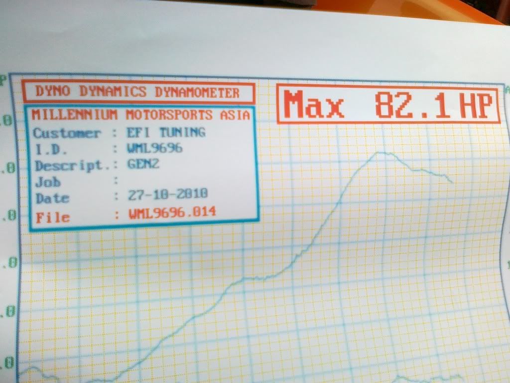

Since u have the gen2.. why not join the www.gen2club.com forum ... can gain info & members from there..
Uploaded with ImageShack.us

shazmn
post Mar 18 2011, 06:42 PM
~.~*I own a six Stars...do you?? :P*~.~
1,800 posts
From: S.Alam,Seremban
QUOTE(cyberskull @ Mar 18 2011, 05:30 PM)
dude...that pic is a hoax...originally it was 82.1whp i photoshopped it to let the joke runs within our circle ONLY... laugh.gif laugh.gif laugh.gif
he got that result from a wrongly tuned standalone...

QUOTE(shazmn @ Mar 18 2011, 06:42 PM)

I also never know about the works campro hp figures,can someone who know's share their figures..Surely some had seen dat campro b4.
Even 4g15 with 4 throttle also can compete with mild modified 4g92, i dont think it would be dat weak..Just my 27 cent...

anyone heard of dk tuning? i heard that the campro cps can be tuned up to about 130bhp/140bhp with a remap. anyone done this before?

CAI, agressive cam, tuning, full exhaust system from manifold to back, bigger throttle body, port and polish,
