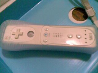

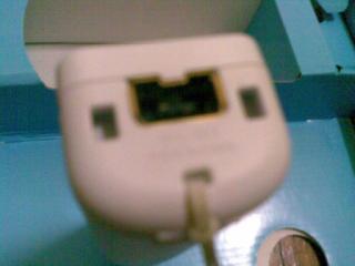

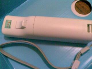

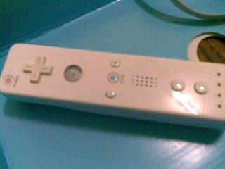

XEN -v- gK
post Feb 18 2009, 10:31 PM
137 posts
Joined: Dec 2005
Pardon the crappy photos, taken using my phone.
Most noticeable different is the Sirim sticker near the B button.
Attached Image Attached Image Attached Image Attached Image Attached Image Attached Image Attached Image Attached Image

QUOTE(Mr Ez @ Feb 20 2009, 09:06 PM)
Don't understand why the Wiimote got a Sirim sticker on it, of all the place why the Wiimote? why not on the console itself? It made feels like my Wiimote ain't virgin when the first time I got it because some guy at Sirim tested it before me  hmm.gif
I lol-ed hard at this. My Wiimote aint virgin as well when i got it the first time. My bf tested it before me. Bwahahahaha laugh.gif laugh.gif
but made me wonder oso. Mine didnt have a sirim sticker. Where did you buy yours ?
QUOTE(norrilw @ Mar 3 2009, 04:58 PM)
Guys, this is a thread to determine if the Wii Remote + Nunchuk purchased locally is fake or real and i was asking for pictures to compare tongue.gif
Not a thread to tell us where and how much you bought your remote for. Any hows you guys should check out the pictures and compare your remotes to see if it is real or fake.
3600mAh battery pack should have lasted forever! you'd want to check if the Remote is ori =P
I checked both my wiimote n nun chunk .. Its the same with the pics u posted. The fake one is really very fake by now from your pics. I support u go back n get a refund or exchange with a new ori one . This is very useful n shud b pinned.

I notice that the Fake wiimote has different FCC ID and IC# compared to ori Taiwan wiimote. The ori Taiwan wiimote has the exact same markings as my ori US wiimote.
Also, from photos provided by JasonSky, the fake has FCC ID and IC# of the Japan wiimote, while the Korean unit not supposed to have FCC ID and IC# at all. To say that it is a Korean unit then have Japan markings doesn't make sense.
Also, I'm not surprised that the fake isn't branded as Wü instead of Wii. Seems that most fakes are made by that company.

I juz reach Penang today, n test M+. It's realy working well. Well...for now maybe...
So, anyone can clarify??
Btw, hope sumone can post photo of their M+ Japan box, n the M+ itself.
Tq. N hope this will increase the awareness of such product in Wii COMMUNITY.

the tell tale signs of ORI m+ is u get the proper box (nice n hard)
the box has the words WII on the logo not WU.
the box will be long because it comes with a "free" condom casing which is to replace the original condom casing.
normally original m+ can be bargained to rm 80-85
cheaper than that prolly youre getting ripped

wii remote - look for triwing screws by opening the battery compartment. (how do i explain this?)
nunchuck - look for triwing screws at the connector. (again, how do i explain this)
motion plus - this is quite tricky. original uses silicon cover. counterfeit one uses rubber. the easiest way to determine original items is by comparing motion + silicon with wii remote slicon. even the colour is different with counterfeit items.

i hope its note too late for me to warn any future buyer that wish to buy original wii remote + nunchuk. last 2 days i bought a set of wii + additional wii remote & nunchuk. the seller claims the additional wii remote+nunchuk is original as they won't carry any counterfeit accessories. at first glance, i can say that the wii remote from the wii set and the additional unit is identical. there's very minor cosmetic appearance due to manufacturing tolerance.
As we can see from the pictures below, there's nothing suspicious:
[attachmentid=2061763]
[attachmentid=2061764]
While playing any games, i can hardly tell any differences between both wii remotes. the sound, the rumble & the sensor sensitivity perform nearly identical. I just realise there's something wrong with the additional unit when i use it to browse the wii home menu. there's slight "gee-gee" sound when the unit rumble. I proceed to check all the button on the front face and i'm very surprised as both unit feel the same. The only difference is the B button. the original has a soft tapping sound while fake one produce hard clicking sound. The defect on the nunchuk are more easy to spot. The joystick feel stiffer and the cable is not as soft as the original. Clearly, the additional unit that i bought is fake .
[attachmentid=2061837]
That spot is the only cosmetic differences on the wii remote.
[attachmentid=2061841]
Differences on the nunchuk.
[attachmentid=2061846]
Nunchuk connector. They have learn from their mistake and now using tri-wing screw but fail to change the mould.
