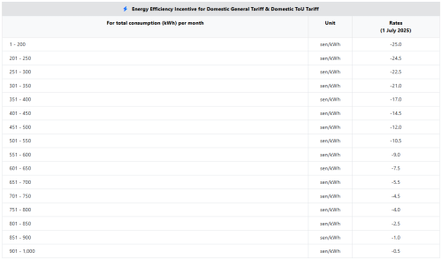

 ⚡️ 💵 TNB new ToU scheme for Domestic Low Voltage, To subscribe or not?
TSZeneticX
post Jun 23 2025, 03:08 PM, updated 2d ago
stars for what
12,409 posts
Joined: Jan 2008
From: KL - Cardiff - Subang - Sydney

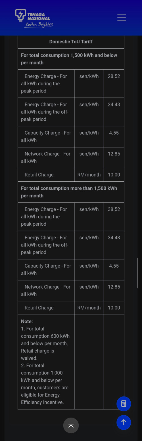

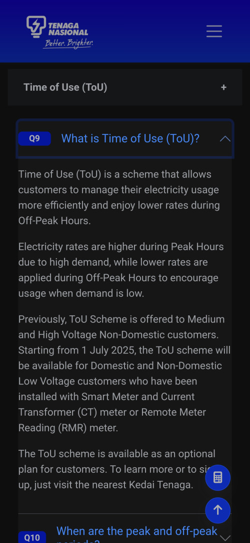

https://www.mytnb.com.my/tariff/index.html
Not much details yet eg:
Can opt out after applying?
How to apply?
Need additional deposit?
If don’t use much energy during the day and average monthly consumption is <500kwh, is it worth applying?
Let's discuss and share here

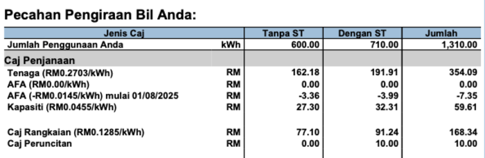

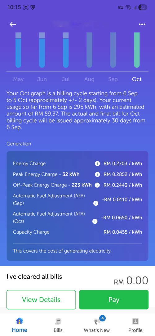

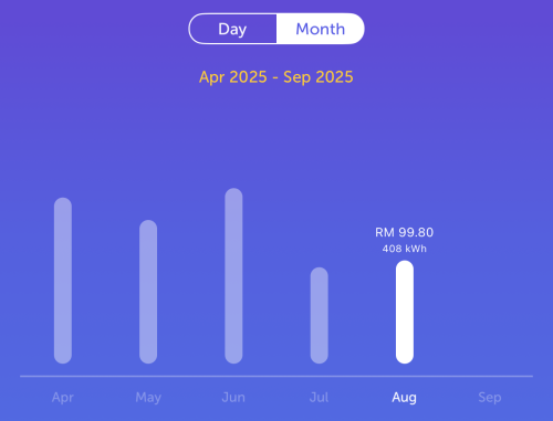

QUOTE(LaiN87 @ Aug 20 2025, 11:02 PM)
Whoever changing to TOU just putting it here so that don't get bill shock.
Everytime you change TOU, there will be cutoff and prorated bills.
Every prorated bill <28 days, all kWh will be charged SST 8%
I received my prorated bill 27 days today and all my 676kWh is fully charged 8%. So every time you change between TOU and non-TOU,
+ RM10 stamp duty
+ Additional 8% SST on your bill. No without SST for first 600kWh even prorated.

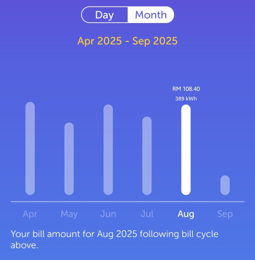

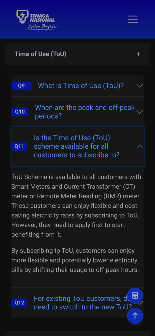

QUOTE(soonwai @ Sep 4 2025, 06:46 PM)
Found this at https://www.mytnb.com.my/faq
Applied to my examples:
1. 88 kWh no SST (28 days)1️⃣ & 9 kWh 9 got SST (3 days)2️⃣
2. 1310 kWh 710 got SST (31 days)1️⃣ & 40 kWh 40 got SST (1 day)2️⃣
3. 334 kWh 334 got SST (25 days):2️⃣ & 74 kWh 74 got SST (6 days)2️⃣
OK, settled lah. Lucky I haven't submitted my ticket yet.
ZeneticX
Conclusion: To avoid SST for those below 600 kWh, do the TOU change on(?) or after the 28th day. This will ensure no SST for the 1st interim bill but cannot avoid SST for the 2nd interim/final bill.
Alternatively, can move to Pulau Tioman, Pulau Langkawi or Pulau Pangkor. sweat.gif
This post has been edited by ZeneticX: Sep 4 2025, 08:56 PM

What is the rate, and what is the time?
If peak = 5.0, off peak = 4.9. Then DLLM lah.

QUOTE(jibpek @ Jun 23 2025, 03:22 PM)
Added to first post
This post has been edited by ZeneticX: Jun 23 2025, 03:32 PM

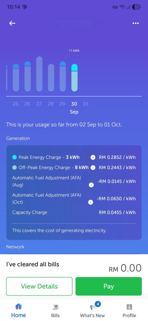

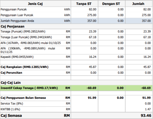

So how?

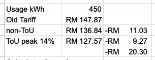

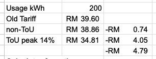

My may-jun is 310kwh
Typeper kwhsubtotal
Electric charge0.2852RM88.41
Capacity charge0.0455RM14.105
Network Charge0.1285RM39.835
ICPT-0.25-RM77.50
So total is RM 64.85
Vs now is RM 77.25

With calculation above even at standard cost, it's cheaper by more than RM 10
Home has parents, 2 person stay at home
12pm to 2pm tv, another 3.30 to 9pm tv
Fan usually on
Aircon have, but rarely use
Weekdays cook at home lunch dinner
Usually RM 70 to 90 per month
If cheaper by RM 10 is gooding

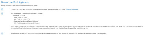

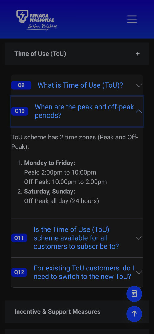

i still dont get it, if during peak but already low consumption since no one at home, why opt in?
QUOTE
peak: 2pm-10pm
offpeak: 10pm-2am(typo in the image?)
weekend:offpeak all day(24hours)

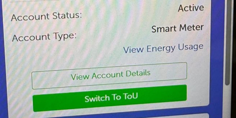

yushin
post Jun 30 2025, 07:58 PM
3,327 posts
From: Selangor

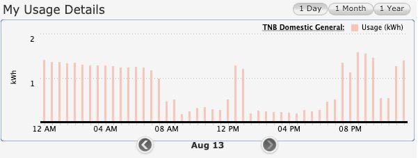

post Aug 9 2025, 02:40 AM
11,450 posts
Joined: Oct 2007

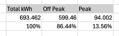

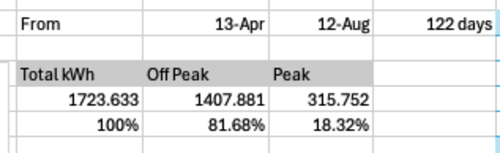

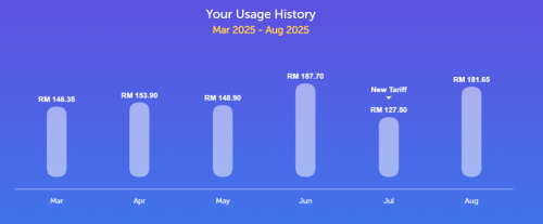

Anyone changed to TOU already? What is your ratio of off-peak/peak usage?

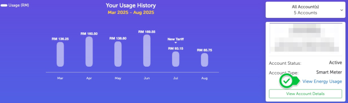

I changed to TOU a few days ago. TNB took 2 days to complete the change. After that only I found out that I can download hourly usage from myTNB website (the "View Energy Usage" link.)
Based on 52 days of usage, I'm getting this.
This post has been edited by soonwai: Aug 9 2025, 02:42 AM
annoymous1234
post Aug 9 2025, 01:30 PM
7,614 posts
Joined: Mar 2009
QUOTE(soonwai @ Aug 9 2025, 02:40 AM)
Was the final bill cheaper compared to last time before TOU?
TSZeneticX
post Aug 9 2025, 02:17 PM
stars for what
12,409 posts
Joined: Jan 2008
Based on the numbers alone, seems like you will benefit a lot from ToU. Can share what's your usage during peak hours like? Nobody at home during those hours?
N9484640
post Aug 9 2025, 08:58 PM
Chasing Electric
1,282 posts
Joined: Aug 2014
how did you see the percentage? I can only read kWh usage
soonwai
post Aug 9 2025, 10:11 PM
11,450 posts
Joined: Oct 2007
QUOTE(N9484640 @ Aug 9 2025, 08:58 PM)
Using the website (app dun have), you can download CSV file with daily usage data. After that, will need to paste into Excel and do some calc there.
soonwai
post Aug 9 2025, 10:28 PM
11,450 posts
Joined: Oct 2007
QUOTE(annoymous1234 @ Aug 9 2025, 01:30 PM)
Just changed only so have to see next month's bill which will be the first full month on ToU.
There's a very handy spreadsheet by mcchin https://forum.lowyat.net/index.php?showtopic=5531435 Once you have an estimate of the %, you can use that to compare $$$ for old tariff vs new tariff vs ToU for x amount of kWh.
QUOTE(ZeneticX @ Aug 9 2025, 02:17 PM)
I think so too. Water heater in the morning & aircon at night are the bulk of the off-peak usage. Need to remember to ensure washing machine usage in the morning instead of afternoon. I WFH so only person in the house during the day and the only extra appliance that is on is the fan. My computer is on 24/7 so no difference there.
This post has been edited by soonwai: Aug 9 2025, 11:02 PM

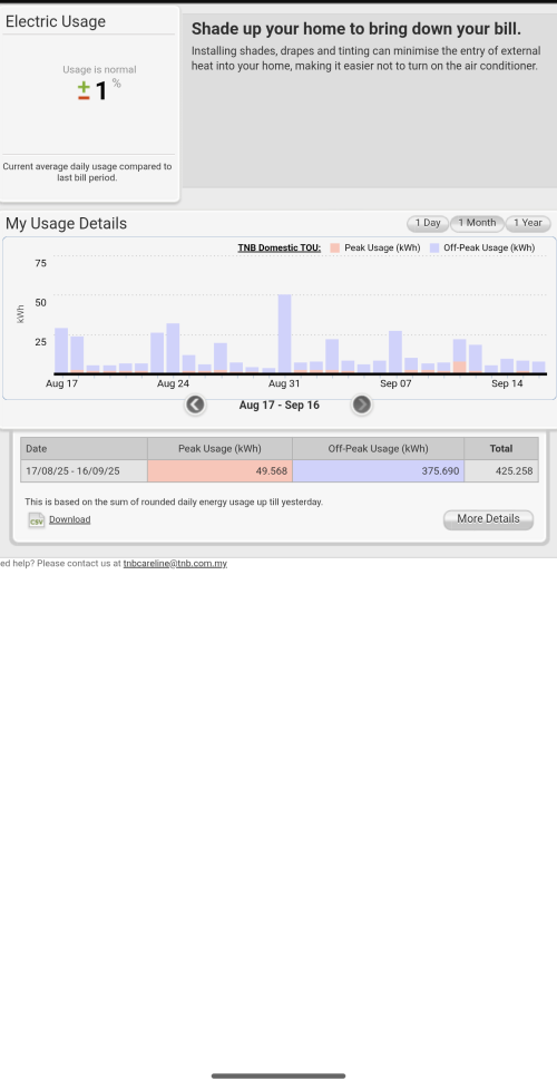

soonwai
post Aug 10 2025, 12:41 PM
11,450 posts
Joined: Oct 2007
QUOTE(BieS2Mie @ Aug 10 2025, 02:33 AM)
Where can i download the csv? I can't find it in the website.
Click on the "View Energy Usage" link on the Home page of myTNB.
This will open the Energy Dashboard (old web app is quite painful to use.) You should see Electric Usage, click Details button.
Once the next page, which defaults to monthly usage, loads up, click on "1 Day" to see daily usage and there'll be a "Download" link at the bottom to download the csv for that date.
The problem with this page is that it errors out a lot, refreshes on its own or just plain doesn't load. I seem to have the best luck when using Opera browser. Safari, Chrome & Firefox all cannot tahan the page.
This post has been edited by soonwai: Aug 10 2025, 01:06 PM

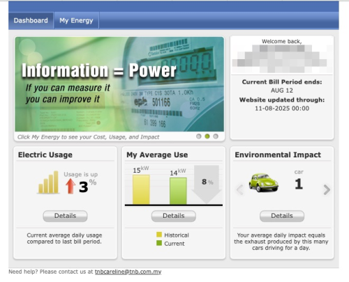

LDP
post Aug 10 2025, 04:41 PM
620 posts
Joined: Sep 2011
QUOTE(soonwai @ Aug 10 2025, 12:41 PM)
I dont see the old Energy dashboard..Hence cannot dload the csv file....

BieS2Mie
post Aug 10 2025, 09:24 PM
6 posts
Joined: Jul 2011
I guess it not available for me. I am using smart meter. Also already change to TOU tariff on 29 July.
LaiN87
post Aug 10 2025, 09:26 PM
Nom nom nom...
1,318 posts
From: メラカ /b/PowerLvl:Over9000!
QUOTE(BieS2Mie @ Aug 10 2025, 09:24 PM)
You need to make sure sign in as owner in myTNB.
If the address of myTNB "*, Jalan ...," and when you open the bill as "XX, Jalan ....," Then you didn't sign in as owner just as tenant.
In order to see smart meter data, need to be Owner.

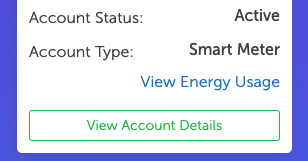

LDP

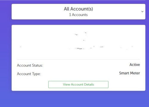

post Aug 11 2025, 08:58 AM
620 posts
Joined: Sep 2011
QUOTE(ZeneticX @ Aug 10 2025, 07:00 PM)
What happen when you click on View Energy Usage?
If dont have maybe because you dont have smart meter?
I have smart meter for years...
When I clicked on View Energy Usage, I am seeing this dashboard only
soonwai
post Aug 11 2025, 11:09 AM
11,450 posts
Joined: Oct 2007
QUOTE(LDP @ Aug 11 2025, 08:58 AM)
When I clicked on "View Energy Usage", the energy dashboard opens in a new tab. Is your browser blocking new popup windows?
This post has been edited by soonwai: Aug 11 2025, 11:11 AM
LDP
post Aug 11 2025, 11:15 AM
620 posts
Joined: Sep 2011
QUOTE(soonwai @ Aug 11 2025, 11:09 AM)
Browser not blocking anything...
It will redirect me to another tab showing the same dashboard that I shared just now...
soonwai
post Aug 11 2025, 11:45 AM
11,450 posts
Joined: Oct 2007
QUOTE(LDP @ Aug 11 2025, 11:15 AM)
Try a different browser. For me, so far it works on Safari, Firefox, Chrome & Opera. Opera gives the least problems.
LDP
post Aug 11 2025, 12:39 PM
620 posts
Joined: Sep 2011
QUOTE(soonwai @ Aug 11 2025, 11:45 AM)
Tried Edge and Chrome. Same results. Scratching my head...

romuluz777
post Aug 12 2025, 09:53 AM
2,204 posts
Joined: Oct 2010
Do we need to head to a TNB outlet to apply for this TOU ?
dest9116
post Aug 12 2025, 11:42 AM
495 posts
Joined: Apr 2019
QUOTE(romuluz777 @ Aug 12 2025, 09:53 AM)
Fill form and email je. Check tnb website for guidance
romuluz777
post Aug 12 2025, 11:56 AM
2,204 posts
Joined: Oct 2010
QUOTE(dest9116 @ Aug 12 2025, 12:42 PM)
Noted, thanks bro
N9484640
post Aug 12 2025, 12:05 PM
Chasing Electric
1,282 posts
Joined: Aug 2014
apply via your mytnb account (website not app)
press the Switch to ToU on the right panel
soonwai
post Aug 12 2025, 04:05 PM
11,450 posts
Joined: Oct 2007
QUOTE(dest9116 @ Aug 12 2025, 11:42 AM)
Click "Switch to ToU" and do online je.
But still need to scan IC back & front, maybe later got eKYC.
This post has been edited by soonwai: Aug 12 2025, 04:06 PM

vez
post Aug 13 2025, 07:26 AM
4,620 posts
Joined: Mar 2007
QUOTE(LDP @ Aug 13 2025, 07:14 AM)
Let me reconfirm this: I havent switch to ToU..So can I view the daily usage before switching ?
can if you already using smart meter
can see every 30mins consumption break down (only from PC web browser, app cannot), from the data you can estimate whether or not ToU suitable or not

soonwai
post Aug 13 2025, 07:50 PM
11,450 posts
Joined: Oct 2007
QUOTE(LDP @ Aug 10 2025, 10:43 AM)
My monthly usage is around 400 kwH...Monthly bill around 110 or so...not sure to change or not to change...I also cannot find any detailed split between off peak and peak in the portal...
QUOTE(ericong77 @ Aug 13 2025, 02:59 PM)
After looking at my daily usage pattern, I've decided to apply see if new tariff can save money. My monthly bill before new tariff is around 140 ~ 180.
Mine's about the same, average 439kWh for last 9 mths. If 450kWh and 14% peak, this is what I get using mcchin's spreadsheet. If haven't calculated your own yet, just agak-agak the % peak.
QUOTE(jimbet1337 @ Aug 13 2025, 04:12 PM)
Is it worth to apply ToU for low usage 190-210kwh?
About 12% saving. Will take 3 months to recover back the stamp duty.

soonwai
post Aug 14 2025, 03:24 AM
11,450 posts
Joined: Oct 2007
Bill out. Cheap cheap again this month. Transition between non-ToU to ToU so usage was split to a lower tier of non-ToU and max discount for ToU. But only 6 days for ToU. Probably better if can time your changeover somewhere in the middle.
Oops, need to add RM10 for stamp duty.

I think ToU should be better for most households. For 450kWh, you need to use 63% peak for both rates to be equal. Maybe that’s why TNB default to non-ToU since consumers will pay more.

I think not many ppl will go download 122 days of csv files to find average peak usage.  sweat.gif  Mine is 18.32% peak btw. Earlier posts calculated 14%, got bug in formula.
i think just from understanding your own usage you will know whether its suitable already, no need to calculate actually unless you want to know the numbers of how many % savings

U mean 8am to 4pm?
Peak is 2pm to 10pm though

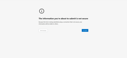

The.Lucas.DaY
post Aug 15 2025, 04:08 PM
670 posts
Joined: May 2019
Do you know why everytime i login to my brother's account (owner), i got this error, while no issue when i login using mine to view the same house's bill confused.gif

post Aug 15 2025, 05:42 PM
11,450 posts
Joined: Oct 2007
QUOTE(The.Lucas.DaY @ Aug 15 2025, 04:08 PM)
I get that all the time on Chrome & Firefox. Try private window.
Try other browsers. For me, Safari & Opera are ok.
Can also try to clear browser cache/cookies. I didn't try this.

The.Lucas.DaY
post Aug 15 2025, 10:01 PM
670 posts
Joined: May 2019
No luck, tried normal & private window on Edge, chrome, safari in iPad, chrome mobile, even changed diff Dns.

anyone bill more expensive this month? last month usage 400kwh rm96, this month usage 402kwh but rm122...?
tonyvyp
post Aug 16 2025, 12:41 PM
420 posts
Joined: Aug 2008
From: Johor
QUOTE(xiaomoon @ Aug 16 2025, 11:50 AM)
under old tariff 400kwh should be around rm122. perhaps recheck any special rebate or discount you get from previous month?
or they mess something up last month as that's the transition month (partial old tariff partial new tariff)

If 599 kWh and 64% peak usage, it'll be about equal. 23% peak usage, about RM10 savings each month.
What's your peak usage % ?
june usage bill was too low rm109. july usage rm130 (normally this figure)
every month 400kwh above
Yeah, expect to be the same here. The transition bills are quite a bit cheaper.
kWh: 432 - 493 - 388 - 408
Jul is new tariff transition.
Aug is ToU transition.
Sep will be first full month on ToU. Expect 420 kWh or RM120.
This post has been edited by soonwai: Aug 17 2025, 12:59 PM
Optizorb
post Aug 17 2025, 02:22 PM
1,244 posts
Joined: Sep 2021
mahai my bill shoot from average 150 to 180 now..
normal tariff.
TSZeneticX
post Aug 17 2025, 07:44 PM
stars for what
12,409 posts
Joined: Jan 2008
QUOTE(Optizorb @ Aug 17 2025, 02:22 PM)
normal tariff.
Your kwh usage same?

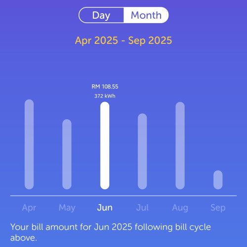

I actually pay slightly less now even without ToU
June 372kwh = RM108.55
Aug 389kwh = RM108.40
Extra 17kwh but same price almost
This post has been edited by ZeneticX: Aug 17 2025, 07:44 PM
normal tariff.
You mean from May to Jun? My cousin also notice jump in kWh after change to smart meter.

Optizorb
post Aug 17 2025, 09:18 PM
1,244 posts
Joined: Sep 2021
QUOTE(soonwai @ Aug 17 2025, 08:39 PM)
i change to smart meter quite some time ago.. not recently..
and yes from May to June jump.. but june was very hot month and memang got use more air-cond, so i can understand if bill higher..
but then July bill drop till 127 damn low.. and then now August jump back up to 187..
It feels like the smart meter damn wonky..
QUOTE(NoNameSoldier @ Aug 17 2025, 08:43 PM)
the faaking JMB have a rule saying they won't switch for smart meter .. impacting those who want to switch
Bro you not smart meter consider good ler..
like the poster above said and including my own experience, i notice ever since change to smart meter my bill on average increased by about 10~20 bucks every month..
My condo not that old, 2016 till now.. Was changed to smart meter last year iirc..

QUOTE(Optizorb @ Aug 17 2025, 09:18 PM)
Ya, July bill consider as bonus lah. Drop low bcos of the calculations involved in the tariff change. Look at your kWh instead.
As for smart meter, mine changed 2020, during the few months of relaxed MCO. My recorded kWh didn't differ much though.

By the way, since you are now on Tou, did your myTNB portal Switch to ToU button now changed to Switch to Domestic Am?

Mine was switched to ToU manually (email). Now still mention as Switch to ToU
Sounds like no portal way if wanna switch back to Domestik Am

Dunnolah, maybe just luck but last week I managed to download CSV files for 122 days. Today, want to go in to just have a look also cannot. bangwall.gif
No "Switch to Domestic Am" button, just 1 button "View Account Details". Ya, how to change back if need be.
Ha ha you're very determined to get it done
Even if the website is stable I can't imagine myself downloading 122 different files and combining them rclxub.gif
I just took roughly few days to see the pattern, even without factoring in weekends the peak time only ~30% usage
BUT... I'm lazy to apply cause need to give IC etc because my savings will only be ~RM2 per month (monthly bill @ ~RM25)

soonwai
post Aug 19 2025, 04:04 PM
11,450 posts
Joined: Oct 2007
QUOTE(joeblow @ Aug 19 2025, 01:58 PM)
Already paid a week ago but online portal smart meter still showing normal rate bar, ie no two colours bar. Also no email to indicate now I am on TOU.
What is the status of your "Change Tariff" application in "Apply"->"I want to check my application status" ? Must have got stuck for some reason.
I just checked another house. Even after application successful email, the "2 colour bar" doesn't show until after the interim bill has been issued.
This post has been edited by soonwai: Aug 19 2025, 04:43 PM
joeblow
post Aug 19 2025, 05:06 PM
1,143 posts
Joined: Dec 2015
QUOTE(soonwai @ Aug 19 2025, 04:04 PM)
It says last updated 9th Aug and status is Changing meter. I think some screw up since my meter just changed to Smart meter. I will just wait until the next bill see how. Especially if the rm10 I paid reflected in the upcoming bill, if not then messy.
soonwai
post Aug 19 2025, 05:35 PM
11,450 posts
Joined: Oct 2007
QUOTE(joeblow @ Aug 19 2025, 05:06 PM)
Ya, looks like TNB screwed up there. After "Site Verified", mine was "Reading Interim Bill". Maybe somehow they couldn't get that done, that's why need to change the meter again.
This post has been edited by soonwai: Aug 19 2025, 05:37 PM
coolguy_0925
post Aug 19 2025, 08:48 PM
4,535 posts
Sounds like TNB side record still not explicitly identified that you are now on smart meter
Well... shoot them a complaint e-mail lo otherwise don't know will hang there for how long
+ RM10 stamp duty
+ RM10 stamp duty
Thanks for the heads up. Next month check. Already received non-ToU interim bill but it's only for 1-day, 40kWh so no SST. Expect remaining ToU days to be around 1100 kWh.

Almost all ppl should get cheaper bills with ToU unless you go over approx 63% peak usage.
can use mcchin's google sheet to check your bills for old, new and ToU tariffs. What's your typical kWh for a month?
I posted an Excel spreadsheet to calc peak % based on the daily data that you can dl from TNB web.
So far, switch to ToU, app cannot, web only.

soonwai
post Aug 22 2025, 05:28 PM
11,450 posts
Joined: Oct 2007
QUOTE(RiriRuruRara @ Aug 22 2025, 02:56 PM)
Thanks for sharing. My kwh for last month was 850. Don’t understand what you mean by 63% peak usage but will try to read up about it tonight
You can go to TNB web to see your energy usage.
If your usage graph is something like this then worth already lah. If want to have a clearer idea, can download the daily usage for many days and calc in spreadsheet. I got attach one Excel a few posts up.
For 850kWh (AFA: -1.45 sen) using mcchin's Google Sheet.
I use 20% peak since that's mine. Of course, yours will be different.
This post has been edited by soonwai: Aug 22 2025, 07:11 PM
coolguy_0925
post Aug 22 2025, 11:30 PM
4,535 posts
Like others had shared
The point is how heavy is your usage during the peak (2pm - 10pm weekdays) not so much on your total usage
If you are already on smart meter then very easy to track otherwise you need to agak agak liao
QUOTE(soonwai @ Aug 22 2025, 05:28 PM)
wow that pattern of usage chart looks really similar like mine... with that kWh you will save some real bucks going into ToU... good choice

QUOTE(omron @ Aug 23 2025, 05:22 PM)
if on behalf owner how to subscribe tou
Can't do, have to be account owner. So need his IC (back & front) to verify as owner.
Can't do, myTNB login has to be owner verified. Otherwise no "Switch to ToU" button. Need his IC (back & front) to verify as owner.
If myTNB is already owner verified i.e.: has the "Switch to ToU" button then can do even with non-owner IC.
Updated answer, thanks to input from:
QUOTE(xiaomoon @ Aug 29 2025, 03:41 PM)
do online...mytnb portal, click switch to tou, fill up owner info(my brother), but submit IC part i submit my own IC
This post has been edited by soonwai: Aug 29 2025, 05:14 PM
Thank you for sharing this info. So far only using the TNB app, will try to get my fathers details to log into the TNB website since there more features there.
QUOTE(coolguy_0925 @ Aug 22 2025, 11:30 PM)
As it is also my house only use aircond at night. 2pm -10pm mostly few ceiling fan and fridge is running.

TIL while helping neighbour with ToU. He already have IC verified myTNB login but forgot password so proceeded to setup another new login. Verifying this new account again as owner with IC will not work. TNB didn't inform and just marked the service request as Solved. No house number, no energy usage, no switch to TOU button.
In the end, just reset the password for the old login.
xiaomoon
post Aug 29 2025, 02:56 PM
1,437 posts
Joined: Feb 2012
QUOTE(soonwai @ Aug 23 2025, 08:23 PM)
i submitted my ic instead of my brother(tnb bill owner), tnb approved also
soonwai
post Aug 29 2025, 03:34 PM
11,450 posts
Joined: Oct 2007
QUOTE(xiaomoon @ Aug 29 2025, 02:56 PM)
That's good, please elaborate what you did so we can learn from you. Did online or at Kedai Tenaga?
This post has been edited by soonwai: Aug 29 2025, 03:35 PM
xiaomoon
post Aug 29 2025, 03:35 PM
1,437 posts
Joined: Feb 2012
QUOTE(soonwai @ Aug 29 2025, 03:34 PM)
normal step...but when upload IC part i upload my IC
soonwai
post Aug 29 2025, 03:39 PM
11,450 posts
Joined: Oct 2007
QUOTE(xiaomoon @ Aug 29 2025, 03:35 PM)
More details please.
xiaomoon
post Aug 29 2025, 03:41 PM
1,437 posts
Joined: Feb 2012
QUOTE(soonwai @ Aug 29 2025, 03:39 PM)
soonwai
post Aug 29 2025, 04:39 PM
11,450 posts
Joined: Oct 2007
Thanks boss. That'll make it easier for ppl to apply.

WTA: Tomorrow is public holiday replacement.. Will it be counted as whole day off peak rate or will it be the normal off-peak/peak rate?
enduser
post Aug 31 2025, 09:19 PM
1,280 posts
QUOTE(Optizorb @ Aug 31 2025, 07:27 PM)
Only this holiday is gazetted, replacement day not counted
*Nota: Cuti Umum adalah 15 hari berikut:
Tahun Baharu
Hari pertama Tahun Baharu Cina
Hari kedua Tahun Baharu Cina
Hari pertama Hari Raya Aidilfitri
Hari kedua Hari Raya Aidilfitri
Hari Pekerja
Hari Wesak
Hari Keputeraan YDP Agong
Hari Raya AidiladhaAwal Muharram
Hari Kemerdekaan
Hari Malaysia
Maulidur Rasul
Hari Deepavali
Hari Krismas

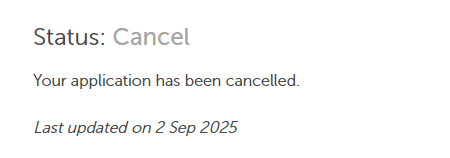

Submit the TOU application on 28 Aug 2025, then received an email for my application for payment on 29 Aug 2025.
Then I make payment via myTNB app on 30 Aug 2025.
Today received the status update, my application got cancelled.
Has anyone encountered this before? What's went wrong?

QUOTE(toi @ Sep 2 2025, 04:21 PM)
Better call them and ask. Did they call you? No email also?
When I wanted to do Change of Tenant, I accidentally did Owner Verification. Obviously not going to work since bill owner is different from MyKad name. TNB actually called to inform that the request failed because names are different.

QUOTE(soonwai @ Sep 2 2025, 05:28 PM)
Ya, called TNB, the CS checked and call me back and told me that she was not able to find out why the application got cancelled.
Hence she help to raise a report, so need 3 working days for TNB to respond and call me.
Just minutes ago while I typing this, weird thing happened, I received the same payment email I received on 29 Aug again, while the case status remains as cancel.
Really tak tau apa sudah jadi.. haha...
QUOTE
1. What are the tax charges that is applicable for electricity services?
Under the Service Tax Act 2018, provision of electricity is prescribed as a taxable service under the Service Tax. However, not all TNB customers are subject to Service Tax. Service Tax is only applicable to residential customers (Tariff A - Domestic) subject to the following conditions:
1️⃣ Total electricity consumption which exceeds 600 kWh; and the billing period is 28 days or more; OR
2️⃣ If the billing period is less than 28 days, Service Tax will be imposed on your entire electricity consumption
Note: TNB customers residing in Pulau Tioman, Pulau Langkawi and Pulau Pangkor are not subject to Service Tax.
ZeneticX
Conclusion: To avoid SST for those below 600 kWh, do the TOU change on(?) or after the 28th day of your billing period. This will ensure no SST for the 1st interim bill but cannot avoid SST for the 2nd interim/final bill. Can also do at the beginning 1st, 2nd or 3rd day of your billing period but gg if application is delayed.

Cukai Perkhidmatan 8% akan dikenakan kepada pelanggan Domestik bagi:
(A) Penggunaan tenaga yang melebihi 600 kWh untuk tempoh bil 28 hari dan ke atas atau
(B) Jumlah keseluruhan penggunaan tenaga sekiranya tempoh bil adalah kurang daripada 28 hari
This post has been edited by soonwai: Sep 5 2025, 01:23 AM
ZeneticX
Thanks for the research and explanation. Will add this to first post also

QUOTE(ZeneticX @ Sep 4 2025, 07:52 PM)
Actually credit to LaiN87. If you look back at his post, he already gave the answer. I just didn't pick up on that.

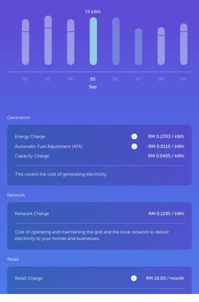

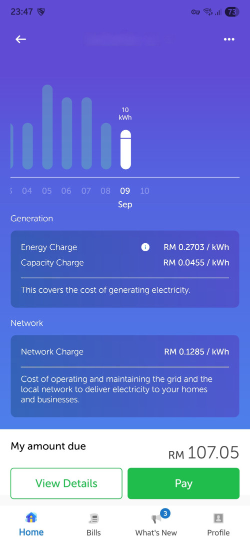

Are we supposed to see how many kwh we used during peak and non peak hour on the usage graph on myTNB app after switching to ToU?
Already successfully switched over on Tuesday. Check the app just now and can see there's a separation on the graph for yesterday's usage.... but the tariff rate still showing the normal domestic rate
This post has been edited by ZeneticX: Sep 10 2025, 11:50 PM
soonwai
post Sep 11 2025, 12:32 AM
11,450 posts
Joined: Oct 2007
QUOTE(ZeneticX @ Sep 10 2025, 11:46 PM)
Just that little break in the daily barchart to indicate the peak/off-peak.
You're right, it doesn't show the peak/off-peak rates. Didn't realise that before.

TSZeneticX
post Sep 11 2025, 01:03 AM
stars for what
12,409 posts
Joined: Jan 2008
QUOTE(soonwai @ Sep 11 2025, 12:32 AM)
Hopefully they improve it soon.... no point we see the normal rate when we already on ToU
So for the bar I would assume the big portion is off peak.... small portion is peak? They didn't specify a colour to indicate what it means also... probably it's still work in progress for TNB and the next app update can see some improvements
This post has been edited by ZeneticX: Sep 11 2025, 01:07 AM
TSZeneticX
post Sep 11 2025, 10:56 AM
stars for what
12,409 posts
Joined: Jan 2008
The view smart meter usage on myTNB website is better (if it works correctly), hopefully we able to view the ToU usage on myTNB app soon as well
This post has been edited by ZeneticX: Sep 11 2025, 12:01 PM

post Sep 23 2025, 10:17 PM
1,990 posts
From: Kalamazoo, MI
Anybody has issues like me trying to view the hourly usage of my home? The website is either slow, can't connet or keep bouncing back to the main page. It's been like this for a while now. If I am lucky, i would be able to view it.
soonwai
post Sep 23 2025, 10:54 PM
11,450 posts
Joined: Oct 2007
QUOTE(pillage2001 @ Sep 23 2025, 10:17 PM)

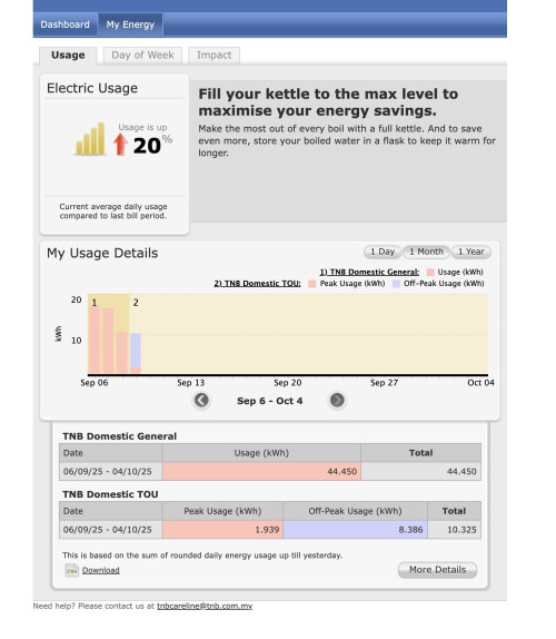

It's always been like that. I started using the dashboard mid of August for the usage.csv files. Always, reload, reload, pusing, too many redirects, etc...
There was a good day where I downloaded usage files for 100+ days. Other days, it's 10-15 mins of trying then giving up and coming back later for another 10-15 mins before I can download the usage for yesterday.
Last few days not accessible since TNB has been doing maintenance. Hopefully they'll improve it. That is, if they get it back up. Whatever maintenance they did has totally screwed up the dashboard.
Anyway according to the notices on myTNB web, the maintenance is scheduled to end on:
1. 21 Sep 4PM
2. 22 Sep 11:30PM
3. 24 Sep 11:30PM
This post has been edited by soonwai: Sep 23 2025, 10:54 PM

TSZeneticX
post Oct 1 2025, 10:19 AM
stars for what
12,409 posts
Joined: Jan 2008
Good news - myTNB app latest update finally shows peak and off peak usage for those who converted to ToU
This post has been edited by ZeneticX: Oct 1 2025, 10:24 AM
soonwai
post Oct 11 2025, 05:36 PM
11,450 posts
Joined: Oct 2007
Finally managed to download all my usage data from TNB energy dashboard. 803 days. Oldest I have is 30/7/2023 but incomplete so 31/7/2023.
What is the oldest data available for yours?
Smart meter was installed Nov 2020.
May as well graph all that data.
This post has been edited by soonwai: Oct 12 2025, 12:35 AM
NightFelix
post Oct 29 2025, 01:04 PM
Samsung Exynos
17,467 posts
From: Lazada
ToU button missing pulak. Is it only applicable for Smart Meter?
unknown_2
post Oct 29 2025, 03:16 PM
571 posts
Joined: Mar 2012
QUOTE(NightFelix @ Oct 29 2025, 01:04 PM)
yes.
cuz only new smart meter can track the time of use & send live data directly bck to TNB server.
soonwai
post Oct 30 2025, 01:59 PM
11,450 posts
Joined: Oct 2007
Smart meter AND owner verified login then only the button will appear.

post Nov 18 2025, 04:51 PM
169 posts
Joined: Jul 2008
QUOTE(soonwai @ Oct 11 2025, 05:36 PM)
Hi,
Wanna ask is there possible a miscalculation by tnb?
Aug - Peak is 74.054
Off Peak is 266.201
Total 340.255
RM 75.10
Sep - Peak is 79.058
Off Peak is 270.037
Total 349.095
RM 76.70
Oct - Peak is 83.118
Off Peak is 275.478
Total 358.596
RM 93.45

QUOTE(mikhaC @ Nov 18 2025, 04:51 PM)
Hi,
         Off Peak is 266.201
         Total 340.255
         RM 75.10
         Off Peak is 270.037
         Total 349.095
         RM 76.70
         Off Peak is 275.478
         Total 358.596
         RM 93.45
is it possible the charges increased so much for October even though the kwh not increased a lot? Tq
what does the calculation and charges breakdown show on your bill?
This post has been edited by ZeneticX: Nov 18 2025, 06:36 PM

Possible because once you go even 1 kWh above 350 kWh, your ICT discount decrease by 4 sen per kWh. 358 x 0.04 is already RM14.32. If you look at the ICT table, you'll see there's a big decrease in the discount after 350 kWh.
For example, at 20% peak,
350 kWh is RM76.98
351 kWh is RM91.46
This post has been edited by soonwai: Nov 19 2025, 04:59 AM
mikhaC
post Nov 19 2025, 09:53 AM
169 posts
Joined: Jul 2008
QUOTE(soonwai @ Nov 19 2025, 04:43 AM)
350 kWh is RM76.98
351 kWh is RM91.46
Ic.. Below is the bill, is it confirm your explanation?

contestchris
post Nov 19 2025, 02:39 PM
5,508 posts
Joined: Aug 2011
QUOTE(mikhaC @ Nov 19 2025, 09:53 AM)
TNB calculation is correct. There is a step-down of the rebate at 350kWh. Your best bet is to target usage under that.
