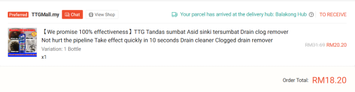

post Jun 11 2025, 09:07 AM
Your Friendly Neighborhood
1,614 posts
Joined: Apr 2010
i'll let you know if the acid from shopee works.
bought it recently, have yet to receive it.

Alternative to Mr Muscle which is quite exp.
Get this and unclog it every month. Make sure to use warm to hot water. It works very well for me.
https://www.lazada.com.my/products/pdp-i303...list.21&stock=1
