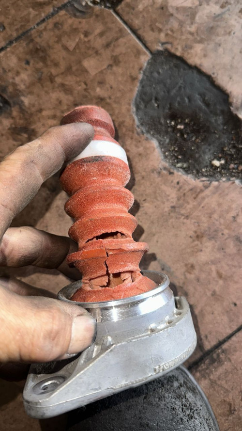

Dear all sifus,
just wonder does anyone has civic fc, mine is year 2017, now my car the fuel consumption (FC) quite high, previously usually hangs around 16km/l, but currently its 10km/l to 12km/l max. wonder anything i could check to know the reason behind high FC?
second would that when going on uneven road, there would be 'thump' sound near the rear left of the car. but when going through a hump, it doesnt have the 'squeeking' sound, but recently i have changed the rear bearing and it happened after few month after changing the wheel bearing.
thanks all for the inputs!

Civic weakness - Lower arm bushes & absorber prone to fail (Confirm fail after few years of usage due to stupid bush design in it)
fuel consumption high? Check your tires air pressure, air filter, spark plugs condition and also what engine oil you use during your last change.

why not go back to the same workshop that changed your wheel bearing and ask them to check the sound

Bush and suspension issue.

thanks for the feedback. the reason behind im asking is that i used to get around 15km/l mostly city drive, and also the reason i got such number because i pick the time on my travel, hence i manage to get the number i mentioned.
im somehow light footed when i drive except when i got frustrated then i might be heavy footed.
i think due to the damper/absorber issue it f*** up my fuel consumption and hanging around 9-11km/l.
