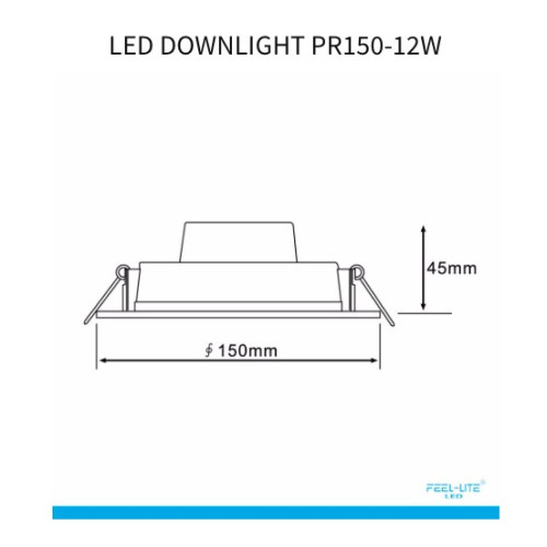

Isn't E27 bulb available almost everywhere? The only issue with such downlight, IMO, is due to the poor light throw (dark).
Those recessed downlight, on the other hand, are brighter but chap ayam type don't last long. To replace them without damaging plaster ceiling takes some practice but very possible.
I normally pull out a bit, look for one of the clips and push the housing towards the other clip.This gives me space to insert a finger into the other clip to force it up and release one side. Once a side is released, you can slide it out without damaging the plaster ceiling.

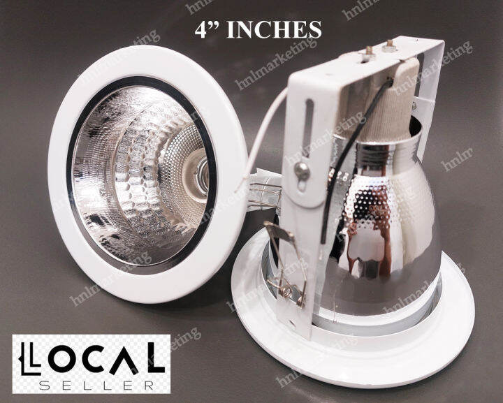

This? I think many shop still selling. Just get the housing with E27 socket.
this type has many dark spots if spaced more than 2m... not recommended although maintenance is easier.

QUOTE(RootOfJesse @ Sep 12 2023, 11:41 PM)
There are many size available and you can increase the number and a better reflector and a better placement. Way easier to change, you don't even need to climb a stair.

QUOTE(tvcat @ Sep 12 2023, 10:44 PM)
My house all install this. Still available, it's very easy to change the bulbs la, get osram or Philips brand bulbs, will last quite long. Use 6" one not 4", bigger reflector will spread the lights wider area. Those saying 2m got gap are talking nonsense.
