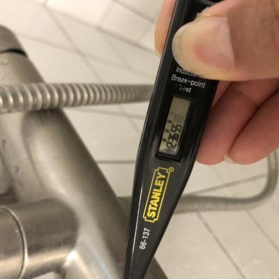

Literally got shocked last night when I was using the shower. Mine is a steel shower set type. Got zapped when I touched it!
Tested with one of those electricity meters, definitely got current. WTF. Anybody else had this problem before? I've got a Joven water heater installed above the ceiling. Is it caused by the heater or something else? Don't know if it's related or not but a few days ago switching on another water heater keep tripping the whole house (also the same model JH25).

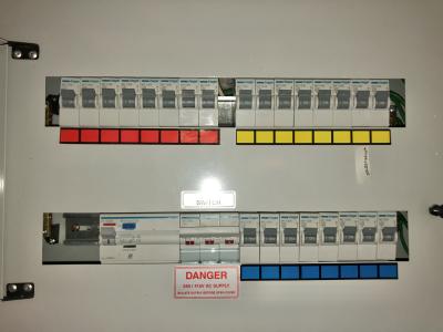

Ok, thanks! Will look into the Schneider ones... sorry noob question, not sure if I have a MCB? This is my DB box currently...
Attached Image Attached Image
This post has been edited by subaiku: Jul 20 2022, 10:47 AM
