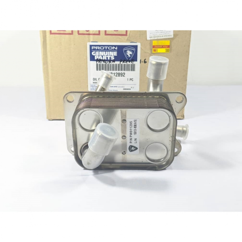

what is this part?

QUOTE(cempedaklife @ Apr 4 2022, 11:35 AM)
what is this part?
oil cooler
oil cooler hose or the OCH connects to this thing, one in one out
if this thing is clogged, deswai the inlet hose kembang and pecah bah
some ppl keep changing och or mod use steel pipe, but never think why only one side pecah
last time suspect is ppl put in oil treatment like X1R
that thing maybe cannot tahan the turbo heat (our turbo got oil feed and coolant feed) and the thing then become tahi and clog turbo oil hose and oil cooler inside tehre
either turbo kong first, or the och pecah first
some ppl use 100~150k liao never even know got such issue because never visit lowyat or check facebook
see their radiator nipple joint also still original plastic... haha

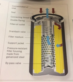

we got exora owners club, can ask there also for benefit of members
oil filter is directly when oil pumped out from oil sump.
u see here the oil filter example:
It has this thing called 'by-pass valve', is function to open when oil pressure is too high so oil can still go pass it.
Why? sometimes oil filter also full of sh*t liao, becomes clogged, so it needs the by-pass valve. Then? what happens?
The dirty oil will go in and out of oil filter to the rest of the engine lo...
then, reach oil cooler, stuck there... but oil cooler dont have by-pass valve, and the pressure keep building up
from here on, got few scenario depending on what oil flow after the oil cooler
if the oil cooler liao, goes back to oil sump, means the oil pressure will always high at OCH, but won't affect other parts, oil will run hotter since cannot pass through OC normally and slowly cause OCH to burst
if after the oil cooler, oil goes to other engine parts like the turbo, means turbo always not enough oil pressure, then, turbo kong
got ppl kena turbo kong, take apart liao see the turbo housing is sludge and the turbo shaft jam
this is either poor oil quality, low oil pressure kena oil cooking inside turbo housing, or, maybe bad additive not suitable for turbo
last time FB CFE club, got many contributors, mod OCH, service turbo, take apart, put back, change turbo hose from metal to braided one, do kempen servis turbo beramai-ramai... but, no one mention oil cooler or check oil filter see what is causing all those oil block

QUOTE(alexei @ Apr 4 2022, 03:20 PM)

list of problem/including some wear and tear u cant escape on preve
-fan motor kaput
-fan harness socket melt/burned
-aircond not cold due to aircond relay kaput, which soldered under the board of outside fusebox
-oil cooler hose koyak leaking, oca stucked clogged up
-turbo oil feed clogged up
-turbo fin shaft goyang
-rear upper camber arm bush koyak
-rear trailing arm bush koyak
-rear subframe mount which hold rear upper arm koyak, literraly need to weld back rm500> , new rm1.5k
-SiD on meter burned
-trim on dashboard patah
-middle cabin lamp patah
-seat spring for driver rosaked
-OCV got clogged up
-VVT pulley patah
what else.. oh wait im a preve owner who mod my car, and also a close friends to proton specialist who repaired and touch a preve every single day.
even the 2018 refinement model also inherit common issue from previous batch.
sekian haha

actually, my OCH didnt burst, just it got disconnected from loose clamp...mine was the semi steel och, which was difeerent than the full rubber originally came with the car
