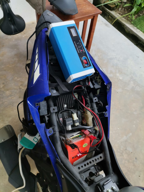

dogbert_chew
post Oct 30 2023, 06:27 PM
1,565 posts
Joined: Jan 2009
Charging my son's bike every 2-3months.
Only ride it few KM every month.
Will this degrade the battery?
alexei
post Oct 30 2023, 07:24 PM
Biker Mice from Mars
1,879 posts
From: Medan, ID
QUOTE(dogbert_chew @ Oct 30 2023, 06:27 PM)
measure voltage before you charge everytime, this will tell
yhsiau
post Oct 30 2023, 08:43 PM
792 posts
Joined: Apr 2005
From: "siew bao" town
QUOTE(alexei @ Oct 30 2023, 07:24 PM)
Those keyless scooter sure drains lots of battery power during idle periods.
alexei
post Oct 31 2023, 08:45 AM
1,879 posts
From: Medan, ID
QUOTE(yhsiau @ Oct 30 2023, 08:43 PM)
you have a point
that bike looks like R15, so should be less
keyless, IINM, can be disabled for long term storage
my point is to gauge the leakage which is attributed to internal resistance, less of external drain, and only charge if it drops to a certain voltage point since that is a gel battery

blackbox14
post Nov 4 2023, 07:54 PM
349 posts
Joined: Jul 2012
QUOTE(yhsiau @ Nov 4 2023, 01:56 PM)
Well, I have a customer who owns an adv160.. he left his bike unused for a week, the battery power is 11.2v which is not strong to start the bike.
He took the battery to me request charging the battery.
Sometimes what happens is that the rider is tired after work/trip and they forgot to turn the dial to 'Off' and left it at Seat/Fuel after opening the seat to take out their belongings. If left at Seat/Fuel position, the battery will drain much faster than if left at the proper Off position. There's a video by Indonesian ADV owner talking about this too.
