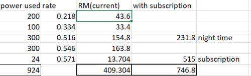

tinkai2
post Jun 19 2023, 11:43 AM
9 posts
Joined: Dec 2010

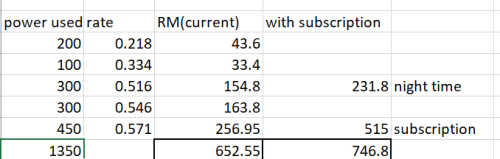

https://soyacincau.com/2023/06/15/gentari-r...t-fee-required/
Not sure how they calculated the savings.
my calculation (current)
with RM650 bill (assume I additional power is used during daytime, nighttime same power consumption)Attached File  sample_of_Home_Solar_Subscription_contract_summary_2.pdf ( 1.68mb ) Number of downloads: 77

QUOTE(bee88 @ Nov 22 2023, 07:47 AM)
By then already untung double kaw kaw dy.
But replacement is just a remote possibility. Panel not going to be replaced. Most likely inverter if it’s broken after warranty period.
it really depends on what rate u are paying.
this is my bill
the 1st 200 unit is at RM0.218 per KW, its very very cheap
the next 100 unit at RM0.334 per KW, sudden 50%+ increment over the 1st 200 unit
then the next 300 unit at RM0.516 per KW, which is 2.36x compare to the 1st 200 unit
i believe there are 2 more category after the 0.516, the max should be very close to RM0.6 per KW, which is about 3 times over the 1st 200 units
now talking about is it worth it or not, depends on how much u are paying for the last category, the RM0.6 per KW, lets say you use alot of power, like 2000 kw, more than 1000KW is from that RM0.6 per KW category, you would like your solar to completely cover that 0.6 category plus maybe the last 2 category.
but if you are only paying first 2 category (<300kW per month), then its NOT WORTH IT, 100% conQlanfirm.

QUOTE(narf03 @ Nov 22 2023, 08:04 AM)
this is my bill
Yes. Currently it’s very worth it if you hit the last two bracket like me.
However, the first two brackets aren’t going to be the same rate throughout. There would be adjustment, removal of subsidies and increment depending on govt policy 10 years down the road.

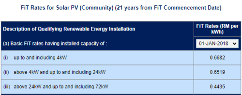

From: Medan, ID
Solar installation, the earlier you adopt, the better, last time FiT, ppl oredi earn kaw-kaw, that time the price was very high, and ROI was around 6 years. Today, their FiT income can pay for monthly car/house loan.
Now is NEM, depending on your consumption, the ROI is between 7~10 years. Contract period is much shorter than FiT.

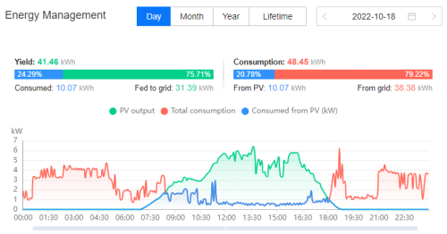

4kW yield around 4~6hours a day, that's 16~24kWh, meaning 480~720kWh per month
ronnie
post Dec 5 2023, 01:28 PM
Not enough stars
21,315 posts
Malaysia's Solar yield is lower because of higher cloud coverage... seldom see blue sky with zero clouds.
billyboy
post Dec 5 2023, 01:29 PM
2,220 posts
Joined: Apr 2006
QUOTE(alexei @ Dec 5 2023, 10:59 AM)
Location?
Klang valley for me getting only 3.1 hours (annual average)
Old bosch panel
alexei
post Dec 5 2023, 01:54 PM
Biker Mice from Mars
1,879 posts
From: Medan, ID
QUOTE(billyboy @ Dec 5 2023, 01:29 PM)
Location?
Old bosch panel
maybe I was a bit too optimistic
I got 3.46 in 2021, 3.27 in 2022, so far 3.05 for 2023...
merchant9
post Dec 5 2023, 10:49 PM
628 posts
Joined: Jul 2010
From: Malaysia
I'm getting 32 to 34 kWh yield for 2.5 hours per day due to current weather now.

QUOTE(JohnLai @ Dec 6 2023, 07:54 PM)
No wonder they said the rich will get richer and the poor will get poorer.  hmm.gif
no ler, ppl I know who install FiT are the calculative type, and they see the value oredi
some will take solar loan, some use own cash to fund it
I remember last time FiT, Alliance give solar loan at 5~6%, many ppl just take it

QUOTE(hjh87 @ Dec 7 2023, 09:44 AM)
Not entirely correct, my neighbor is one of the early adopters of solar use with the FiT scheme. Till today, after 5 years, the ROI still has a long way to go.
then it's worth looking into the maths vs actual
assume commence in mid 2018 (5 years ago)
source: https://www3.seda.gov.my/iframe/
4kW FiT at RM0.6682 - average 3hr daily, is monthly 360kWh = RM240
I think the capital that time was around 30~35k, so the ROI would be 12 years or less

Based on this actually your consumption 1619kWh (total consumption) - 673 (NEM excess) actually after offset you are not supposed to be charge surcharge
so can complaint to ST(Suruhanjaya Tenaga Bureau) this because ST wasn't aware.
I got this news from my Solar installer company just now, they are compiling all the complaints and forward to ST.
Actually the total consumption 1619kwh is used at nighttime. And Tnb supply the 1619kwh using coal and those non renewable sources. So their rationale of charging the surcharge of icpt is because the price of coal thst they use to generate 1619kwh for you fluctuate according to market price.

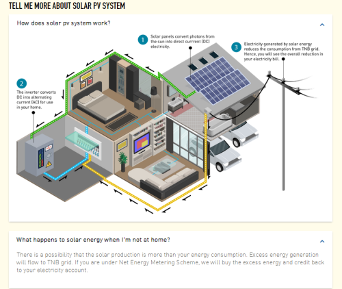

bee88
post Jan 4 2024, 10:39 AM
303 posts
Joined: Apr 2011
QUOTE(etan26 @ Jan 4 2024, 09:55 AM)
We can't directly used our solar, we export it. That's why when got TNB supply interruption we don't have any power.

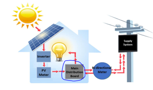

The solar db is connected to our house db. It’s not connected to the Tnb grid directly.
So it will be self consumption first, then extra will be sent out. This is confirmed.
Yes, u need to have Tnb supply to start generation. But that only to start. Once ur system produce enough, u don’t draw from Tnb anymore.
Also, one thing to consider. Ur system could be producing 1-2kw in the morning, before it peak, and at that time if u on aircond, maybe ur usage is more than 1-2kw, so the balance they draw from Tnb.
But when u peak at 10-12kw during afternoon, and ur appliances only run about 1-2kw, u will send the extra to them.
So the net import figure from the bill is from this kind of usage.

Check your inverter app for the total generation for December.
Let’s say 1200kwh
Then u compare with your export figure from Tnb bill for December.
It will be less than 1200kwh. For my case, it will be around 900-1000kwh
Where did the 200-300kwh go?
This means we have used the 200-300 units.
Analogy.
Ur farm produce 100 apples. U eat 30. So u can only sell 70.

No. As long as you don’t have the battery solution, u can’t straight use solar energy. Coz ur inverter need minimal power to start. And it is not stable to direct use anyway.
That’s why the solar db is connected to home db. And Tnb also connect to home db.
Then power come from two ways to your db.
If ur solar produce enough, the Tnb just a standby. If not it will top up. Especially in morning.

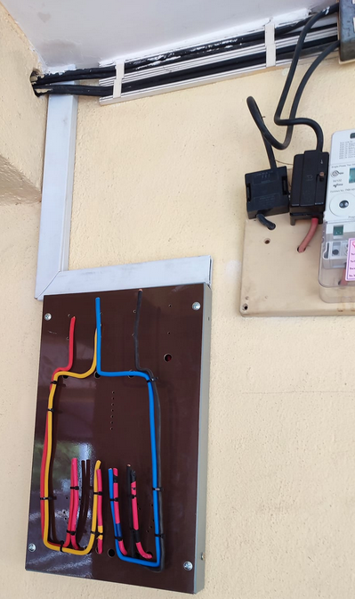

If you have a battery solution, the inverter will get the power from battery to continue the generation or else it will stop.
U try check ur home system.
If u switch off your home db, does your solar work?
For me, I switch off my home db, solar still work.
Coz I connect to incoming, not outgoing. Most setup connect to outgoing, not incoming.

I am sure we can't used it directly because the TNB meter not that smart to balance the usage between import and export energy used by our home appliances fluctuation. . It can offset the number je.....
Actually, our db get supply from both ac supplies. Tnb direct and solar db.
So once Both ac meets in the home db, it will be used together. But because solar db is one way. And Tnb is two way. So solar db electricity that lebih will flow out through Tnb meter and get recorded. And ur system won’t draw specifically from Tnb. It will just use whatever energy supply from the solar db and the Tnb. So when ur solar db electricity flood the system, the Tnb meter won’t send in anymore. Coz got extra flow out.

QUOTE(etan26 @ Jan 4 2024, 10:43 AM)
If our inverted can do it, why can't during blackout period? Simply because our inverter cannot cater for direct usage.
Show me where its said this "Yes, u need to have Tnb supply to start generation. But that only to start. Once ur system produce enough, u don’t draw from Tnb anymore. "
I connect them to my 2nd floor DB ... So my ground floor not using solar energy? They do travel backward to the meter?
U see. You connect to 2 floor db. So the energy source come from 2nd floor. It’s not even direct to Tnb.
So ur 2nd floor will use the energy first. Then extra go back to main db. And then get istributed to the appliance. Then extra flow back to Tnb.
But doesn’t mean ur ground floor will use Tnb energy first. You still use solar for self consumption first before any extra is send out.
When cloudy day, not enough producing , that’s when Tnb kicks in. That’s the way how on grid inverter works.

QUOTE(bee88 @ Jan 4 2024, 11:17 AM)
If there is a kick in, there will be an interruption. All dbs draw their power directly from TNB source.
My ground db trip, the 2nd floor not affected.
not true. i purposely try to charge my ev during noon time. while charging, the tnb incoming kwh reading didnt move at all.
of course i set the charging current at minimum (5A 3 phase, or about 3kw) while the solar generation is about 5kw at that time which can fully cover the ev charging capacity

below is what the ST Standard for EV charger. It need go out after the main RCCB
Below the ST standard for Solar, you could see solar arrived at the DB and supply into the house before involved the TNB meter (import / export).
For safety reasn when house current is cut, solar need to cut as well. else may risk on peoples who do the work
Here another explaination from TNB

QUOTE(etan26 @ Jan 3 2024, 11:13 AM)
No, during daytime we also get from the Grid, our solar energy is exported and we import the Grid energy. Hence they offset during daytime but not the night time when we have surplus from daytime generation.
The 1500kwhr, if you get it from the grid you will be charged extra. They don't calculate nett Export -Import , they just calculate what you get from the grid.

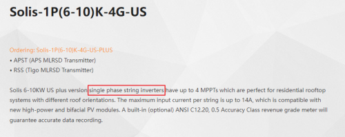

No , you have to consider whether your inverter is a 3 phase inverter or a single phase inverter.
Most installer want to sell cheap , and consumers do not know , so they only use single phase inverter. If it is single phase inverter, the inverter will only offset one of the phases. It does not offset all phases.
The other 2 phases will not be offset during the day time and continue to consume from the grid.
That's why when the1500kwhr ruling came out , some of the solar owners were charged because they were still using 1500kwhr from the grid.
Actuallu it’s possible to offset all 3 phase with single phase inverter.
Not sure if this is possible with string inverter. Micro is possible.

Probably 95% of the solar system is using single phase inverter now . I had to deliberately ask for 3 phase inverter. They did not advise me.

Nope. Most inverter sold now is single phase inverter connected to only a single phase in a 3 phase system.

Yes. Many people just buy without looking at what they actually getting. Coz the agent usually just highlight the savings and savings.
From this quotation, i think this is usually for single phase. 6kwp system usually for single phase max.
Of course there is a possibility that a 3 phase house is installing 6kwp system as well lah.
But yea. Look at the inverter model. 1p means 1 phase. 3p means 3 phase.
But I will still avoid string if possible due to high dc and arc fault which can cause fire.

QUOTE(bee88 @ Jan 8 2024, 01:55 PM)
This quotation is for a 3 phase sytem.

QUOTE(Drian @ Jan 8 2024, 10:42 AM)
No because it is all clearly stated in the quotation and there is no safety issue violated.
They can argue that they are meeting your budget and the model and brand name is all black and white in the quotation.
If the quotation looks like this:-
3. Solar PV Module
+ Trinasolar TSM-DE17M(II)-455W / Canadian Solar CS3W-455MS     X14 units
4. Solar PV Inverter
+ Solis Inverter 1P6K-4G         x1unit
How many people here will notice this? How many people are technical enough to realise based on above that this is a single phase inverter?
How many people do you think even have the knowledge to know even what an inverter is?
The same also for solar panels . How many people will realise if the solar panels given is tier 1 or tier 2 panels.
If you buy blindly without due diligent, then no one to blame. The product not just cost a few thousands but tens of thousands.

QUOTE(etan26 @ Jan 9 2024, 09:09 PM)
I always enquired with my sales consultant regarding the solar setup before finalizing else you got misinformation. If what you asked is not what you get then pls go to tribunal court.
The solar company name is at stake. Btw don't get yourself confused with financial world ya.
Nobody ask specifically for a 3 phase inverter.
They will ask for a quotation for solar, based on roof size and electric bill.
If you ask for a 3 phase inverter and sales consultant lied to you that is a different story.
In this case if you didn't specifically ask for a 3 phase inverter and you receive this quotation and if you accept it without checking, then the burden is on you.

QUOTE(Drian @ Jan 10 2024, 08:43 AM)
Are saying they gave single phase inverter to 3 phase user? If all worked fine, I guess it;s fine then.
What is the prefere-able way of connecting the solar power directly to either Main DB or 2nd floor DB? Is there any disadvantages of connecting to 2nd floor DB instead of main DB ?
