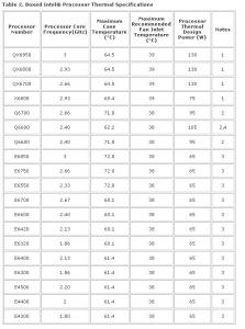

Think about it. The only difference between E6750 and E6700 is the FSB speed (1333Mhz vs 1066Mhz) and stepping (G0 vs B2). Other than that, both are exactly the same especially the TDP and 65nm manufacturing process.
As such, how can the E6750 be so much cooler on stock heatsink as compared to the E6700? rclxub.gif
However, if you look at their specs, apparent the thermal specification for both are also different. E6750 is at 72'c while the E6700 is at 60.1'c (See table below)
This is Intel's definition of thermal specification "Thermal Specification: The thermal specification shown is the maximum case temperature at the maximum Thermal Design Power (TDP) value for that processor. It is measured at the geometric center on the topside of the processor integrated heat spreader. For processors without integrated heat spreaders such as mobile processors, the thermal specification is referred to as the junction temperature (Tj). The maximum junction temperature is defined by an activation of the processor Intel(R) Thermal Monitor. The Intel Thermal Monitor's automatic mode is used to indicate that the maximum TJ has been reached"
Anybody care to explain what thermal specification means in the OC world?
Added : Comparison table - look especially at the thermal specification (maximum case temperature) of E6750 vs 6700 smile.gif

QUOTE(§layerXT @ Aug 1 2007, 01:52 PM)
I wonder if Q6600 G0 stepping will gone the same temperature reading problem. hmm.gif
Same thing with the Q6600 G0 stepping. They are supposed to have a Tjunction of 100'c instead of 85'c. That's what I understand from the hyperlinks in the 1st post......
This post has been edited by kmarc: Aug 1 2007, 04:43 PM
it is due to G0 stepping or 1333Mhz proc?
anyone with Q6600 with G0 stepping, pls reportn in...
my Q6600 is showing Tjunction of 100c and the the VID is 1.275v...sweet...but it's not G0...it's B3 though
This post has been edited by remysix: Aug 1 2007, 04:37 PM

t3chn0m4nc3r
post Aug 1 2007, 07:42 PM
Teh Necron Lord
4,139 posts
Joined: Sep 2006
From: Internet
QUOTE(remysix @ Aug 1 2007, 05:35 PM)
seems like G0 is a reject to all OC'ers... blink.gif Thank god i didn't get E6750 which i almost got... i'll be playing wif Conroe-L while waiting for Penryn... whistling.gif
TSkmarc
post Aug 1 2007, 08:06 PM
The future is here - Cryptocurrencies!
Elite
14,576 posts
Joined: May 2006
From: Sarawak
QUOTE(t3chn0m4nc3r @ Aug 1 2007, 07:42 PM)
blink.gif blink.gif Care to provide some links on that statement? The E6750 has a thermal specification of 72'c as compared to the 6700 which is only 60'c la sweat.gif
refer to the thermal specification, there is 1 column called Maximum case temperature. These are the temperature value that the thermal protection circuit will start to run if the case temperature reach that value. Once the circuit running, you will get the performance penalty.

dude let me clarify u something
its not only about coretemp...all third party
this is the reply i got from gigabyte a few months ago
QUOTE
Dear Sir,
Thank you for your kindly mail and supporting GIGABYTE.
About the issue you mentioned in your earlier mail,
First , we are wondering where you saw the CPU temperature? We do not guarantee all 3rd party H/W monitor utulities will work properly with our MBs because most of the S/W does not know our H/W design and impossible optimize their S/W for our MBs. We recommend you trying to use Easytune 5 program that we have provided in the driver CD for H/W monitoring later.
Second, The Super IO chipset can transport CPU temperature by the sensor on CPU. You can refer to attach .
At last, we apology if our past service was not satisfactory. Due to the vast amounts of questions we receive daily, we understand the inconvenience of waiting for e-mail responses. If you still have any further question or suggestion about our product, please do not hesitate to contact with us. Thanks again for your understanding, and please receive our sincerely apology.
******** Thank you for supporting GIGABYTE products *********
and here is the attached io pic that i got from them
[attachmentid=283475]
i did write to asus also and got a similar reply..
y all this questions... after testing a few mobos with x6800 using scyte infinity and coolit... i was getting weird temps with asus and gigabyte mobos compared to evga 680
second.... asus/gigabyte p5n32e-sli and n680dq6 ... everest was showing the exact temps as core temps. while evga 680 was like heaven and hell. ( this reaffirms the the statement given above... everest vs core temp)
i hope this answers some of ure questions... as for gigabyte .. i have tested my proc with a external sensor between the heatsink and proc... it was like 3C more than the gigabyte motherboard sensor.
my bet gigabyte got it right... as i am writing this my comp temp for the qx6800 is now running at 3.6ghz 1.42v for the whole week .... gigabyte bios temp is 40C/64C ( Idle/Load) while core temp / everest is 72C/95C Idle/Load
go fly core temp heck i have tested by unplugging the pin of the pump for the coolit on the evga mobo and then only i can feel the heatsink is hot... other than that the heatsink is freaking cool.
so as for now... i do not trust core temps... for gigabyte motherboard especially trust the bios readings..
hmm kindda dumb if u think the engineers are getting the temps wrong purposely right??? even after intel gave them all the info on how to design a 775 mobo to support qx and c2d...
final evidence... that again its all about the io's
using F3 bios vs F4 bios everest/coretemp difference is 10C.
gigabyte motherboard cpu temp sensor difference 1C..
geee

However, there's a few things that need to be straightened out:
1) We do know that software monitoring of CPU temperature or voltages are not as accurate as the real thing
2) As we are not the enthusiast type that actually take a multimeter or digital thermometer to check the readings, we need some sort of way to look at the measurements - hence the need for reliable 3rd party softwares
3) The reason for this thread is that either temperature for the E6x50 series are very inaccurate or the E6x50 series are really physically colder processor compare to it's predecessors e.g. E6750 vs E6700
4) From many observations, it is probable that the temperature sensor reading is wrong, or Intel has a new Tjunction for the E6x50 series
Here's what I can conclude from reading and gathering as much info as I can about the E6x50 series:
1) The Tjunction is still unknown.
---people are just blindly saying that the Tjunction is 100'c without any proof
---Due to this, they advice adding 15'c to the core temperature readings of 3rd party software
---core temp 0.95.4 has been adjusted to 100'c Tjunction. However, the author also only guess that the Tjunction is 100'c
---Even Intel is not telling what the Tjunction is (I've emailed them)
2) Some are suggesting that the temperature sensor is inaccurate at idle but correct at load
---Because the idle temperature is lower than the ambient temperature
---Load temperature seems correct (to add 15'c makes the CPUs very hot!!!)
3) Be careful when OCing these E6x50 CPUs
---as your CPU may be running at a higher temperature than you think!!!
4) Some suggest using the "Delta to Tjunction" function in core temp
---as long as the value is not within 20-25'c, then it is claimed to be acceptable
---need further confirmation, wished I had access to any database with "Delta to Tjunction" values
That's about it I guess. I'm sure I miss out something but already headache just writing the above!!! rclxub.gif
