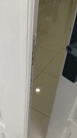

This is the original mortise lock provided the developer. The thickness is 36mm like most Malaysian door.
Although it is mentioned for 40mm to 80mm door, the black square spindle and some screw can be cut shorten to fit into the thinner door.
Widening the mortise hole. Extra care need to be taken to avoid breaking the thin layer of wood from the mortise.
Attached Image Attached Image
Warning! If you plan to install this lock into a wooden door, you need to cut off the 3-point latch as shown above. Else, you will not be able to lock the door properly.
To cut the 3-point latch, use the black square spindle to rotate the handle hole and expand the bolt and the 3-point latch. Cut the latch with angle grinder.
Final installation
My experiences on installation:
- Cutting the mortise is taxing. Fitting in the lock with all the cables into the door is another challenge. You might need to cut bigger hole than the provided dimension guide just to fit in the cables.
- Do not over tighten the screw as it might affect the lock mechanism
- Don't forget to lubricate the lock!

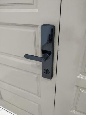

One thing i like about XiaoMi Mijia Door Lock is it has a discrete look and doesnt scream "hey look at me! im a smartdoor lock!".
The frame and the handle of the door lock is made of metal with a smooth matte finish that is nice to touch.
The outdoor panel is said to be tempered glass but i do noticed some micro scratch.
The internal panel however is a removable glossy plastic and it may be prone to scratches.

Seems that my version of the xiaomi smart lock is very different, when unlock from outside- there is no confirmation or error light on the door handle
also my unit operates on 4 batteries only and not 4, bought 8 eneloop - never checked properly before buying this is apparently the youth model i got.
also there is a need to get a proper experienced installer with experience to do it - my door frame is metal and the striker plate cannot be installed though the locksmith cleared enough to close the door but the striker plate cannot be installed so he recomends to clear the opening enough to fit the place and then weld it on ...
the issue with region was resovled with me installing Dual Space and running the Mijia app on China region as i have the xiaomi robot vacuum on malaysia region - not much clone app works with mijia

also the inner know - i can lock when turn clock wise to deadbolt the last bolt but cannot tuen anti clockwise

Also on the rear side... The button on the ha dle.. What's that for?

QUOTE(earl-ku @ Sep 24 2019, 09:54 PM)
Child proof button. That button needs to be pressed to open the door

QUOTE(hikashi @ Sep 24 2019, 10:41 PM)
Yeah I needed to press that to open few days back.. To not required.. Twist handle can open liao...

Took the installer about 2 hours. He did have to use a drill and cutter to get the upper mechanism of the lock to go through, but other than that the dimension of the parts were spot on with the older lock. The original strike plate was kept as it is. The labour cost of installation was RM300.
I had to change region to China Mainland in order to get Xiaomi Home app to recognize the lock. Did not need to use VPN or a new account, just a matter of changing the location setting on the app.
Configuration was a breeze. Firmware update required a few tries before it was successful. NFC only works with Xiaomi phones. Fingerprint recognition was instantaneous so this is going to be the primary method of entry.
Overall it seems like a good buy for RM1199 (Shopee). Next plan is to get a Bluetooth WiFi gateway.

I was not able to video the installation today due to work commitment. Managed to see a bit from the CCTV at work.

QUOTE(idoblu @ Oct 23 2020, 11:00 AM)
what you mean by "door lock is longer"? any photos and dimensions?
this long

Today im getting 1 huge issue with the smartdoor lock. :sigh:
The fingerprint sensor keep self triggering without any finger making the door lock locked itself.

QUOTE(hikashi @ Nov 18 2020, 02:39 PM)
you getting this message?

QUOTE(idoblu @ Nov 18 2020, 05:04 PM)
Ya! Exactly that.
I cleaned the fingerprint sensor with isopropyl alcohol. Fingers crossed it work..

Lol it happened again. Ghost finger sensing.
I guess that's it for me.

Update:
Reset does nothing.
Cleaning the fingerprint module does nothing.
Probably due to prolonged exposure to the element.
Guess Xiaomi product is a gamble in terms of durability. Same goes to my Xiaomi vacuum.
Im not willing to let go the convenience of a smart door so, i unplug the fingerprint module. Minor inconvenience using the keypad. Still beat the traditional key.

QUOTE(tintinn @ Jan 13 2020, 07:15 PM)
