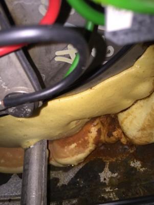

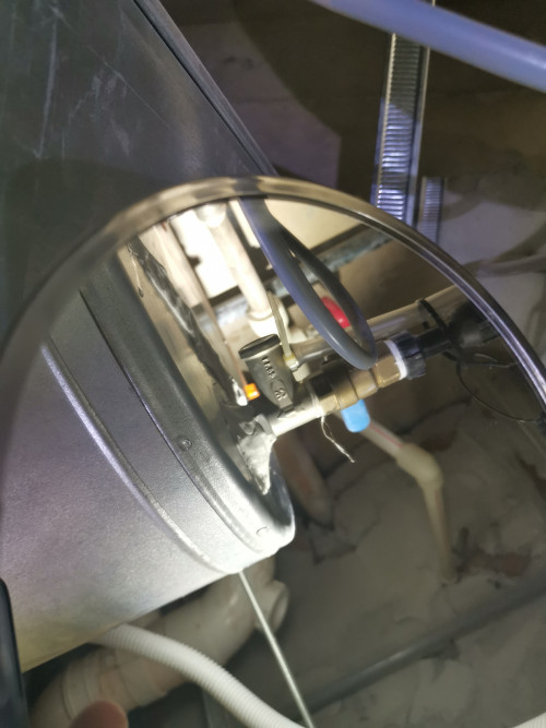

This is the inlet area that is leaking.
The manufacturer support asked too open the inspection panel and take more picture of the internals for more advice.
so gotta check it out tonight
halcyon27
post Jul 7 2017, 05:36 PM
2,140 posts
Joined: Nov 2010
QUOTE(wayne @ Jul 7 2017, 05:35 PM)
Wall mounted above the bathroom ceiling? Looks like tight space.

TSwayne
post Jul 7 2017, 05:41 PM
353 posts
QUOTE(halcyon27 @ Jul 7 2017, 05:36 PM)
yeap, its mounted to the concrete above the plaster ceiling. very tight. not much maneuvering space really.
If they have to replace the whole tank, then will have to remove the plaster ceiling for sure.
the plaster is wet already now but is still not as bad. looking for a contractor to do this so called small job will be a headache as well cause not many want to do just a small job these days.

sent MERU support the pictures they said confirmed leaking tank so they will send a new tank over.
But they will ONLY send the tank. haha. Installation and plumbing i will have to settle it on my own.
Such a hassle, i ll have to get the plaster ceiling contractor and plumber separately.

got a guy to cut the plaster ceiling for me..cut the piping and unmount the tank and rejoin the piping and mount the tank. Charged me RM 350. so far so good.
but his plaster ceiling skills are noob haha. think gotta get another plaster specialist to redo the ceiling in the future.
