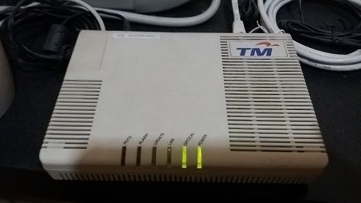

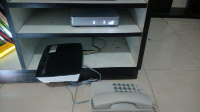

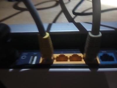

Successfully configured my MR3220 to works with H8240w & TG784n v3
H8240w (LAN2) -> MR3220 (LAN1)
TG784n (WAN) -> MR3220 (LAN4)
PHONE1 & 2 at TG784n are up/green
Full Setup
This is the correct VLAN tagging in MR3220...
In summary
- Configure VLAN 1,621 & 822
- Assign WAN to VLAN621
- Assign LAN to VLAN1
- Assign VOIP to VLAN822
- Disable PPOE & WIFI in TG784n
