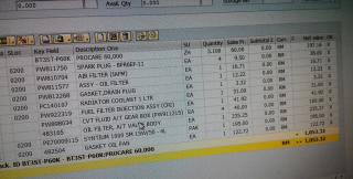

CVT Transmission Service ESTIMATED price at Proton Edar Service Center
CVT Fluid [1Liter x 4bottles] = RM40x4 = RM160
CVT filter = RM 235.25
CVT labour charge = RM 60.00
Total: RM 455.25
Optional:
Transmission Gasket = RM 122.72
Total including optional: 577.97
*Part and labour price subject to change by Proton without prior notice
*As rough reference only. Not necessarily reflect 100% actual price charged by SC

AMenzZ
post Jul 23 2014, 10:26 PM
Master
306 posts
Joined: Dec 2007
From: Petaling Jaya
Next 60k service quotation.....expensive lo...

ruby1288
post Jul 23 2014, 10:43 PM
10 posts
Joined: Aug 2010
QUOTE(AMenzZ @ Jul 23 2014, 10:26 PM)
1) why labour 197 ? max. only 100
2) why ur fuel filter so expensive ? some more CFE ? GAGA CFE ? mine only 25+/-
3) CVT fluid acc. to proper Punch procedure, need 4L+ or as per 1st page, 4.15L.
Punch procedure states that should fill in 5L (i.e. 5 btl) let it run awhile, then drain off the extra.
Some SC will put in only 4L and completely ignore Punch ori procedure but yet car functioning normal.
So up to owner.
4) no brake fluid ? if 40k done, then no need.
5) is a gaga or big fat prebet cfe ?
This post has been edited by ruby1288: Jul 23 2014, 10:44 PM

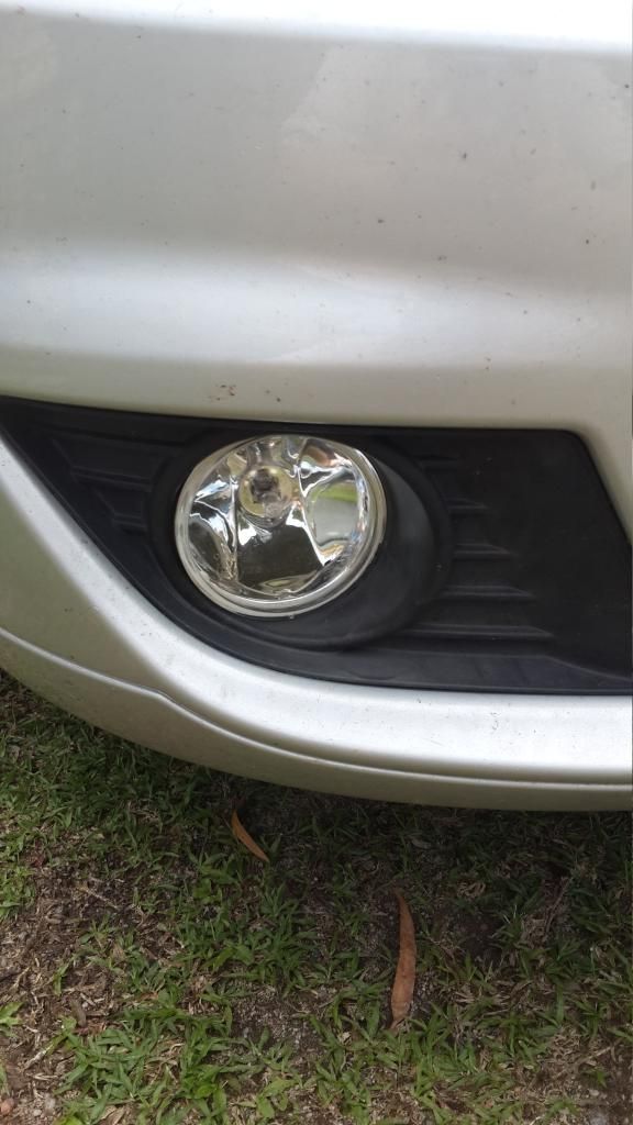

Any sifus care to explain? Please no bashing me im newbie smile.gif terima kasih
Summoning dares davidke20 Quazacolt and other sifus

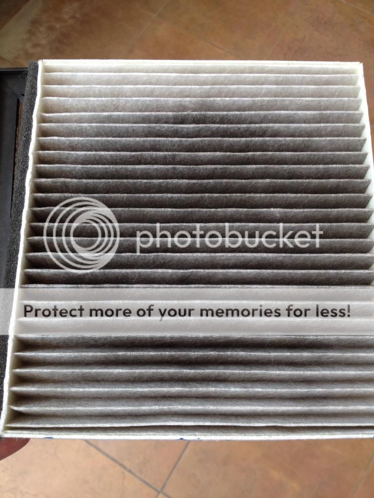

This post has been edited by 2JayZ: Jul 24 2014, 12:43 PM
dares
post Jul 24 2014, 12:51 PM
834 posts
Joined: Jul 2011
QUOTE(2JayZ @ Jul 24 2014, 12:42 PM)
I found this in my car... no wonder got hissing!
This post has been edited by dares: Jul 24 2014, 12:51 PM
iskazulka
post Jul 24 2014, 12:52 PM
62 posts
Joined: May 2012
QUOTE(soyabean123 @ Jul 24 2014, 12:00 PM)
Yes yes! choking and engine went off. =(
Gonna call for proton service, but i think is hard to make appointment now until next next week. All having Raya mood... =(
meh abang tolong check kan. lol
kalau lepas start balik kereta tu ok tak?
bunyi hiss tu maksudnya ada ini.
This post has been edited by iskazulka: Jul 24 2014, 12:57 PM

QUOTE(dares @ Jul 24 2014, 12:51 PM)
ericmaxman
post Jul 24 2014, 01:07 PM
7,951 posts
QUOTE(Arvinaaaaa @ Jul 24 2014, 12:04 PM)
Dear sifus after a day of having the car..I have to say all is good especially the CVT..
Although I have one problem..when I on the aircond and rev can hear like hissing sound. It comes and goes occasionally and the aorcond is still cond..is there anything I need to worry about or take to service center?
I have found similar problem in the older threads and sifus told it is normal.. https://forum.lowyat.net/topic/2716441/+120
Its normal
davidke20
post Jul 24 2014, 01:48 PM
3 posts
Joined: Mar 2012
We're not sifu, but the next door amateur. Not the type that do prawn, but DIY with GaGa.
If u r talking about hissing sound when compressor kick in, that's because of the valve opened, sending refrigerant to the cooling coil. Basically, its a normal activity for car cooling ventilation system. Due to lack of sound proof and rubbish grade recycle prastik desbod in GaGa, hence the hissing sound bcum amplified & u'll be able to hear it eberytaim akon kick in.
To avoid hearing so manytaims hissing sound, plonk your thermostat to maximum level, by right the hissing sound interval will reduced to about 5minutes once, but u will be freezed to death & bore a hole to your wallet as FC may increase by 30%. Otherwise, on FC challenge mode, my thermostat is always on minimal, hence every 15sec the hissing sound will come and go repeatedly.
1 thing noted, when I have no cabin filter running, the hissing sound is super loud, ultra fast cooling!
Meanwhile, Quazacolt got no PL1-BT series car. He can only give u a general information on technical knowledge. For instance, he may answer u as, "got hissing sound meh? No ark, all my lisang sengtra, inspaliah, ganjil, iswaga oso dun hab hissing sound. But I think its normal geh" such kinda reply laugh.gif ayam not saying he's wrong as he's a very helpful contributor, but sometimes newbie might get konfiused due to discussion selanged with different vehicle model.
Next week if Raya4 evening got free we can meet up for a short TT la. Me & lhwj do this anal annually laugh.gif

Quazacolt
post Jul 24 2014, 02:27 PM
Riding couple
5,367 posts
From: KL Malaysia
QUOTE(davidke20 @ Jul 24 2014, 01:48 PM)
Arvinaaaaa basically what david said loh...
should be normal if related to air cond.
insapla car worst, very loud compressor clutch engagement and hissing sound and got other weird lorry like sound/air compressor sound that you hear from tire shops/workshops.
it's only saving grace is decent cabin sound proofing (not engine bay sound proofing so you still hear it VERY clearly outside the car) so once you shut off the door you can barely hear it tongue.gif
from the top of my head been with saga members' TTs, inspira aircond sound is worse than saga, so be thankful la laugh.gif
and no i'm not joking when the engine compartment sound like a bad diesel lorry running lol
