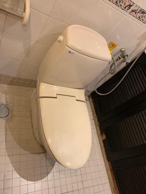

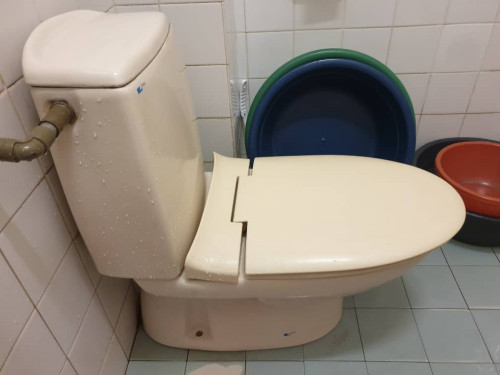

Dear Sifu
want to change my toilet bowl but scare buy salah type/size
What should I tell the seller in term of size & type of bowl?
Mohdnorazman
post Jan 15 2015, 06:13 PM
139 posts
Joined: Aug 2012
QUOTE(loui @ Jan 15 2015, 11:52 AM)
Dear Sifu
You should measure from wall until center of rough down pvc pipe. From ur picture look like 8inch or 200mm wc
This post has been edited by Mohdnorazman: Jan 15 2015, 06:15 PM
quintesson
post Jan 15 2015, 10:56 PM
566 posts
Joined: Oct 2006
if those tiles are 1 x 1 foot then the rough-in hole center should be 300mm from the wall.
the WC that you are going to choose should be 300mm with straight connector or you can have tolerance of +(25-50mm) with an offset connector.
change to those close coupled type WC, imo it's look much nicer than the existing 2 piece type but personally i don't like 1 piece WC. just my personal view. sweat.gif
