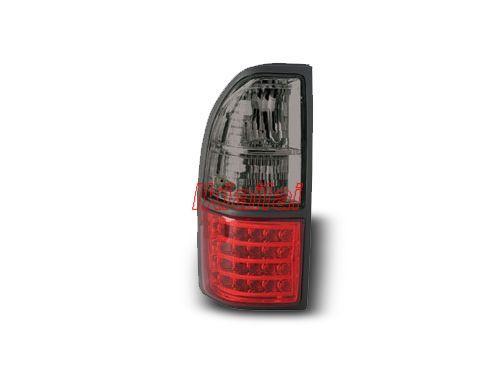

oh yeah guys anybody know a place to make custom headlamps and tail lights?
ready made lights can cost up to rm1.2k for the headlamps and rm600 for tail lights
like these
btw does anybody know if there's any jpj restriction on aftermarket lights? unsure.gif

QUOTE(Johan-N @ Oct 19 2011, 02:41 PM)
like these
just go to any 4x4 accessories shop they probably got it,as for custum made you just have to bring it to a car painter usually they know how to smoke it.

QUOTE(siksa @ Oct 19 2011, 02:43 PM)
i'm asking about custom made headlights bro...not aftermarket ready made unsure.gif

Added on October 19, 2011, 2:49 pm
yes 1jzgte,it cost me 10k including the engine 5k,rwd is okay but just keep your ori gearbox and fron axle,you might need it someday,i sold mine and now i have to look for it which can cost up to 5k. as for jpj i use runner,paid 900 and all is done by them.
custom dun have la but you can smoke it,just bring to any car painter they probably know how to do it.last time here got someone doing it.
