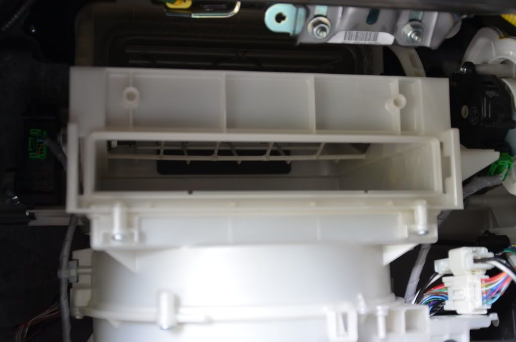

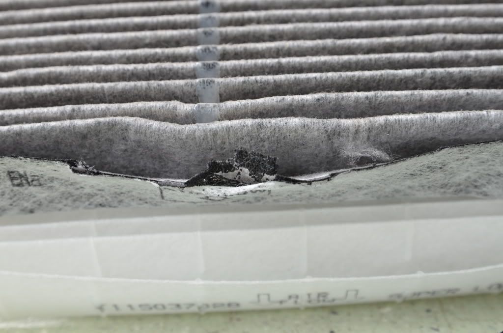

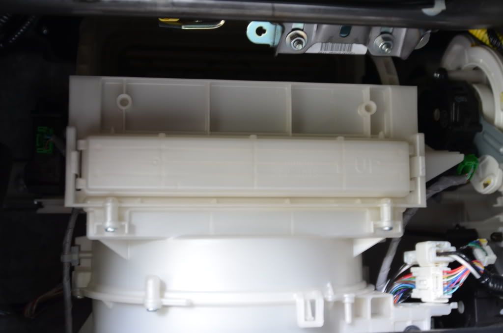

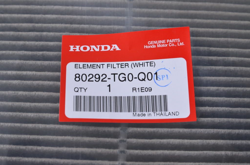

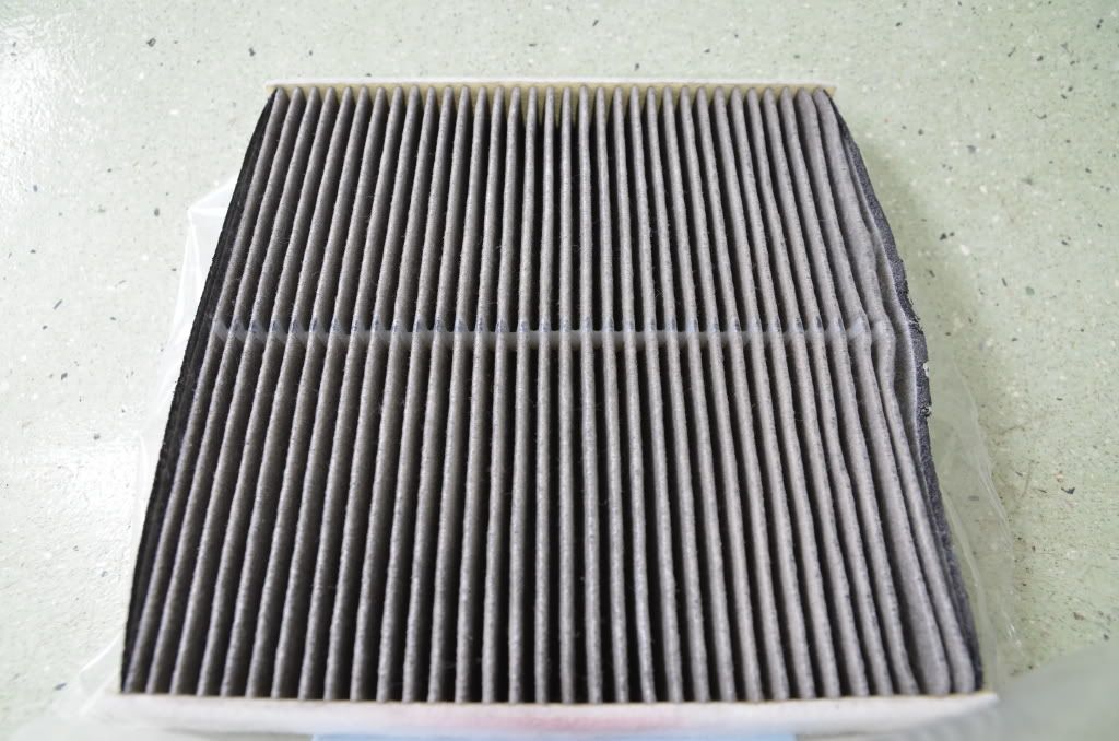

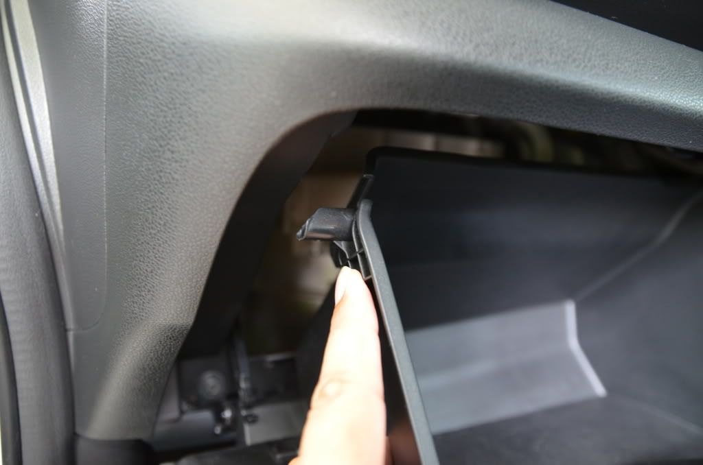

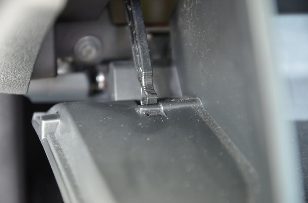

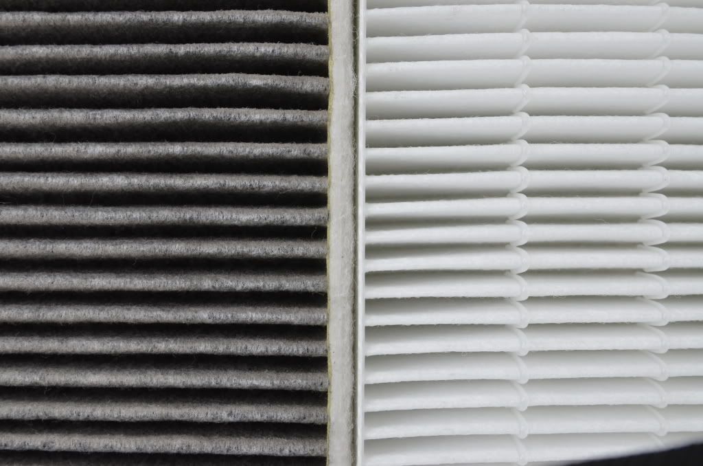

Air-con system - When you just press for air-con , you can smell a wired perfume. Please ask service center to check the air filter to get replace. The Air Filter located on left passenger glove box compartment section.

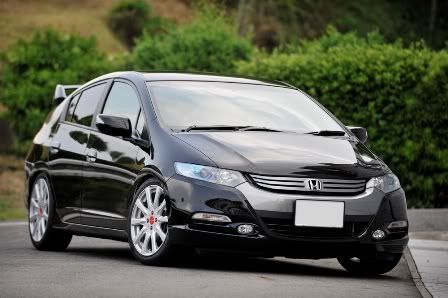

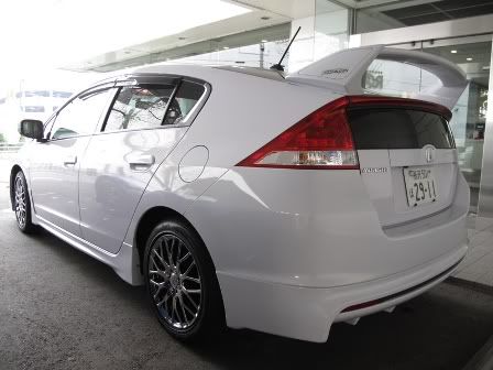

Honda Insight Official Bodykit Pic: Credit to psyeo» Click to show Spoiler - click again to hide... «
From left : Standard, Modulo & Mugen.
Source from Carview Japan

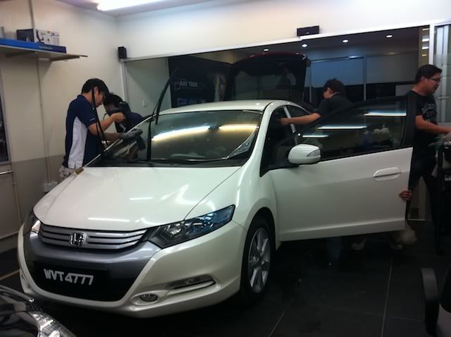

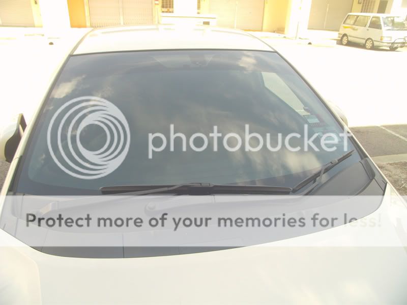

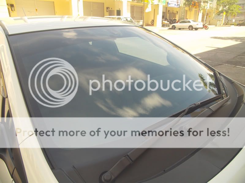

2) Tinted - Branding such as 3M, V-Kool, Ecotint, Agard , Raytech etc...

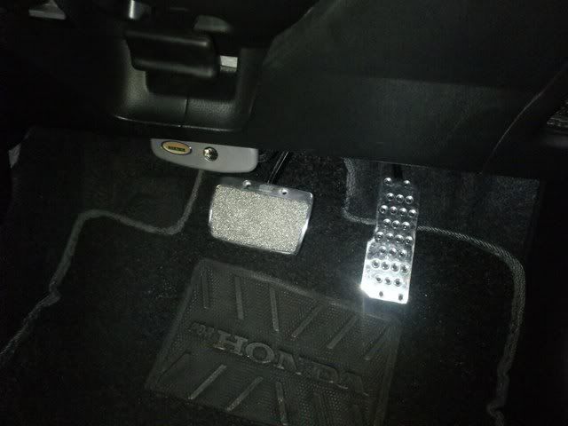

14) Add Carpet Light

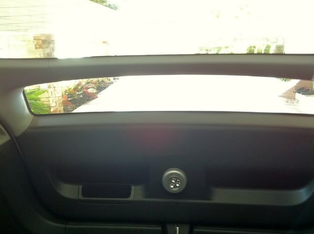

LED mod from Lowyat Members : » Click to show Spoiler - click again to hide... «
joshuawong Carpet Light
iphone Carpet Light
infinitium Philips Day Running Light & Boot Lamp on the behind
sh@rty5 Day Running Light
psyeo Boot Light

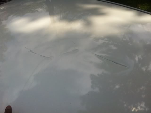

If possible don't allow service center to wash your car, especially interior.
I forgotten the reminder, I let them to wash my car (interior), after I came out from service center I only realize there is a deep scatch at the door step. If you ask me how it can happen with a shoe then i doubt! it must be some metal stuff fall on it. Or the shoe come with hard metal at the bottom. I have try to polish then still can see .

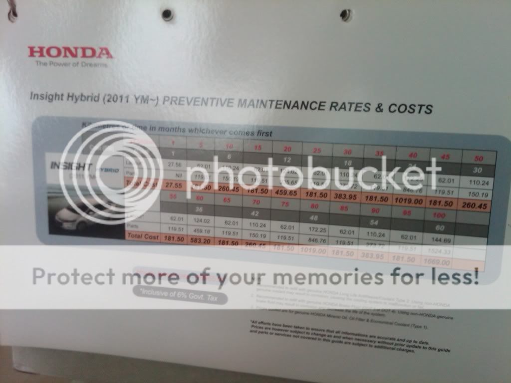

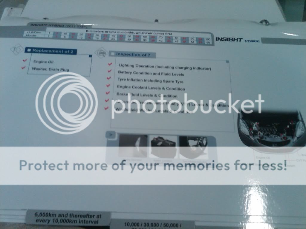

Service Maintenance Price on Honda Insight : » Click to show Spoiler - click again to hide... «

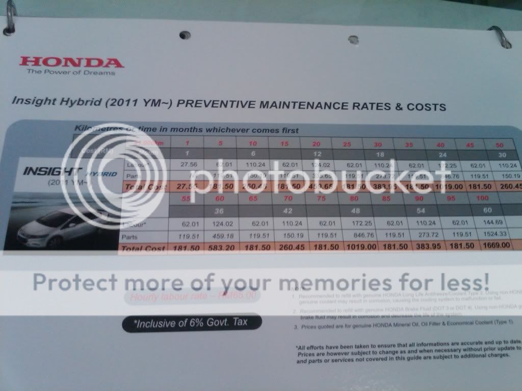

First 3 Services are free from Honda Malaysia , however member
jacek explain the 4th service charges :
QUOTE
total damage for 4th service is RM251.17
breakdown as below:
1.Labour - RM58.50
2.Engine oil - RM117.41
3.Washer Drain - RM2.10
4.Oil Filter - RM30.68
5.Alignment - RM30
6.Balancing - RM35

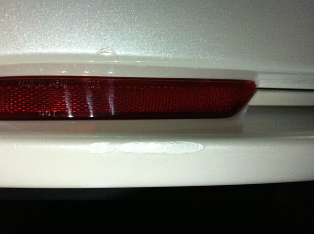

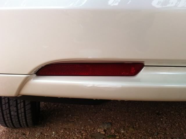

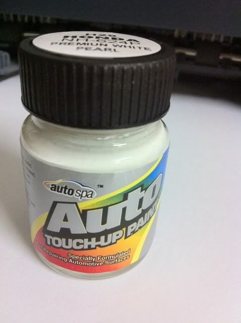

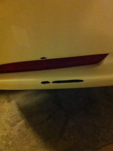

Touch Up Paint for minor scratches / lines : credits to chizzu» Click to show Spoiler - click again to hide... «
There are two brands currently selling via online or major DIY / hardware / hypermarket store.
1.
AutoSpa2.
Ezy touchupForumer
iphone advise autospa touch up paint cost RM 21.90 for Pearl White NH624P. Clear Coat cause RM 7.90. Get it from Tesco Puchong.
Forumer
iTrump show picture on Ezy touchup website quote RM 79.90 for a combo set on Basecoat, Clearcoat, Wax & Grease Removal & Rubbing Compound. Silver color combo is only RM 59.90.
Forumer
chizzu get it in Tesco Setia Alam and Tesco at Mutiara Damansara, Homefix at 1 Utama as well.
Forumer
westlife advise why not u do the touch up at the honda SC? do u know that if it is just touch up no need to pay one. of course it is not possible to cover up perfectly, at least the paint color will be closer than what you have now.
Forumer
mitmivec advise as normally it take 3 layer of coating and paint , some workshop does do a bit paint job they charge about 100++ to 200 if not mistaken will will sprey back a layer of outer coating and polish it back and it will be 90% like new
Forumer
limkj advise The SC will touch it up during your service and you can take it back the same day. I have got them to do some minor touch up on my Honda when I get some stone chips or light scratches. However as they touch it up with brush and not spray, you can still see the touch up. However, the paint Colour will match existing. So far did not charge me for it.

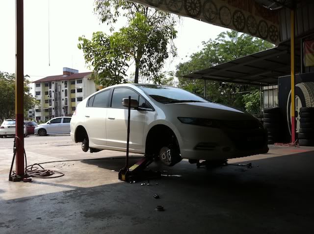

Our tyre is in series 185/55/R16 Which is Wide is 185, Height is 55 and suitable for 16 inch RIM. Spare tyre is a slim profile type and only use for temporary / short journey to go tyre shop to repair the tyre.
Price for each new tyre are below RM 300.
First batch insight ( before Tsunami ) are Dunlop 2030 series.
All latest insight are using Bridgestone Turanza ER30 series.
How to check when the tyre is produce ? There is a section only have 4 digit number. First two represent which week the tyre is made and last two digits represent the year. Ex : 1511 - Week 15 of Year 2011 ( Week 15 is in April. Each Month average have four weeks. Each Year have 53 weeks. )
