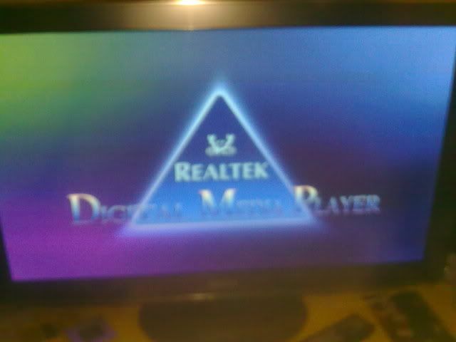

here's some screenshoot and review for 25/7/2011 V10 firmware
new boot up screen

Anyone got this problem or my player hardware got something wrong?
try reset default again. and turn off deep color.
This post has been edited by yangxi: Mar 6 2012, 01:20 AM
