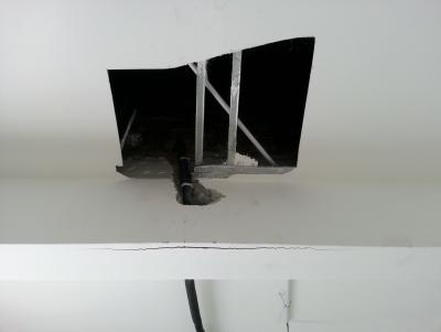

Please comment on my house conceal piping.
I'm so sad that the con broke my room/house beam. Is that serious, or just crack only?
This is in the master bedroom and second floor. My house is DS intermediate.

If unsure, ask wet work contractor and check. You may have to knock out the crack open area only can tell. Look to me is just the plastering layer. I could be wrong, only can tell after remove the crack area. If the other side no problem very likely just the plastering.

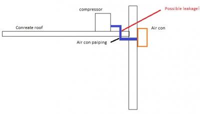

Hi , just done my conceal piping. But concern on the water leaking. They make hole on my concrete roof and lay the piping then cement it back. But not sure what cement they use but they said no worry no leaking.
For the piping out from root top, can we use the silocon to seal the gap then apply the water proof on it?

The crack layer is quite thick. If this beam is horizontal to your house, better check properly.

QUOTE(smon80 @ Nov 26 2014, 10:50 AM)
Hmmm think you should get some advice from a few contractors see what they say. So you can compare responses. Just want to be careful when you seal stuff up. A lot of times it's just masking the problem on the surface. I once had a leaky pipe concealed running from my attic that I didn't know about - it was a problem for A FEW YEARS no kidding. Until I got a guy to really do a thorough check only I managed to spot and fix it. Same thing - the earlier contractor just sealed the leaking area but didn't trace where the real problem was
