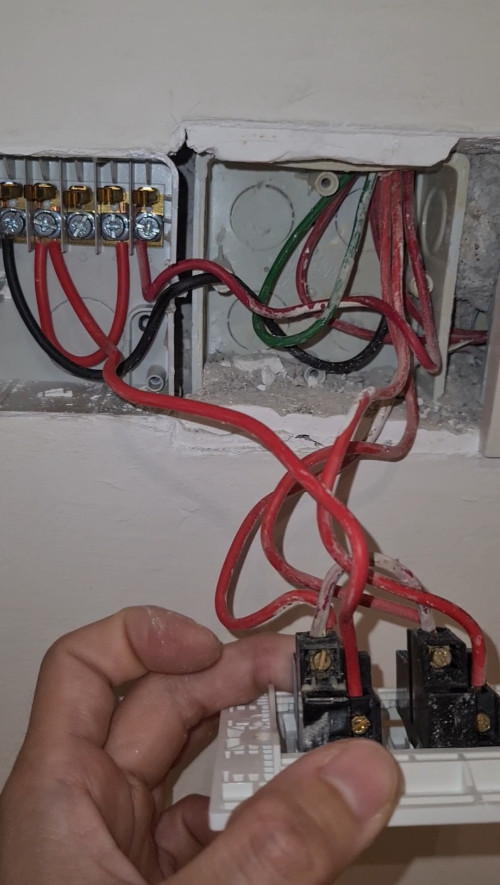

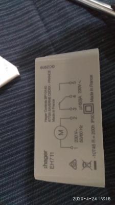

Hi bro,
Earlier on this topic conversation, someone mention the wiring should be like this
1 - Neutral
2 - Live
3 -
4 - Live
5 - Wire to light
#2 and #4 can tap together
I'm a bit confuse with the connection. When I check my switch there's only live wire.
Is that means I need to pull one neutral wire from main box and connect to #1 on the timer ? How about #5, do I need to pull one wire from light connect to #5 ?
Can some one share to me the correct connection (with pic if you can)
Current light connection sample as per picture
Thanks & Regards
https://pictr.com/images/2020/04/26/53HdKU.md.png
ozak
post Apr 26 2020, 04:22 PM
10k Club
17,019 posts
Joined: Jan 2005
QUOTE(indran_ravi @ Apr 26 2020, 04:09 PM)
Hi bro,
1 - Neutral
2 - Live
3 - <Nothing>
4 - Live
5 - Wire to light
Thanks & Regards
<a href='https://pictr.com/images/2020/04/26/53HdKU.md.png' target='_blank'>https://pictr.com/images/2020/04/26/53HdKU.md.png </a>
Back the topic, there is some pic very clearly state the wire and connection already.
