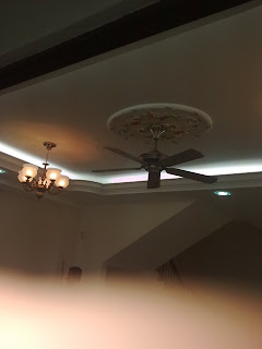

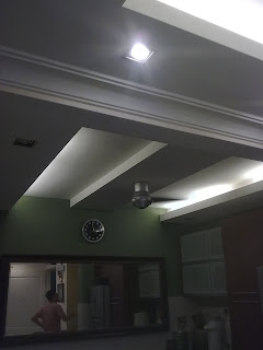

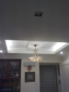

QUOTE(grubmaster @ Jan 4 2010, 01:24 AM)
This is the renovation done in my house. The workmanship is very nice and the price is reasonable (according to my dad because he deal with the contractor).  thumbup.gif
Dining Room
Entrance
Living Room
It's a Chinese contractor and it's very friendly, you can talk about anything with him so i decided to put out his number so you guys can try to have a deal with him.
His number is 016-3597215, Mr Liew.
The price for whole renovation for my house is just around 7K and i think it is worth because of his workmanship and his service.
i also engaged him to do plaster ceiling for my house. he did the job within 3 days for total area of 900++sf. the workmanship is very good. i got several quotation from another contractor and i chose him because his price is the lowest + friendly. rm2.20 psf for flat board & rm3.00 pfr for cornice. dont forget to mention my name, saiful from bukit antarabangsa if you nego with him. i believe he will give u further discount.
