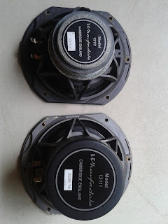

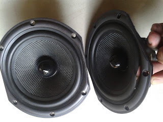

the woofer on my Diamond 9.1 koyak already. Any idea where to get replacement speaker cones?
gobiomani
post May 27 2021, 12:33 PM
709 posts
Joined: Jun 2019
QUOTE(lawrencesha @ May 24 2021, 11:24 PM)
Shopee ada, but make sure to measure properly don't just take manufacturer's specs such as 5.25" or 6.5".
Another thing to note is if you change the woofer cone then it will not be the same as the other speaker due to material type, stiffness, etc.
Best solution is to buy the entire driver and change. Can probably find it in Ebay but depends on luck whether you can find one and whether the price is worth it to you.
lawrencesha
post May 27 2021, 07:37 PM
882 posts
Joined: Nov 2004
QUOTE(gobiomani @ May 27 2021, 12:33 PM)
Cannot la. If you see the speakers, it is not round. Generic/typical speakers will not fit.
That cone is made of Kevlar, also can koyak?
Or the foam/rubber surround that koyak?
If the foam/rubber surround, can buy the parts or find shop to repair it. Don't have any recommendation though.
lawrencesha
post May 27 2021, 09:24 PM
882 posts
Joined: Nov 2004
QUOTE(xxboxx @ May 27 2021, 08:52 PM)
that what I though too. I had the rubber replaced. But then it had these cracking sound.

QUOTE(lawrencesha @ May 27 2021, 09:24 PM)
Better find shop that do speaker repair so that they can properly assess it.
If you just simply change to any other driver it would not sound same as the original driver.
voscar
post May 28 2021, 12:56 PM
1,526 posts
Joined: Dec 2005
QUOTE(lawrencesha @ May 27 2021, 07:37 PM)
Open up see what is the driver model number, Taobao got sell buy not sure same or not...
The driver cone is very obviously round. The plastic or metal moulding to fix it on the baffle is not, but it doesn't matter.
dayojah
post May 31 2021, 08:02 AM
1,276 posts
Joined: Sep 2018
From: Ampang
No way to use a generic driver there.
Your only hope is to go to a shop that can rewind the motor coil if necessary and fix the spider properly. The chances are that the rubber surround change was bodged.
