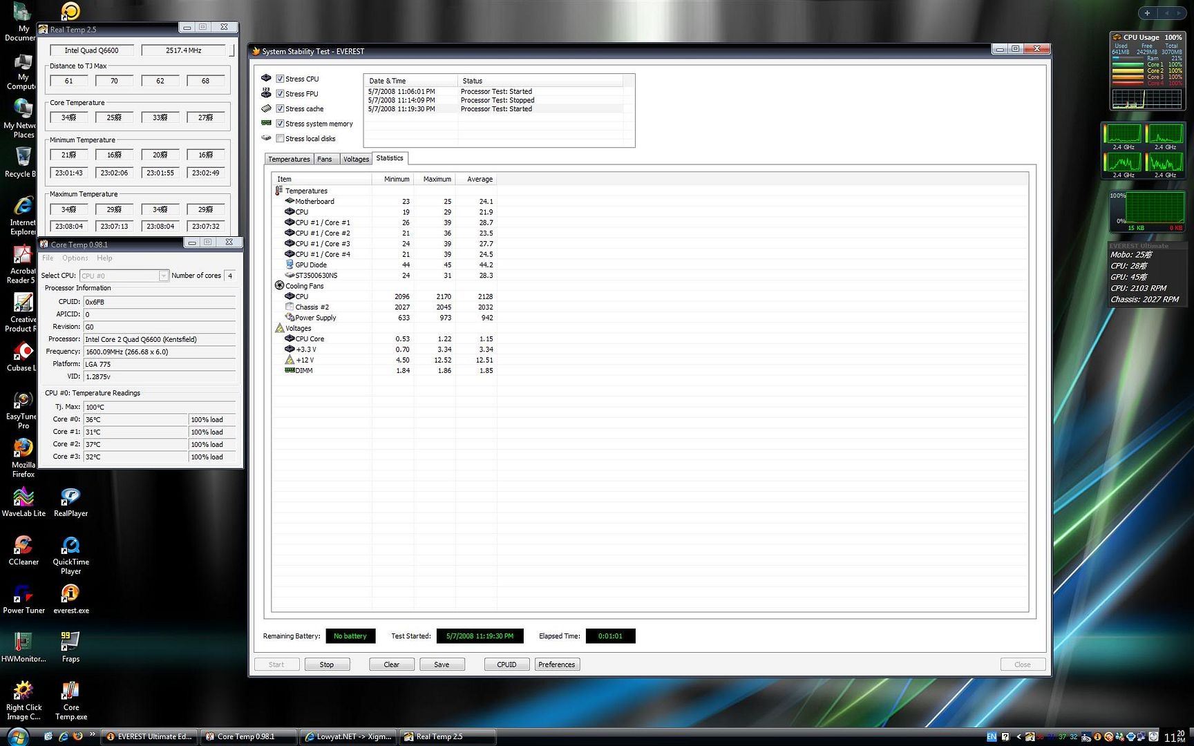

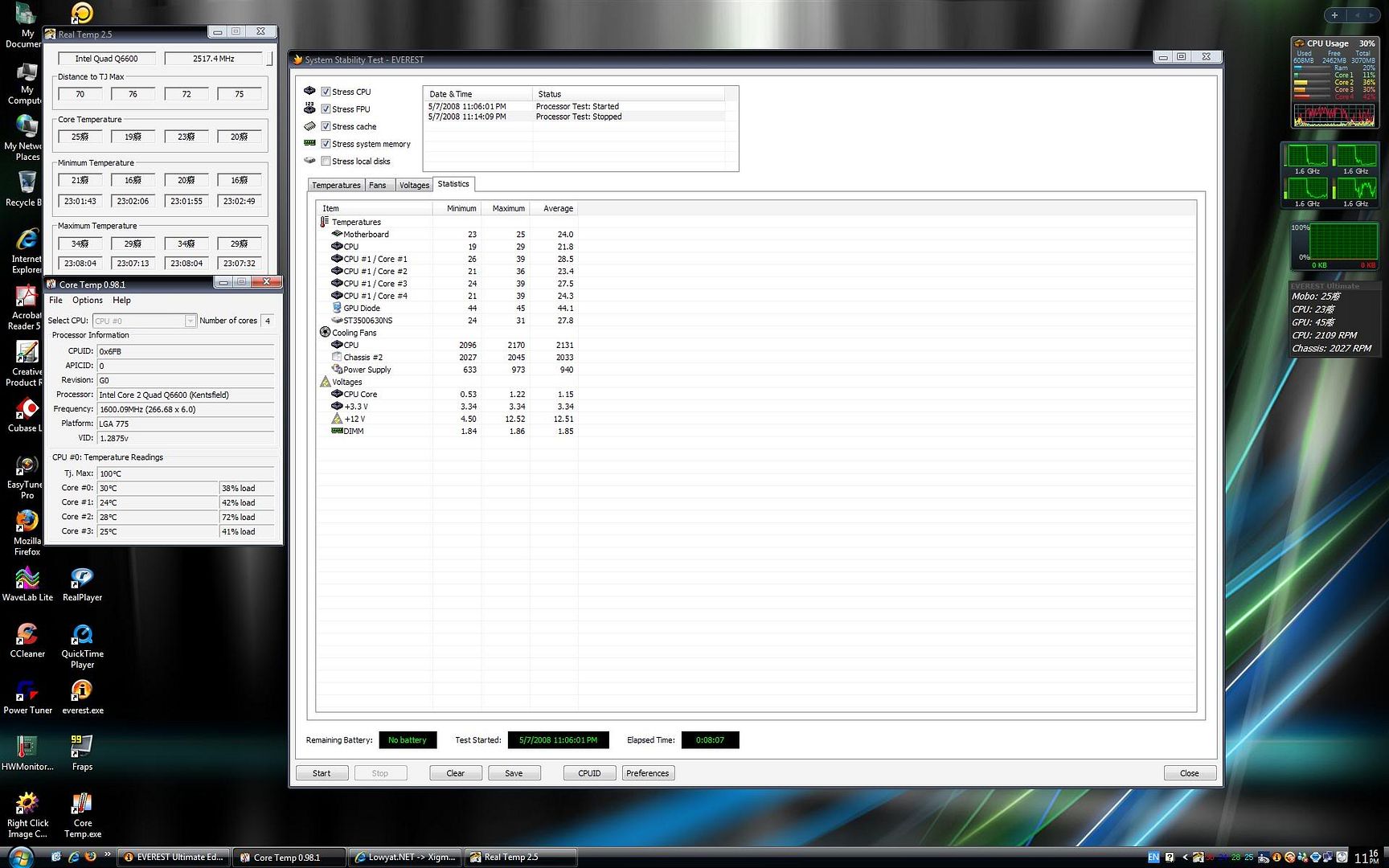

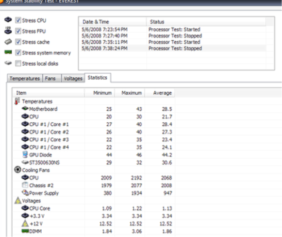

post May 6 2008, 09:36 PM
230 posts
Joined: Dec 2006
hi, i just installed the cpu cooler, at first i used rice grain method. The cpu temperature was worse than the stock heatsink (42 degree celcius idle on core). 2nd time, i use rice grain method but more, the cpu temperature did reduce until 35. Then i adjust the cooler from horizontal to vertical. Boom. the temperature decrease amazingly.
CPU=20 degree
full load 30 degree
Core= 22-27 degree
full load 35-40 degree
done in 24 degree room temp.
tompok82
post May 6 2008, 09:44 PM
467 posts
Joined: Dec 2005
From: Shah Alam
That's impossible for a processor to be cooler than the room temperature.
There must be something wrong with your temperature sensor.
tauevo
post May 6 2008, 09:46 PM
230 posts
Joined: Dec 2006
i doubt it. i use other mobo also give me similiar result.
sHawTY
post May 6 2008, 09:52 PM
Frequent Reporter
14,908 posts
Joined: Jul 2005
QUOTE(tauevo @ May 6 2008, 09:46 PM)
Well then, i'll just call the best minds and show that a processor can't be cooler than the room temperature.
empire23
post May 6 2008, 09:57 PM
Team Island Hopper
Staff
9,417 posts
From: Bladin Point, Northern Territory
Law of Thermodynamics disagrees with you. Energy In -> Energy Out.
Either your thermal diode on your processor is whack, the BIOS is whack or the reading software is whack.
Either way something is whack.
This post has been edited by empire23: May 6 2008, 09:58 PM
bryanyeo87
post May 6 2008, 10:01 PM
Below the Belt
3,175 posts
Joined: May 2006
perhaps you can download coretemp and load it up, with a SS of that, it would clarify everything smile.gif

sHawTY
post May 6 2008, 10:18 PM
Frequent Reporter
14,908 posts
Joined: Jul 2005
QUOTE(tauevo @ May 6 2008, 10:02 PM)
Should i throw away my newly bought mobo? haha
No, you just have to accept that a processor will never run at a lower temperature unless you're using a cascade / phase change / dry ice or LN2.
Even watercooling can't cool a processor than the room temperature.

tauevo
post May 7 2008, 11:26 PM
230 posts
Joined: Dec 2006
ok here is another ss.
Then this taken when room temperature is 20.5 degree on my desk. 19.4 degree on my casing. happy now? tongue.gif
This post has been edited by tauevo: May 7 2008, 11:37 PM
sHawTY
post May 8 2008, 01:13 AM
Frequent Reporter
14,908 posts
Joined: Jul 2005
QUOTE(tauevo @ May 7 2008, 11:26 PM)
Those softwares took the temperature readings from your motherboard temperature sensor, so if your motherboard temperature sensor is crippled, so as the results.
Again, if your room temperature is 20.5°C, how can your processor goes 19°C?
No matter how bad you want to prove this, you still can't defy the rules of physics.
You can't prove anything just using software temperature sensors.
Wanna prove the real temperature? Get a laser temperature sensor and shove it on your processor, from there we'll see either you can defy the rules of physics.
Also, one important note, i have a Q6600 G0 that has a very low VID, my room temperature is lower than yours, which is 18°C, i'm using watercooling, but the temperature of my Q6600 G0 is still 28°C. smile.gif
bryanyeo87
post May 8 2008, 01:26 AM
Below the Belt
3,175 posts
Joined: May 2006
@tauevo
ouh, ur referring to the CPU (without numbers one) temps is it all these while? @_@"
that one memang inaccurate, its usually 5~15c lower then core due to the nature of the DTS sensor
the one which really affects the CPU, is the DTS sensor on the core which would be CPU #1~#4
although its quite inaccurate sometimes, due to faulty being stuck (yeh i have one)
ham_revilo
post May 8 2008, 02:21 AM
I
6,583 posts
Joined: Feb 2008
bro, i think u should stress test it longer. if my eyes serve me well, u only did a 1 min test then u screen shot it. i think its not long enough for ur proc to get heated up. btw, shawty got a point there. if ur room temp is 20.5c its quite impossible to get 19c on ur proc, unless u put some dry ice or something. anyways sensors accuracy is not 100% fyi. imo the least u need to add or minus 5-10c for accurate result but in ur case i think u need to add.
