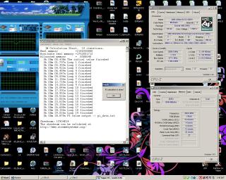

alive88
post Feb 12 2008, 11:56 AM
Pata Pata Pon! Pon Pon Pata Pon!!
1,406 posts
Joined: Jun 2007
this is a ss from my old system.the highets i can get with 2.1vdim..actual vdimm is 2.07 after 0.3voltdrop.
