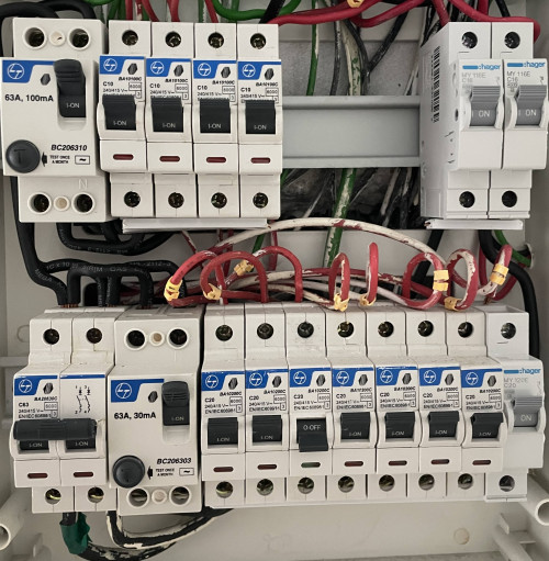

QUOTE(ceo684 @ Aug 12 2024, 02:01 AM)
It’s already sized correctly. Don’t waste money
What I would suggest is to redo the pigtails as there is a minimum bend radius (don't hard turn 90 degrees), keep the cable curved gently. Nanti patah inside and create hotspot.
I plan to change all to Hager , so i follow back all same 63a for the RCCB and 2 Pole MCB for incoming ya .

QUOTE(ceo684 @ Aug 12 2024, 02:06 AM)
Your clamp meter not true RMS is it.
One unit WH running from cold already take 14-16A easily.
The 16mm one you can buy Mega Kabel meter loose cut in the correct colours (red and black) as necessary, but if your supply (from meter) is 10mm then no point lah.
Also, not much use for the 100mA RCD when the 30mA RCD is capable for whole house sockets and lights. There is little point in using the 100mA RCD in modern day without fluorescent tube lights.
Ya i redo the reading correct already , 1 WH running around 14A .... Incoming is 16mm from meter but thn 10mm to both RCCB (100mA & 30mA)
For my WH , Developer no give RCCB / RCBO i added myself for safety .

QUOTE(13aby @ Aug 12 2024, 04:33 PM)
Sent , but no reply from them since ever haha
Yes i bought from Authorised Reseller / Distributor shop (Pentapower(M) Sdn Bhd (Puchong) & (CPE Electrical Supplier via Shopee). But they say use 4.5k is enough . Or should i change all to 6k as developer provide?
Forget the 100mA RCD (buang), rerun with 16mm inside the DB. That 10mm is only good for ard 40A and can create a hotspot which is unprotected because it is supposed to be 16mm throughout.

QUOTE(ceo684 @ Aug 12 2024, 08:11 PM)
means only use 1nos 30mA whole whole house?
The empty space is 2 nos RCCB 0.01 .. not yet install when snap this
This post has been edited by 13aby: Aug 12 2024, 09:08 PM

QUOTE(13aby @ Aug 12 2024, 09:07 PM)
Yes. According to MS1979 COP it is allowed. And safer too for changing lights.

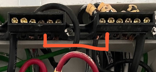

QUOTE(ceo684 @ Aug 12 2024, 10:18 PM)
My neutral bar is separated by two sides , can i connect both side by tapping a wire? or need to replace a longer bar

QUOTE(13aby @ Aug 12 2024, 10:41 PM)
Common neutral, use a 16mm Mega Kabel pigtail.

QUOTE(ceo684 @ Aug 13 2024, 02:50 AM)
U mean connect with a 16mm cable like photo ? 10mm boleh? Existing Neutral developer using 10mm for both side

QUOTE(13aby @ Aug 13 2024, 10:02 AM)
Beli lah one meter of 16mm. Less than 10 bucks per meter only. 10mm not good enough. https://s.lazada.com.my/s.PTisA

QUOTE(ceo684 @ Aug 13 2024, 10:07 AM)
16mm i got spare , so i just tap the wire to connect the both bar ya

QUOTE(13aby @ Aug 13 2024, 11:22 AM)
Yes, do a smooth horseshoe shape
if you plan to use your spare 100mA RCCB, then you cant connect both neutral bars.
100mA removed and all now using 30mA RCCB

QUOTE(13aby @ Aug 17 2024, 02:31 PM)
The MCBs should ideally use the same brand so they're the same height.

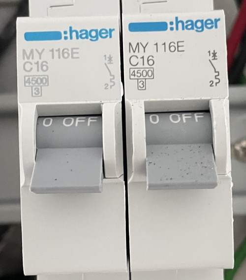

QUOTE(ceo684 @ Aug 21 2024, 12:32 PM)
ya will change all to hager , previously i test bought two mcb from 2 different seller . one of it when power off V test 7.xx 😢😢 suspect is fake .... the other one test V is 2.xx perfect ....

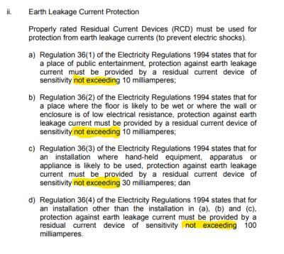

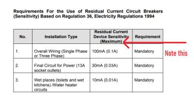

prophecus
post Aug 22 2024, 09:27 AM
157 posts
Joined: Nov 2004
From: Petaling Jayo
Developers have to comply to wiring regulation by Suruhanjaya Tenaga. 10 mA for water heater and wet area. 30 mA for sockets. 100mA for lighting and AC.
in the UK they have moved on to RCBO. No more RCCB as it is included in each circuit. So if there is leakage only individual circuit would trip not the whole house. In Malaysia RCBO is available for Water heater (20A, 10mA trip), the rest not widely available yet or price too expensive.
