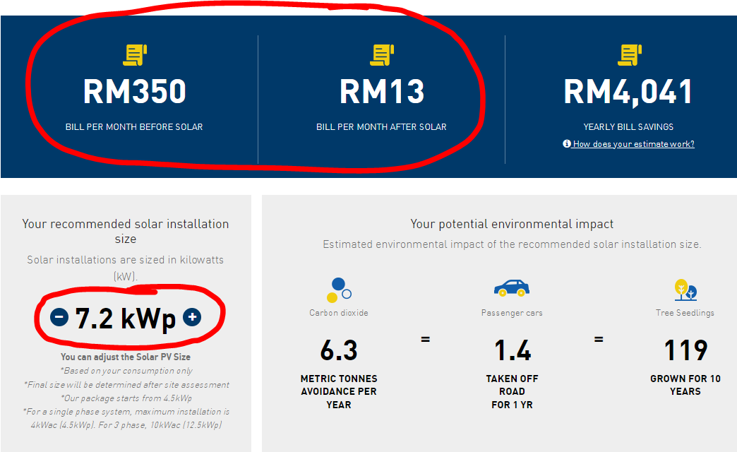

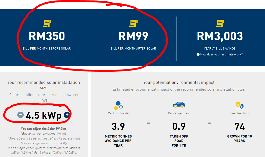

Has anyone installed TNB solar at your landed either 2-storey terrace, semi-D or bungalow? If yes, I would appreciate if you can share your experience.
From the TNB solar website calculator, the concept looks interesting. Say, if your monthly electricity bill with TNB WITHOUT SOLAR is RM350, after solar installation the bill will varies with the solar installation size that you choose.
For instance, if the monthly electricity usage or bill WITHOUT SOLAR is RM350, the following will be the equivalent bill WITH SOLAR panel:-
RM99 with 4.5kWp solar panel
RM46 with 5.8kWp solar panel
RM13 with 7.2kWp solar panel
RM0 with 9.4kWp solar panel (wow, free electricity!)
Can someone confirm if the above is achievable in real life scenario as advertised? I presume the above will apply if the solar panel is running at 100% efficiency in perfect condition as in theoretical. What if it there's not enough sun or it's the rainy season where the solar panel will not be able to perform up to the numbers as above?

My bill before installing solar is between rm400 to 500. After installing now between -rm5 to rm 150. Depend on season(rainy) and your usage. For record coming to 3rd year usage next month.
Just contact them and tell them you are interested. They will submit to you all the planning and calculation for you to refer.

Thanks and appreciated. Just trying to get more information beforehand from owners who have installed. I'm not sure how it works but was told that if the energy that the solar panel generates is more than the usage for the month, meaning there is still balance or extra energy that is unused from the solar panel, it can be carried forward to next month or something like that. Is this true? Is there an "expiry" of the carry forward of this balance?
For example, for month November 2023 the solar panel produces say RM500 but you only use RM350. The balance unused RM150, will it be carried forward to December 2023, or the following month?
Surprisingly you still need to pay RM150 for electricity bill after installing the solar panel? When you wrote -RM5, I presume you don't need to pay anything for that particular month, and the -RM5 balance is carried forward to next month. Can share what capacity of solar panel you have chosen for your house. Thanks.

Most important is what's your current monthly TNB bill? Single or 3 phase?

Current electricity bill RM150 to 250 but I guess allowing more would be better since there will be more room to play around. Previously air-conditioner is just used at night during sleep and during weekends. The living room is 2.5hp so that is only switched on when necessary usually during weekends only. If that is switched on, the electricity bill will increase a lot.
With solar, possibly used during weekdays all day without incurring much cost. Not sure if single or 3 phase.

These are very indicative and not really accurate.
You need to get yourself an effective system.
A 10kwp system can easily outperform 12kwp system with the right setup and combination. You could be paying 35k for. 10kwp system and 40k for 12kwp but the saving for 10kwp system could be way higher.
I have done several comparison of systems with my friends and have some ideas which setup is preferable and economical.
As for my own experience, I have already installed and my bill drop from 650 to rm3 my initial system is 11kwp.
