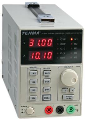

Get yourself a bench power supply. Can supply what ever rate that you want.
Just don't leave it alone as it might damage your battery.
I think TS wants a low output battery charger, yours might be too powderful for TS.. laugh.gif

Bench power supply can control the voltage and current, so it can be as TS required.
But TS kena sus d.

I bet u never use one. It's handy as you can dial up / down your voltage & current as you want. thumbsup.gif
+1 Thank you for this recommendation.
A bench power unit is costly.

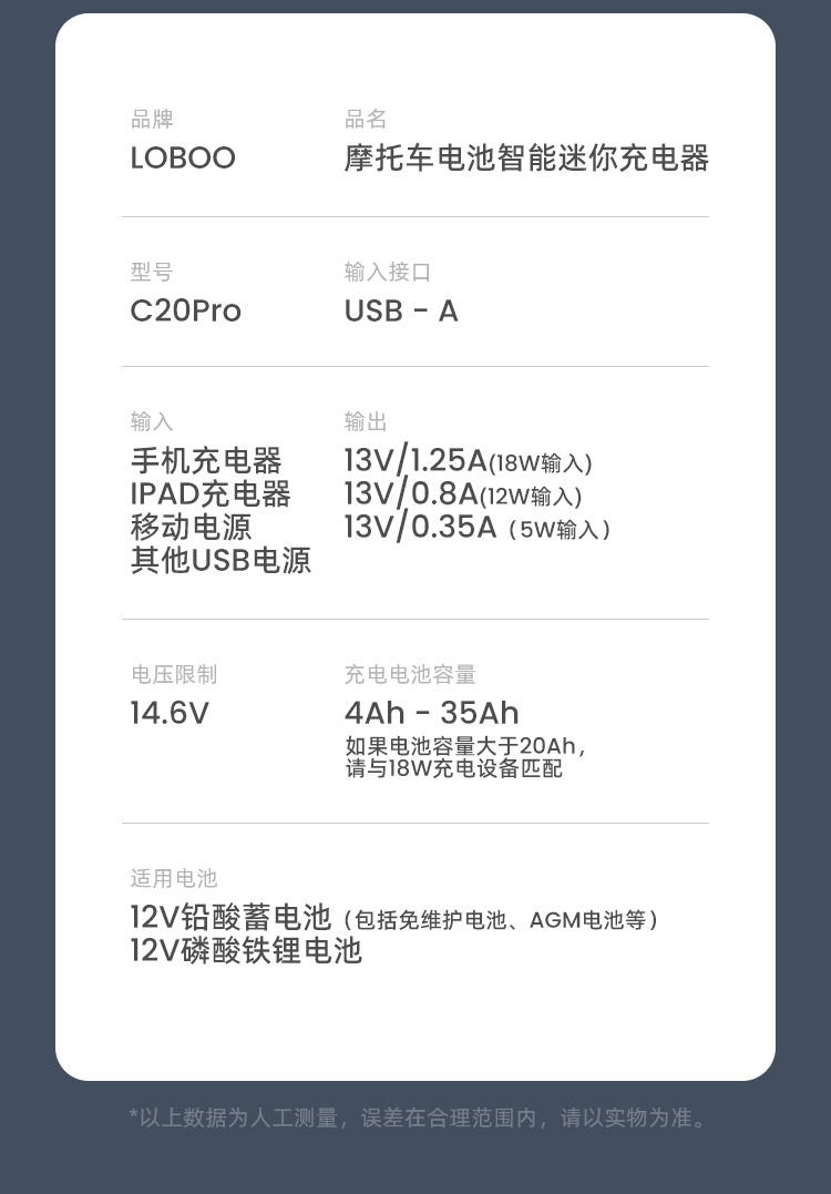

Buy this, power it with a 5V1A (5W) charger/powerbank that's widely available and cheap,
the output will meet your 0.3a requirement.
Loboo USB Charger
https://detail.tmall.com/item.htm?abbucket=...xc=taobaoSearch
https://shopee.com.my/LOBOO-motorcycle-batt...19-fb8764474bf8
Charger input output specs:
TSPikichu
post Oct 6 2024, 11:18 AM
2,278 posts
Joined: Jan 2019
QUOTE(WH4CockcooBird @ Oct 6 2024, 11:08 AM)
Loboo USB Charger
Thank you
I browse cannot find how the charger enables setting between the 3 modes.
The promo price is 162 exclude shipping, very costly to getting it wrong.
WH4CockcooBird
post Oct 6 2024, 11:20 AM
194 posts
Joined: Jul 2022
QUOTE(Pikichu @ Oct 6 2024, 11:18 AM)
Thank you
It's automatic based on input power.
That's why I mentioned, use 5A1A USB phone charger.
