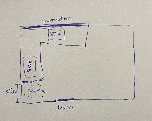

Hi,
Where did you place your gas tank? Is it ok to place it beside the hob, either in the cabinet or openly outside?
I plan to place it as in the picture below
tvcat
post Aug 19 2023, 11:59 PM
Mr. Dumb Dumb
2,935 posts
Joined: Nov 2004
QUOTE(Bijisss @ Aug 19 2023, 09:05 PM)
Hi,
I put my gas tank under the gas hob.
You can put anywhere you like as long as the gas hose is not near the fire and obstructed.
Do remember to check the gas hose at least once per year.
