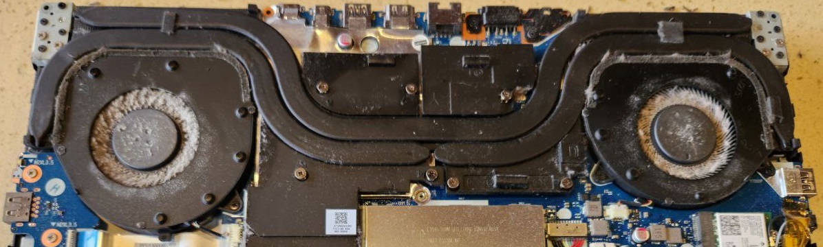

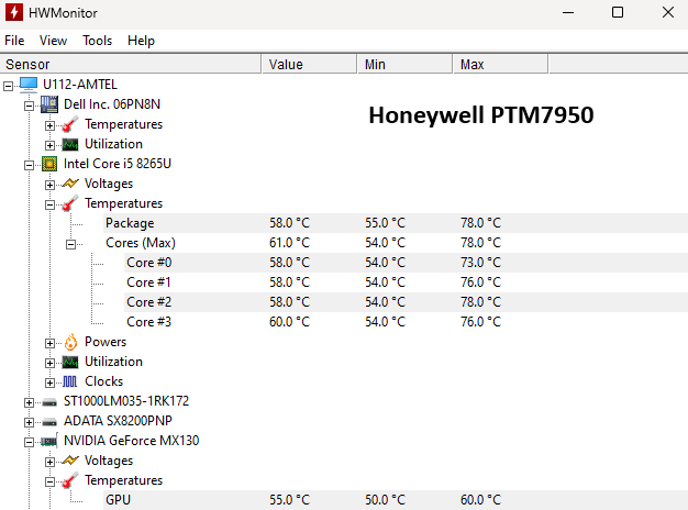

You could also try Shopee (I got mine from this seller)
Costs more than Taobao but easier to use and pay with (especially if you have coins to burn).
Shipping was also quite fast for me.

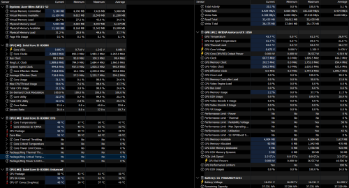

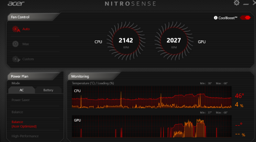

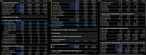

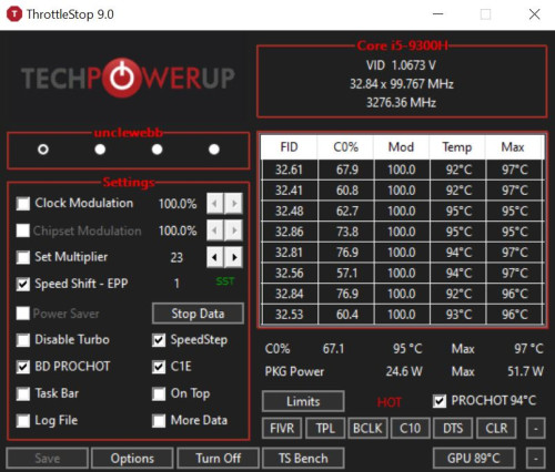

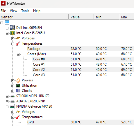

Performance-wise I think cleaning out laptop fans now and then make a big difference also.
My CPU (i5-9300H in a Lenovo Y540) before cleaning/repasting with PTM 7950:
My CPU and GPU now:
This post has been edited by Oblah: Apr 8 2024, 06:40 PM

QUOTE(Oblah @ Apr 8 2024, 06:12 PM)
Oblah
post Sep 6 2024, 10:58 AM
51 posts
Joined: Dec 2015
QUOTE(sHawTY @ Sep 5 2024, 05:40 PM)

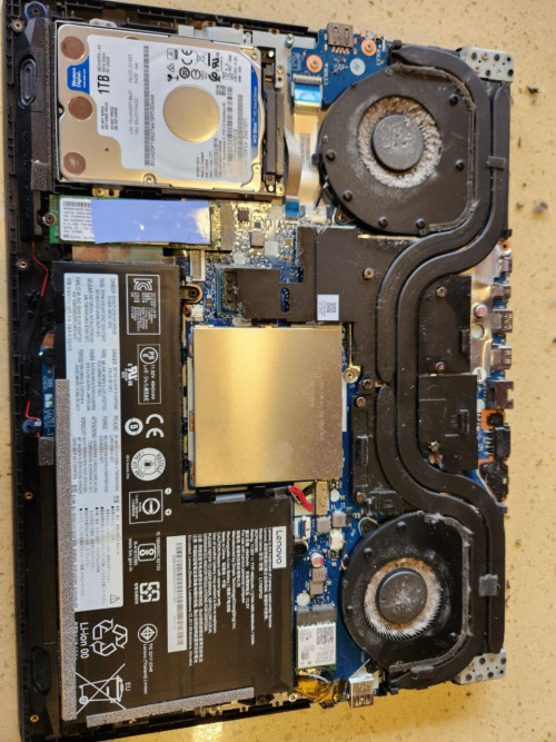

Yes, it runs much quieter now. In fact my big reductions in CPU and GPU temperatures I feel is more to cleaning out the struggling fans than the actual PTM7950.
Pasting the PTM7950, I tried the freezer method which made it easier to peel off and paste.
But end of the day my go to method to reduce wastage was to use the torn mangled bits and just tampal only.
I then just boot up my laptop for a bit to let it 'melt' into an even layer. Then just open back and readjust the paste.

QUOTE(Oblah @ Sep 6 2024, 10:58 AM)
Since your laptop is already over five years old, you might also consider replacing the fans.
Look up the fan part number on Taobao, Shopee, or Lazada, and you should be able to find a suitable replacement.

post Sep 9 2024, 11:31 AM
Frequent Reporter
14,909 posts
Joined: Jul 2005

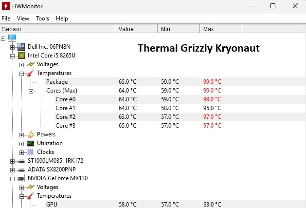

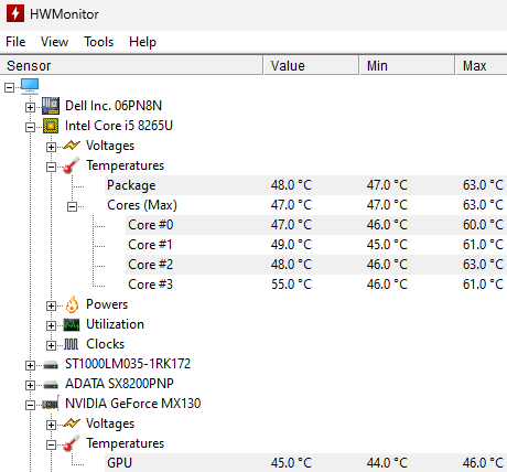

Kryonaut vs PTM7950
I didn't clean the fans or heatsinks. I simply removed the Kryonaut with alcohol and then applied the PTM7950.
I cut the PTM7950 to match the CPU and GPU die size before placing it in the freezer & the Kryonaut was freshly applied around two months ago.
pandah FYI
This post has been edited by sHawTY: Sep 9 2024, 11:40 AM
TSpandah
post Sep 9 2024, 11:46 AM
719 posts
Joined: Jul 2011
wow max temp 20 degrees difference, seems like a legit product.
Hopefully can maintain for long time.
Kryonaut only 2 months can get to 99 degree, does it pump out? Or the heavy usage makes it dry up?
sHawTY
post Sep 9 2024, 11:55 AM
Frequent Reporter
14,909 posts
Joined: Jul 2005
QUOTE(pandah @ Sep 9 2024, 11:46 AM)
It's not Kryonaut issue, it's more of my laptop fan issue where when it tries to spin more than 80%, it screeches then stop spinning
I think the fan is failing, need to replace it
I forgot to mention that the "value" temperatures is taken during idle
With the PTM7950, the fans never have to ramp up to more than 80% so my laptop never overheats unlike with Kryonaut
This post has been edited by sHawTY: Sep 9 2024, 12:45 PM

QUOTE(zero5177 @ Sep 9 2024, 01:02 PM)
So the heat conducting still seems better with PTM7950 despite both test carried with a broken fan
it definitely is because with PTM7950 the fan speed never go beyond 80%
My laptop is also a lot quieter now
This post has been edited by sHawTY: Sep 9 2024, 01:37 PM

post Sep 10 2024, 06:24 PM
Frequent Reporter
14,909 posts
Joined: Jul 2005

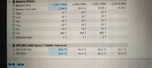

sHawTY

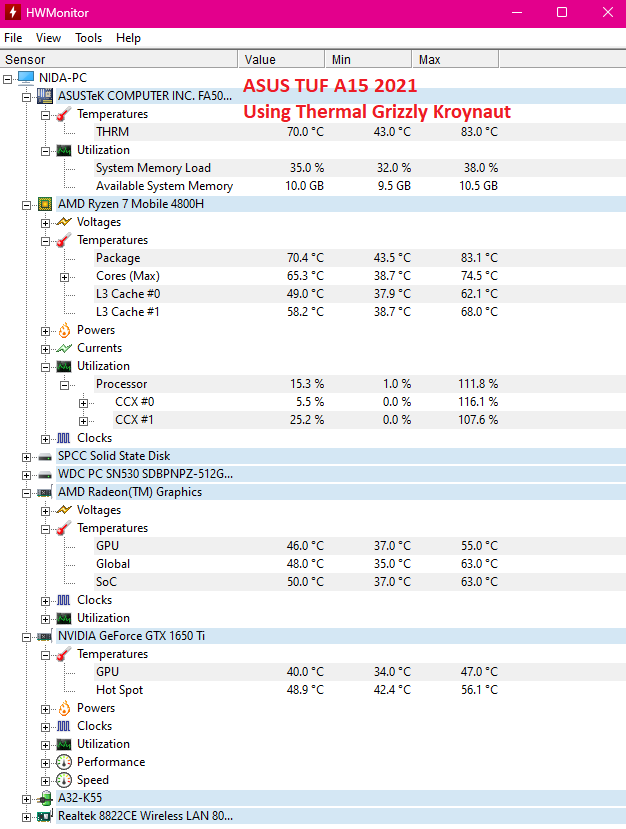

QUOTE(sHawTY @ Sep 13 2024, 10:48 AM)
My previous model similar to your spec changed to kryonaut grizzly also seen drastic change from 95c dropped to 70c+

QUOTE(sHawTY @ Sep 13 2024, 11:56 AM)
No, still using the old one
New fan ordered from Taobao, haven’t arrived yet
Can’t wait to apply PTM7950 on my wife’s ASUS TUF A16 (year 2021)
It’s still using the stock thermal paste
That'll be interesting! TUF heat up a lot

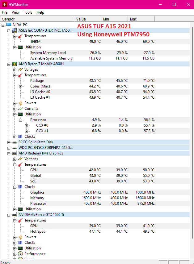

sHawTY
post Sep 20 2024, 05:27 PM
Frequent Reporter
14,909 posts
Joined: Jul 2005
Has anyone else noticed temperature changes after switching to PTM7950? I'd love to hear how much of a difference it made in your setups!
It would be especially helpful if someone could share their temps when using this on a desktop CPU with an IHS.

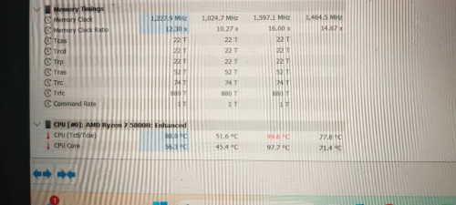

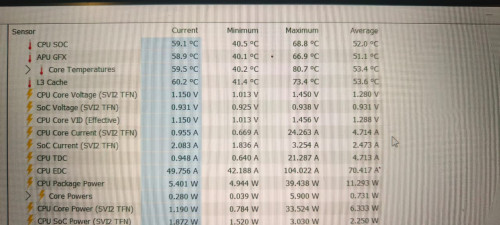

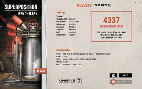

Joining in the bandwagon as well. Been looking up for good thermal paste as gaming laptops really cook hard.
Device using: Acer Nitro 5 AN515-52 i58300h / GTX1050 4GB.
Initially I got a China unknown brand but highly reviewed on shopee, LK-17 which is said to have a thermal conductivity rating of 17W/mk.
First few month was doing great, but overall the laptop ran cooler despite for a mere cost of RM20 5g syringe. Both CPU GPU did not reach, say, 70-75 celsius under Acer Nitro balanced power profile. but when set to "Performance mode", it will spike to 79-85 celsius range, which is better than before repaste which could send it flying to 99.
After 2-3 months of using LK-17, things start to change abit, even on idling, it will spike to 50-55 celsius compared to initial stages as it would be always be below 50 no matter what profile I set.
So the time came, told myself what the heck, bought a 40x40mm PTM 7950 at RM16 (inclusive of shipping).
Not easy to apply on the chip dies, and not the fanciest despite putting it inside the refrigerator for 30mins.
Here is the results of using PTM 7950 for my Acer Nitro 5.
BEFORE:
AFTER:
CPU still can spike to 80+ range if I turn on performance mode, but under Acer Balance profile, I can see a difference of 4-5 celsius compared to using LK-17 when running Unigine Superposition Benchmark.
Also did for another laptop, Lenovo Ideapad Gaming 3 15AHC6/ RTX 3050, this thing can even cook up to 99 celsius during EXTREME test in Unigine.
BEFORE:
AFTER:
Will be monitoring it for a few more weeks/months to see if there's improvement as what they always said online.
This post has been edited by Omochao: Nov 28 2024, 07:07 AM

Done another round of Extreme and then back to Medium settings for my Acer Nitro 5.
Both cores stabilize under 70 celsius after sustaining non stop of 2 rounds heating.

Under ambient temp of 23 celsius air conditioned room.
Even the fans will turn to 0 RPM and running very silent under normal idling. Can hit as low as 36 celsius and idling hovering around 40-49 celsius which is really good temps IMO. Under load should be below 60 celsius, haven't really push for gaming as I don't really game nowadays, but with benchmark tools like superposition unigine, gpu and cpu still below 80 celsius which is very considerably good and nice.
With normal Malaysian weather, the cpu temps will hover around 47-49 celsius. No more thermal paste from now onwards.
also did a disable "Processor performance boost mode" under windows 11 power options.
Not trying to say the normal standard thermal is not good, but from using default stock paste which could made my laptop run 55-60++ celsius, now I can get better heat dissipation with this PTM 7950 thermal phase change paste. Highly recommended despite having a flawed heat sink where the gpu and cpu is interconnected.
Highly suggest that anyone who wants to change their laptop or mobile device paste should really go for this PTM 7950, no point buying Artic or Grizzly but then in the long run face pump out and degradation over time.

Recently, whenever I turned on my laptop, i notice my fan will like ramp up to a certain speed compared to last time when I was still using paste, initially assume that the PTM I used was a fake, then I just remembered reading from reddit, that some people after repasting with PTM , need to re-tighten the heat sink screws again as the sheet might have flatten down a bit and thus causing less contact with the heatsink and the chip die.
So just now, took apart and tightened it slightly and make sure that the screws have no more turns.
Did another round of test, and even with performance mode, the temp won't spike even to 70-80celsius for the CPU.
Hopefully this PTM last long and I don't have to take apart for a long time to repaste.

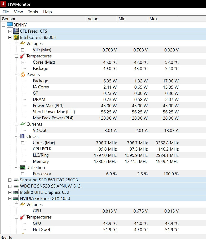

Almost forgotten to share another use case for another laptop in which i did for a Lenovo Ideapad Gaming 3 with Ryzen 7 5800H / RTX 3060.
Reopened it and try to tighten back the heat sink screw, but doesn't seems to be the case as I can only feel that the turns for the screw not much and don't want to risk stripping off the screw.
Run another Unigine Superposition test, with 1080p HIGH settings. And all I could say I'm really impressed by the thermals being done by this PTM 7950. All readings for both CPU GPU didn't even hit 70c at all
Laptop power options - Balance mode, with processor boost management set to disabled. Maximum processor set to 99%

Yet another success story after switching to Honeywell PTM7950!
Before:
After:
This post has been edited by sHawTY: Feb 26 2025, 02:24 PM

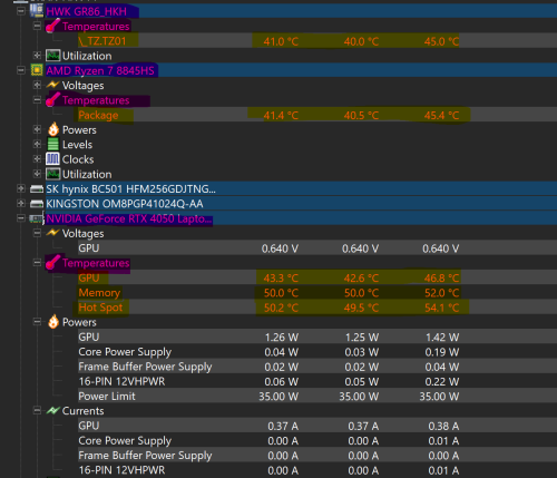

post Nov 2 2025, 11:35 AM
835 posts
Joined: Nov 2007
From: Land of Forgotten
Recently got myself a used laptop which is still fairly new. Acer Nitro V14 RTX 4050 with Ryzen 7 8845hs
Stock thermal paste by Acer was doing fine and could reach 42c on CPU / 43c on GPU, and was hovering around there.
Re-ordered PTM 7950 from the same previous seller. Did a repaste with full change on the even stock thermal putty with UPsiren UTP-8.
Temperature soared to 50-55 even in an airconditioned room ambient temp of 22c, thinking that it might be fake PTM this time, redo again for it and readjusted the thickness of putty and readjustment of PTM 7950.
End up same issue.
Then I notice that my heat sink is showing sign of thermal paste forming a square shape with the middle of the heatsink seems to be empty and has less contact of the thermal paste.
Silly me, must be that when I tighten down the heatsink, i press on it lightly and over screw too tight.
After rectifying all of it, here is the ambient temperature.
Will be sharing back on the feed back later with photos for my previous Acer Nitro 5 which was done almost 1 year ago. paste was still strong before I redo yesterday night.

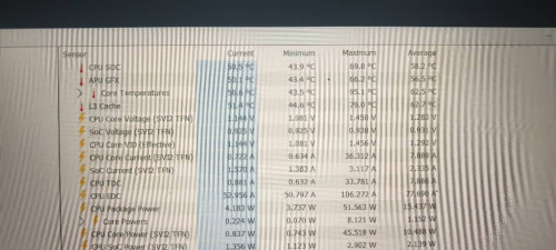

Omochao
post Nov 2 2025, 04:04 PM
835 posts
Joined: Nov 2007
Acer Nitro 5 AN515-52.
Idling/disable Turbo boost, under room temperature.
PTM 7950 is the only truly a good thermal solution besides LM.
This time no more retighten screws, just screw nicely and not too hard. let the sheet bond itself between the die chip and heatsink.
And true enough temperature is better.
This post has been edited by Omochao: Nov 2 2025, 04:07 PM

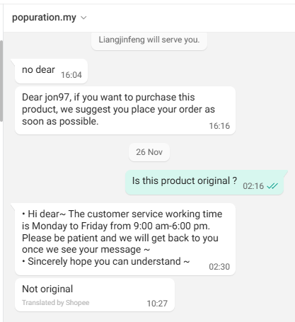

I randomly ask the seller is this product ori and this is his replay.. not sure is it true or trolling.
I ended up buying from (Not sure is it ori too but it works)
https://www.lazada.com.my/products/i3764324...ls.item_title.1

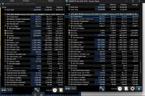

Gigabyte RTX 3070 Ti Gaming OC thermals like shit and no room for OC since brand new. 2 years later, it started to crash due to hotspot temp. Did everything till today I decided to change the thermal pad and paste.
Original thermal pad and paste seem to be low quality lol.
Changed to PTM 9750 (not sure original or not) & some thermal pad I bought from Taobao and heres the result.
Product:
Thermal pad (1mm & 2mm)
PTM7950
This post has been edited by JON97: Dec 8 2025, 06:37 PM

Err the seller just confessed it aint original, likely a Chinese branded clone. As long as its a grade A clone and installed properly it will prolly work liked ori in the start but will degrade faster with time so your not able to see any diff for now. Enjoy it while you can but you might be changing out sooner than later. For better or worse do keep us updated your usage.
