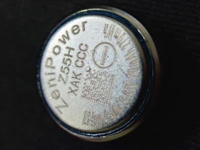

Just DIY change battery for my XM3 and XM4 lately. XM3 is easy to pry open. XM4 need a heat gun to loossen the glue. I think the earbuds can last for few years like the wired headset if we can change the battery ourselves.

I just googled the battery for XM4. Wow it looks like a watch battery, but rechargeable.

QUOTE(penmarker @ Aug 20 2024, 10:38 AM)
yes, button battery.

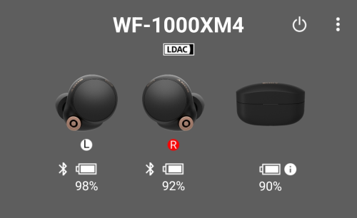

yes. i just changed battery by myself.. easy & cost effective.. now working fine as usual/stronger again
