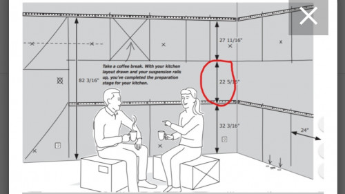

QUOTE(kimteck @ Dec 18 2021, 03:57 PM)
2. Last minute work and demand you to reply/agree where work about to commence within 1- 2 days
3. Didn't go through the details of the drawings , and I had to go through myself. When you asking for some clarification, she answered I already sent you the info right.
If you overlook it, jialat. Like what I overlooked the distance from kitchen countertop to wall hung base cabinet as I trusted her profession .. ( I had 8++ mm..) . Later I found up my ideal distance is 760 mm
4. I spot a few mistakes in the drawings, and she has never admitted.

Thanks a lot sharing your experience with me ! May I know what's the distance from your kitchen countertop to base of the wall hung cabinet ?
800mm + too-, some of the parts, e.g. the ball bearing drawer slides, are standard size. Even disk washers that some people put below the kitchen counter are designed around this size.

QUOTE(ongss @ Jan 8 2022, 01:29 PM)
The circled distance also 800mm +?

QUOTE(kimteck @ Jan 8 2022, 02:48 PM)
Opp, I might have misunderstand your statement. I am too used to the idea of 800mm.
No, for that area, my current apartment is the same like the drawing i.e. 22" / 560mm.
The drawing is 27 11/16" + 22" + 32 3/16" and mine is 30" (760mm) + 22" (560mm) + 33 7/8" (860mm actually 60 is for platform, the cabinet is 800mm tall only).
Previously, when I had that design, it was due to the height of the sliding door separate my kitchen from dining and living room. I think they will try to match the height of the door enter your kitchen and the cabinet.

QUOTE(ongss @ Jan 8 2022, 08:04 PM)
I have 33 5/58" + 32 9/32 " (820mm) + 35 7/16" (100mm as platform). And I was blamed for changing their measurement..

QUOTE(kimteck @ Jan 9 2022, 02:07 PM)
820mm - I think that is too high even if you are using those pull down shelves.
You should ask her to fix it or you go to consumer tribunal to complain

QUOTE(ongss @ Jan 9 2022, 05:54 PM)
https://www.kpdnhep.gov.my/en/consumerism/c...-procedure.html
I requested to change , same goes to gas stove countertop , 900mm, with wok stand height, my wok will be placed at 968mm , how to carry the stainless steel wok when cooking ?
Now saying I'm changing the drawings , so have to delay the project till the drawings is fixed. I am now the one being blamed by architect due to her 'no common sense ' design. Pity me
