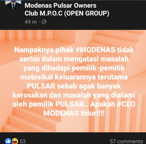

sammm33
post Mar 6 2022, 12:09 AM
684 posts
Joined: Sep 2007
QUOTE(ZZR-Pilot @ Mar 5 2022, 10:51 PM)
While nobody's expecting to get Honda quality at Bajaj prices, that's no excuse to put up with a grossly DEFECTIVE product.
I was willing to close both eyes if the defects were cosmetic or minor, like the tank badge that peeled off the day I rode it out of the showroom. But stuff like faulty ABS units etc that render the bike unrideable are just not acceptable by any standard.
"Ko nak menyalak buatpa, bodo. Claim je la pastu tolong diam," that was the reply I got from these guys. So yeah OK... then what happens when the warranty runs out & you can no longer claim? By their own logic, you just get rid of it lah... and that's what I did.
Glad to have left all that behind me. What a nightmare.
totally agree . to be honest my 1st thought was glad that you or anyone that riding that bike was unharmed due to that faulty abs.
my guessing is that these people at brand M / B, betting on these "cut costed" part , ditching quality and QC.
they definitely went through all the parts , and decide which part can be fit in using the cheapest and lowest quality part for profit sake.
i know im making assumptions here but as a user i can see a lot of part is very poor quality.
and you know why they dare to reply like that ?
cuz they know most of the people that purchase this bike will do the exact same thing, keeping silent or just swipe it aside and go fix them self.
any kind of question/argument bout the quality will be shutdown by " the bike so cheap , apasal still mao complain/minta lebih ? "
hell, i even get that exact same answer for just suggest that this bike will be better if can have a bigger gas tank.
so i cannot even suggest some improvement ?? seriously ??
you cannot talk anything bad about this bike , not even suggesting some improvement.
especially the front fork seal leaking , that is clearly a defect, and majority owner is experiencing it.
and you know what that brand M did ?
they launch a few days event , so called "walk in and replace fork seal" at their subang SC , very short duration of time,
and then end it with something like "due to very less people actually came for replace, hence this fork seal leaking issue is not major".
mind you their so called walk in to fix this issue is short to no notice in the media , no call or what so ever to me despite i was in the waiting list for fork seal replacement, and those that get the news mostly was circulated within their so called official groups.
how they conclude this issue really is something .

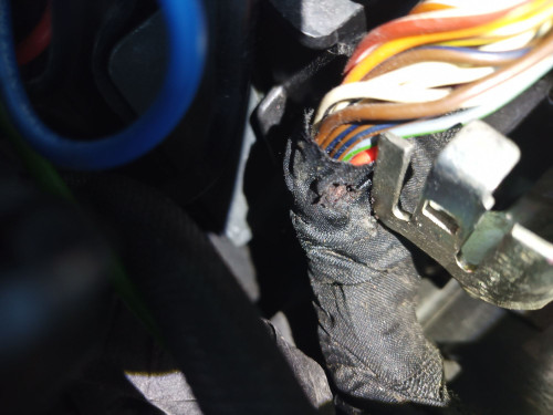

Lost my rear signal indicators. Stopped working. Maybe for the last few days.
Front ones work fine. Flasher relay is fine. Checked all the connections, all seem ok. Very very odd problem. Very rare to have both go out.
Front left signal flashes fine when bike not running, but flashes erratically when bike running. Just happened today which is why I noticed the rears are out too.
Really really weird.

Figured out the problem.
It's a Modenas problem. When the bike was assembled, the rear signal wires were not placed properly so when my rear givi pannier racks were installed, they crushed the resistor packs on both lamps. Not the fault of the foreman either..since there is no way for him to see where the wires were.
Just ordered new signal lamps..will do it myself this time around. Properly.

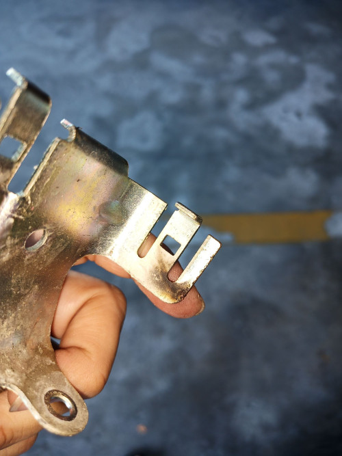

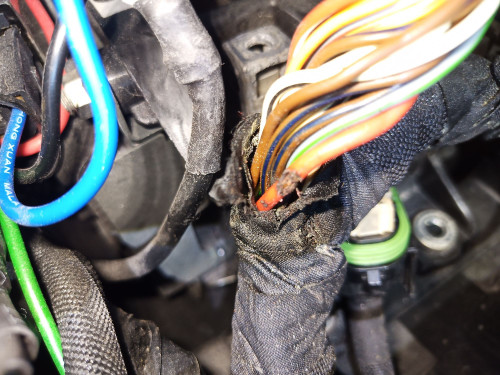

Public service announcement

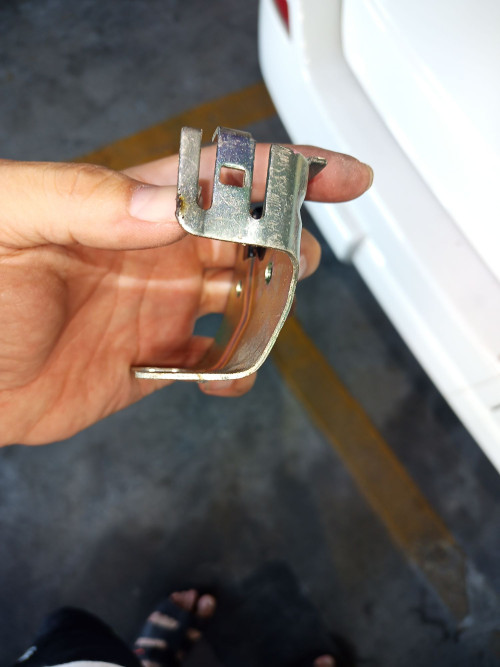

For owners that ride the bikes on trails please take note. I highly doubt there are many who takes Thier Dominar off road as much as I do so I will just leave this here for reference.
I landed a small jump and the bike just stalled and won't idle. Initially I thought the side stand switch or I sucked in air as I was running low on gas. It continued to run like shit for the next few km, and stalling.
However on closer inspection, it was something more serious. The fuse box bracket had eaten through the wire harness insulation and causing a short. It could very well be a fire hazard if not caught early. Would have brought new meaning to the term hot seat.
Fortunately I managed to find the issue and do the repair. Also bent the bracket out a bit and zip tied the harness clear of the bracket.
So if you ride hard, take note.
Late 2018 facelift model, 30k on the clock.
This post has been edited by jaycee1: Aug 8 2022, 02:07 PM

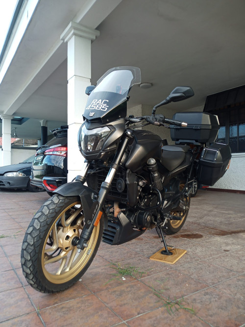

QUOTE(007SMH @ Aug 8 2022, 10:26 PM)
Damn bro ~ you hardcore , I never took my D400 off road before hahaha ! How was the experience anyway ?

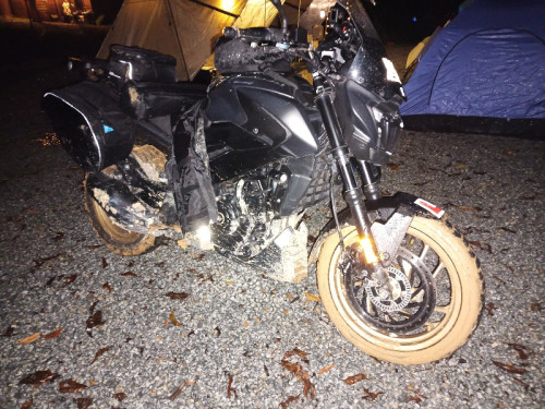

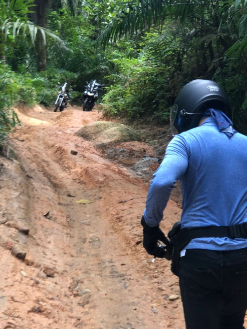

Limited to gravel, broken tarmac to slightly rocky and sometimes muddy single track trails. Have to work around the bikes limited suspension travel, weight, ground clearance and 30/70 ADV tyres. Arguable it's not the correct bike for these as a lighter enduro/dual sport will be more suitable, especially when equipped with knobbies.
But it does get me to off-road campsites and it is fun doing sandy and gravelly ladang sawit trails where you can slide the tail out and have fun.
https://youtu.be/5hw-y0pEDKc
You can check out my gravel rides. That is an example of an easy trail at ladang sawit roads.
Some of the more hardcore trails I had the Dominar on
This post has been edited by jaycee1: Aug 9 2022, 10:11 AM

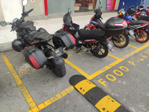

QUOTE(jaycee1 @ Aug 9 2022, 09:55 AM)

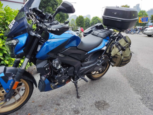

Nice side bags drool.gif Do you mind sharing the model and brand?
Plan on getting side box/bags for my ns200.
TSVi Merkz
post Aug 21 2022, 03:02 AM
2 posts
Joined: Oct 2021
QUOTE(Sammy6 @ Aug 21 2022, 02:08 AM)
If im not wrong, its the Komine saddle bag, sold in shopee. Its good for occasional travel, huge storage. But it sags over time unless you fit a sidebox bracket to support it. For daily use id still recommend a sidebox.
jaycee1
post Aug 21 2022, 03:31 PM
AFK
2,484 posts
Joined: Jul 2008

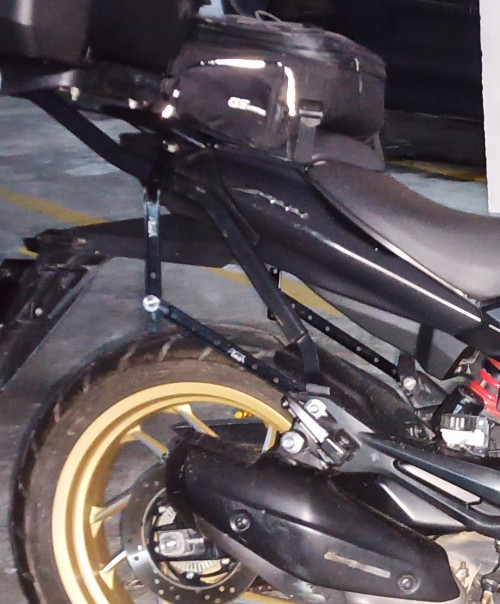

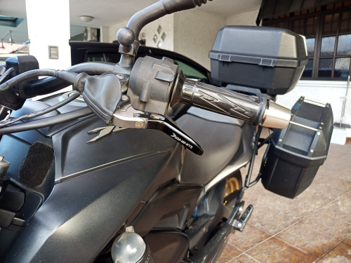

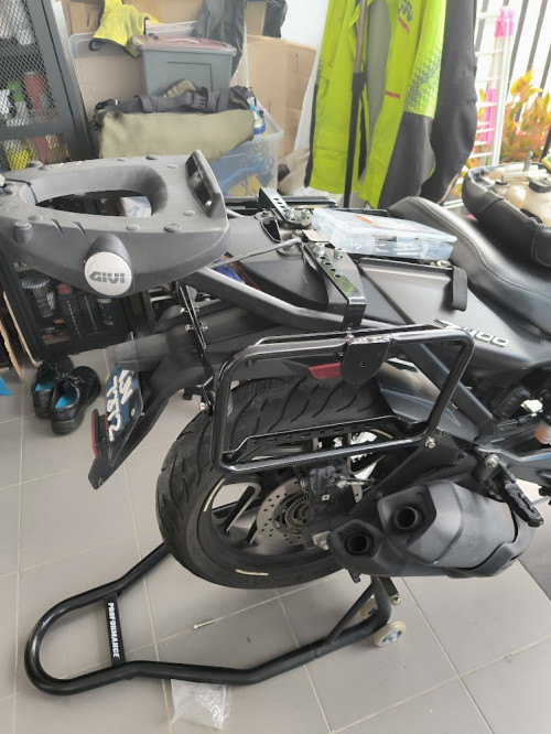

Look below.

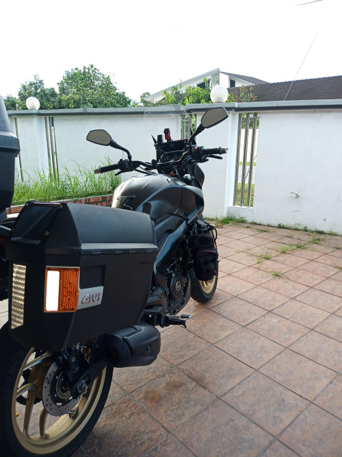

But I have since installed proper Givi rack/panniers. Got a good deal on new unused " 2nd hand set" for cheap.
I bought the "Komine" saddlebags because they were on sale, paid less than 100rm online and as a temp solution as I didn't yet find a deal/design I liked for a more permanent setup.
The other thing is, on my bike it sits flush with the handlebars so filtering is not an issue. My new givi panniers stick out 5cm each side more, so need extra care when filtering.

I added 2 simple aluminium exhaust hangers to give the sidebags a little more support. A few ringgit for them and a few nuts/bolts. Simple DIY.
Only works if you already got the givi heavy duty topbox rack
[url=https://pictr.com/image/BsUng1]
user posted image[/url]
"New" givi rack/panniers. Paid 600 for the set of rack+ cases. Just too bad, the budget line of givi panniers all look like shit. Basically only 3-4 options in the market.
This post has been edited by jaycee1: Aug 21 2022, 03:45 PM

QUOTE(jaycee1 @ Aug 21 2022, 03:31 PM)
Look below.
Indeed it is.
yeah man, the premium one goes 3k+ for the givis. And there isnt much options either in the market currently, aside from stuff like Shads. I gave up looking for nice sideboxes haha. They are either not the size i want, too expensive to justify or too ugly.
I did some custom bracket for my "komine" as well previously as i really like how it looks and you can even fit a full face once expanded. While the bracket lasts, the fabric does and turned ugly from sun exposure. At one point i even considered getting the original Komine instead of the fakes thats flooding our market, all in all, i settled with the china V35 sideboxes.
Custom fitted the brackets for an extra touch of tardiness as well

Owners long term review.
Dominar D400 V1 "Facelift". Matte black, gold wheels. late 2019 model. Bought in March 2021 (used).
Reason for bike.
I decided to get back to biking after more than 20 years off it. Had to get one as a practice bike for my B Full test and wanted something that I can commute for work as well as do my bi-monthly trips back to Ipoh hometown. Being a beater/high use bike, I needed something cheap, cheap to maintain, repair and run and easy to source parts. This bike would also double as my primary recreation transport for my camping trips, both on and off road. Made a few trips up Thailand, solo.
Main reason is for cost savings, both for Toll/petrol and Time. My estimated ROI for the bike was 3 years. But it has ROI in 2 years, so the bike is essentially "free". Depreciation is a non-issue for me.
Intention was to buy a new bike after shopping around but found a very lightly used trade-in unit for 8500 with 3600kms on the clock.
Giving my requirements and riding, i'm pretty happy with the bike, and likely keep it for quite some time even after a get a bigger bike. This will serve as my daily beater and off road bike.
Current Mileage : 61,000+ (Average about 22-25k /year)
Riding style : Hard. Bang in limiter gear in gear out, redline everyday. Off road, gravel, mud. Dropped over 100 times.
Things I like
1) Good mid range engine response for a small engine. Power delivery is perky albeit 2 step from 5000rpm
2) Long wheelbase and stable highway ride characteristics. Is not affected by crosswind or lorry wake
3) comfortable riding ergonomics. Definately touring capable (if not for the vibration and lack of power)
4) Handling in corners is very decent and acceptable given its long wheelbase and weight
5) Very very cheap bike to buy and run. Very easy to find parts. Service every 5000km, Takes 1.7L of oil. This trumps all the negatives below. Fuel economy is a mixed bag. i'm averaging between 18 - 20km/L. at constant high speed, it would empty the tank in about 140km.
6) long wheelbase and single cyc, makes for an entertaining ride on gravel, easy to slide the tail out without overcooking it.
Things I dont like
1) Weight. Its a heavy bike for a 400. As she sits with accessories, she is slightly north of 200kg
2) Vibration. Its a big single. It vibrates, and badly past 7000rpm. Heavier bar ends have somewhat reduced handlebar vibes.
3) Throttle a bit on/off at first 10-15% leading to difficulty riding smoothly at low throttle opening
4) Top heavy build and relatively high CoG. Slightly less balanced at low speed.
5) Very very short geared. Highly recommend to sprocket down (i'm down to 42 from stock 45)
6) Soft suspension, lack of travel, a bit wallowy at high speed corners , short of foot peg clearance,,,(to be fair, this isnt a sports bike)
7) no top speed. Even with smaller rear sprocket, it maxes out around 160-170 on the meter (about 158 on GPS) depends on how many boxes i have mounted
8) lack of carrying capacity. Max load I think is only 150kg. Might be challenging if you travel with pillion and luggage. Rear preload maxed.
9) difficulty finding semi off road tyres for stock size (but this is something of concern if you do take it off road)
10) ABS a bit slow reacting. Once it engages, it take a while for it to disengage. Not an issue if you don't go off road or jump the bike.
11) small tank. 13L, but lights up with about 2.5L left. Limited non-stop cruising range at high cruising speeds (>140km/h)
Things that have gone wrong (beyond those self inflicted)
1) Clutch cable (@35k)
2) Wiring harness rubbing against bracket causing short (DIY fix)
3) water splashes causing bike to stall (hopefully rectified , not yet test)
4) One rear tail light LED burnt out (leave it, as need change whole assembly)
5) infamous rear brake mushiness - DIY proper rear brake bleed fixed it.
6) shifter lever has a tendency of getting loose and falling off. DIY new design.
7) vibration causes every bolt and nut to get loose over time. Need to be conscientious to check tightness and have to lock tight everything
8) random stalling after long cruise, coming to a stop (no fix yet, suspect throttle idle control slow to respond to rapid throttle down)
9) tank leaks when bike on her side
10) Clutch will need replacement soon (still on factory clutch)
Maintenance items (beyond oil and filters)
1) Chain and Sprocket set (stock lasted @ 25k, RK Takaso X seal at replaced @55K. Now on 2nd set RK X seal).
2) Front and Rear brakes (Stock @ 59k)
3) VC inspection (@59K, still in spec, no adjustment needed)
4) Spark plug set (every 30k)
5) Full brake system flush (@15k and 59k)
6) rear wheel bearing (@55k)
Upgrades

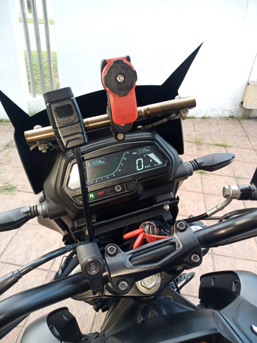

Windbro Touring windshield (mount to stock location with no additional brackets) https://shp.ee/34v9pgj
1" Handlebar riser
China Quadlock phone mount, DIY Nav bar for phone mount https://shp.ee/g64356v
Headlight riser mount https://shp.ee/yyctuhi
Givi Pannier and Top racks
Givi Pannier and Top box
Aftermarket folding levers (I removed the end since I wanted folding stubbies) https://shp.ee/ccmys6k
China spot lights https://shp.ee/qk6mybd
Auxiliary fusebox and relay
Vietnam 420g bar ends https://shp.ee/9xrjzu5
Dominar UG crash bars (broke stock ones after multiple drops off road)
Bottle holder and various aux gear bags
USB charger https://shp.ee/da83gm3
* Most Items are DIY
Other things bought but not yet installed
Adjustable bar risers https://shp.ee/7shdbyi
Larger footpegs. Added damping o-rings but still needs minor modification to fit. https://shp.ee/6jp9zn9
Conclusion.
If you didnt get a lemon unit, this is by far the best bang for the buck value bike money can buy now. You cant argue for a sub 15,000rm bike that can do almost everything (but not well). It has proven far more reliable than many have complained about (maybe I'm lucky, or i just ride often). Its not the easiest bike to learn on nor ride slow speeds, but it feels like a proper big bike and would serve as a very good stepping stone to a future big bike.
I'm aware some owners had some shitty luck on lemon units... so your mileage may vary with one of these. The Dominar is not a bike that does everything execptionally well but does things good enough for a general bike. Its not the most balanced, easy to cilok, easy to ride bike, nor it is the most sporting, and certainly not best for off road. But if you just want to get a bike that is a good stepping stone to something more powerful and heavy, I can't think of a better bike for this sort of price.
*I'll post some pictures up later, along with shopee links for the accessories (almost everything is bought from shopee)
This post has been edited by jaycee1: Dec 13 2023, 07:26 PM
Upgrades
1" Handlebar riser
China spot lights
Conclusion.
My D400 since Sept 2019 , last 3 oil change by myself since 2022(Coolant,chain tensioning,filter) , all lighting wirings and accessories DIY. Though only 20k.
A few issues I get after i started riding long distance
1. During heavy rain/thunderstorm , the throttle can't get to maximum and will mush down if you try to pull to max.
2. Sometimes when stop abruptly the engine will die out(once every blue moon).
3. Stuffs will get loose , but I can live with it. just more tightening regime.
Overall I too still satified with my D400 ~

QUOTE(JustForFun @ Jul 23 2025, 08:00 PM)
I have lived a year plus without one, using only a portable side stand.
It's good enough for chain maintenance, only catch is that you have to make sure the surface you work with have enough friction so it doesn't slide.
However, it's more due to circumstances than choice, since I move around a lot and don't have space to store a paddock stand... not to mention a good paddock stand is really expensive.
how much would a good paddock stand cost?
looking for one and saw shoppee selling below 100rm. seeing the price know it wont last
acid_head
post Jul 24 2025, 09:57 AM
809 posts
Joined: Jun 2007
Saw a brand called Proformance. It looks like just a normal paddock, but it is slightly expensive. i can't comment on the user review as everyone has their own acceptance level.
Any brand is good and not so expensive to recommend

QUOTE(acid_head @ Jul 24 2025, 09:57 AM)
Lol I'm using it, so far after 1 year that paddock still working as intended
