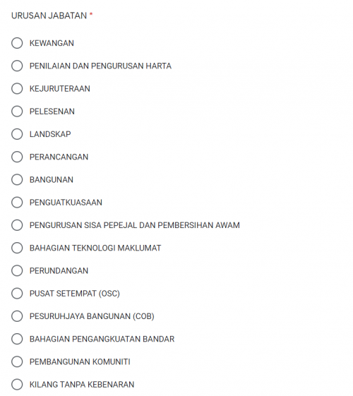

TStaufoo
post Sep 8 2021, 04:02 PM
147 posts
Joined: May 2007
I want to submit an appointment schedule with MBSA but wah lau this form, which option.. hmm
For house renovation.
This post has been edited by taufoo: Sep 8 2021, 04:03 PM
Q.V.RK
post Sep 8 2021, 07:48 PM
77 posts
Joined: Nov 2018
QUOTE(taufoo @ Sep 8 2021, 04:02 PM)
As mentioned in my post, Jabatan Bangunan. Nowadays, will easily take 10 days before you receive any email or call to notify your appointment.
