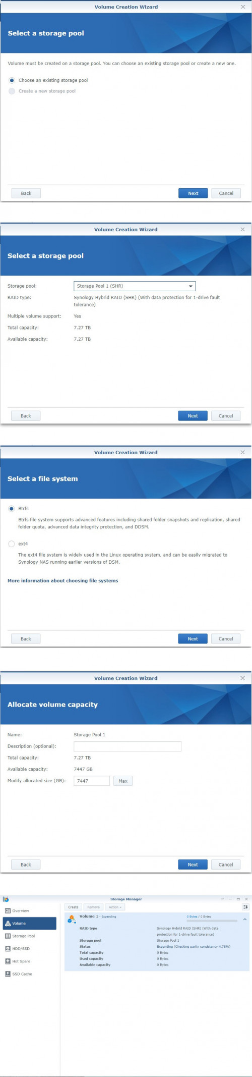

After creating the storage pool, it is time to create volume or volumes. You can have more than 1 volume in your storage pool if you have specific needs. For the file system you can choose either BTRFS or EXT4. During volume creation you can set how many GB you want to allocate for each volume. Since I don't need more than 1 volume so I maximized the size and use BTRFS for the file system since it can do checksum, self-healing, snapshots, and many more.
Finally time to create Folder, this can be accessed from Control Panel > Shared Folder. Here is your management of each Folder. In NAS terms, Folder is something like how Windows sees a drive. Instead of a drive letter, here you put a name for Folder. You can also have a description of it. Can choose to hide any Folder from My Network Places. If you have more than 1 volume, you can choose which volume each Folder is located, whether to use Recycle Bin, encrypt the Folder, set quota, enable checksum, file compression, and self-healing for data integrity, which account can have access to each Folder, and many more. More than enough for home users and still satisfied corporate users.
