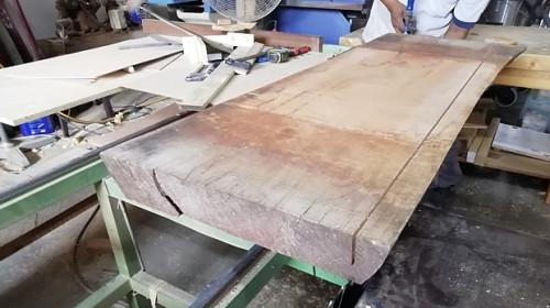

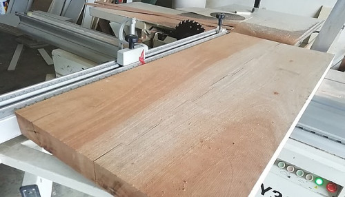

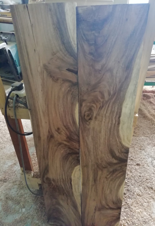

just to share a journey of 4feet slabs from being a part of a sawn off tree log to being a bar table
slabs arrived in rough form and dirty, size around 20inches x 4feet each.
first we clean the slab and start work on levelling them flat on both sides
once its flat, we put it on the table saw
as we want to trim off the sides of the natural edge/life edge as we want to join two pieces to make a wider table of 2x4feet
to be cont.

The slab looks moist. When it dry up, it is warp and crack.
TSar188
post Aug 14 2019, 10:25 AM
9,206 posts
Joined: Jun 2006
QUOTE(lawrencesha @ Aug 14 2019, 10:23 AM)
customer doesnt mind the rustic crack look after a few months. they dont want to wait 2 years. what they can accept as final result and foot the bill, we just do as per their request.

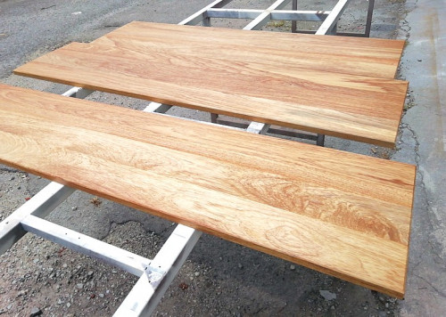

TSar188

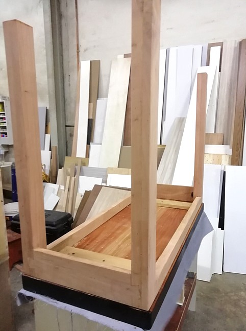

post Aug 14 2019, 08:55 PM
9,206 posts
Joined: Jun 2006

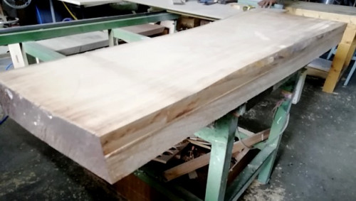

trimming the edges of the slab to final dimension
updated, pic in process of fixing leg to base with 6 allen bolts and also sanding them smooth
This post has been edited by ar188: Aug 20 2019, 10:22 PM

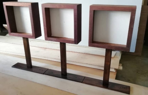

other projects

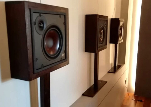

home theater speaker frame for tight spaces behind acoustic transparent screen.
This post has been edited by ar188: Aug 20 2019, 10:46 PM

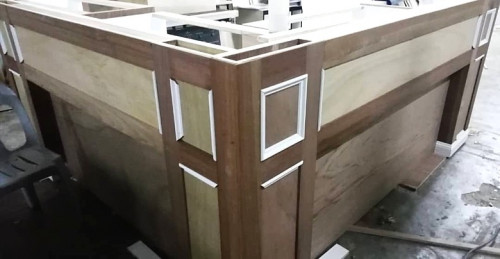

building a solid wood counter top and spray white. for boutique

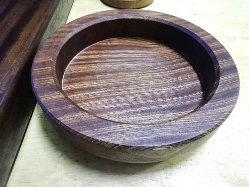

Joined: Jun 2006
bowl using ribbon stripped sapele (african mahagony) and special finishing to get that 3d hologram effect.

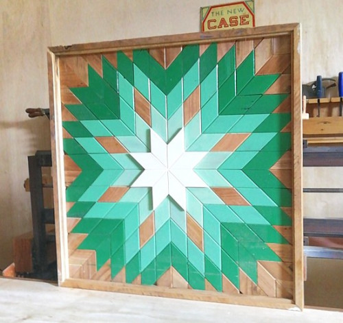

Joined: Jun 2006
wall art series

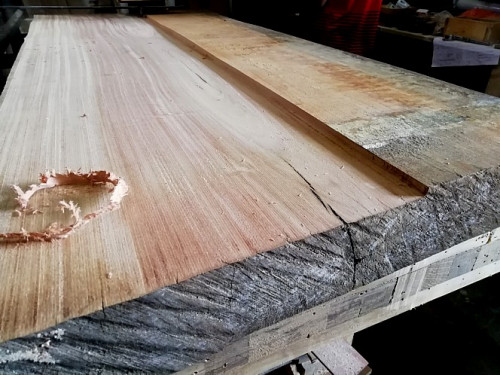

biggrin.gif thanks

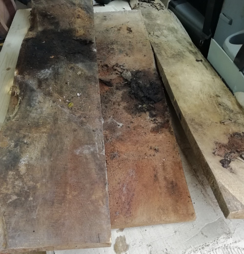

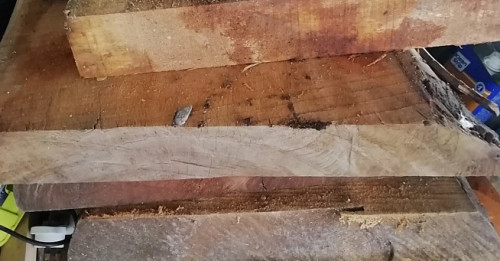

there were 5-6planks burried on some compost waste, hence the black dirt on the wood.- first pic.
actually i collected the bottom pic, 2pcs first, cos i suspect something nice underneath the dirt, and sure enough after planed.. they look so good.
went back to collect the rest few days ago. dirty also nevermind, scrape the loose dirt and throw in car first biggrin.gif
going to plane the rest of boards and see how they look. will update later.
This post has been edited by ar188: Aug 21 2019, 11:38 AM
